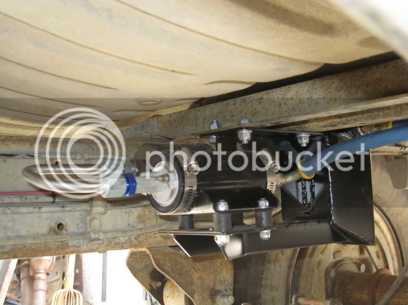

Where I mounted mine:

Looks and sounds like the same place I have mine y'all have the filter before or after the pump ???
Get a inline walbro 255 and put the filter between the fuel rail(motor) and the pump and never look back. I have been working on and modding these motors since they came out in the late 90s and I haven't seen many msd pumps do good.
