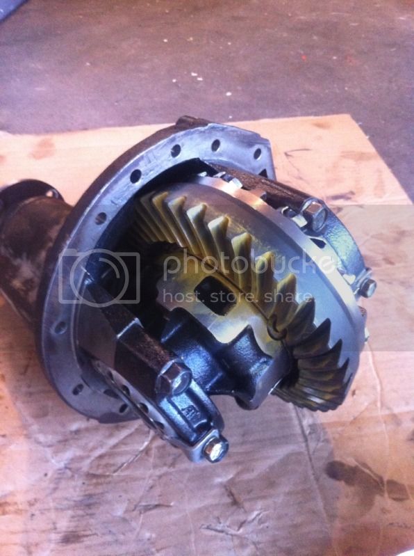

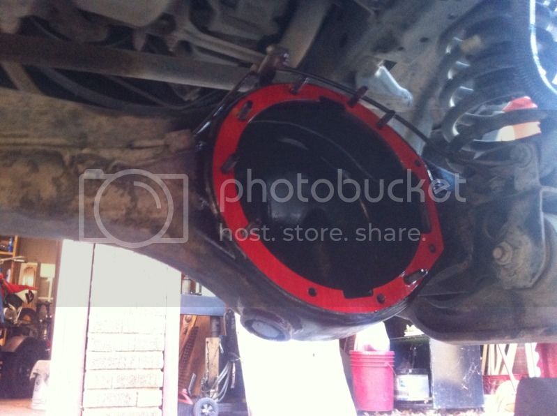

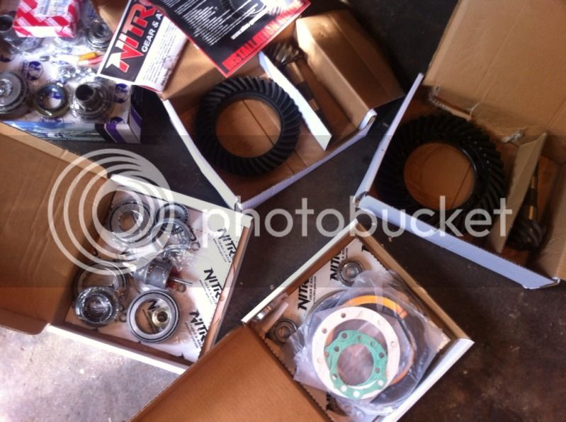

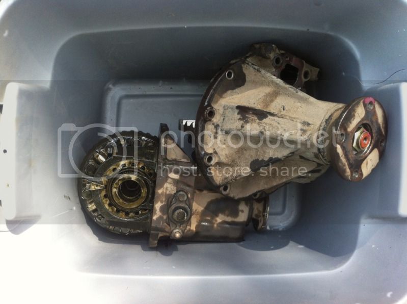

Well, 6 weeks ago I was asking questions about 5.29's and now I've got em. Love em. Big project, as most of you know that have done them; the $$$ really adds up as well. I was showing 65mph (GPS) at 2500 rpm and 68-ish at 2600. Best of all though, I got my crawl back :). Yellow Box next I think.
A few pics.
