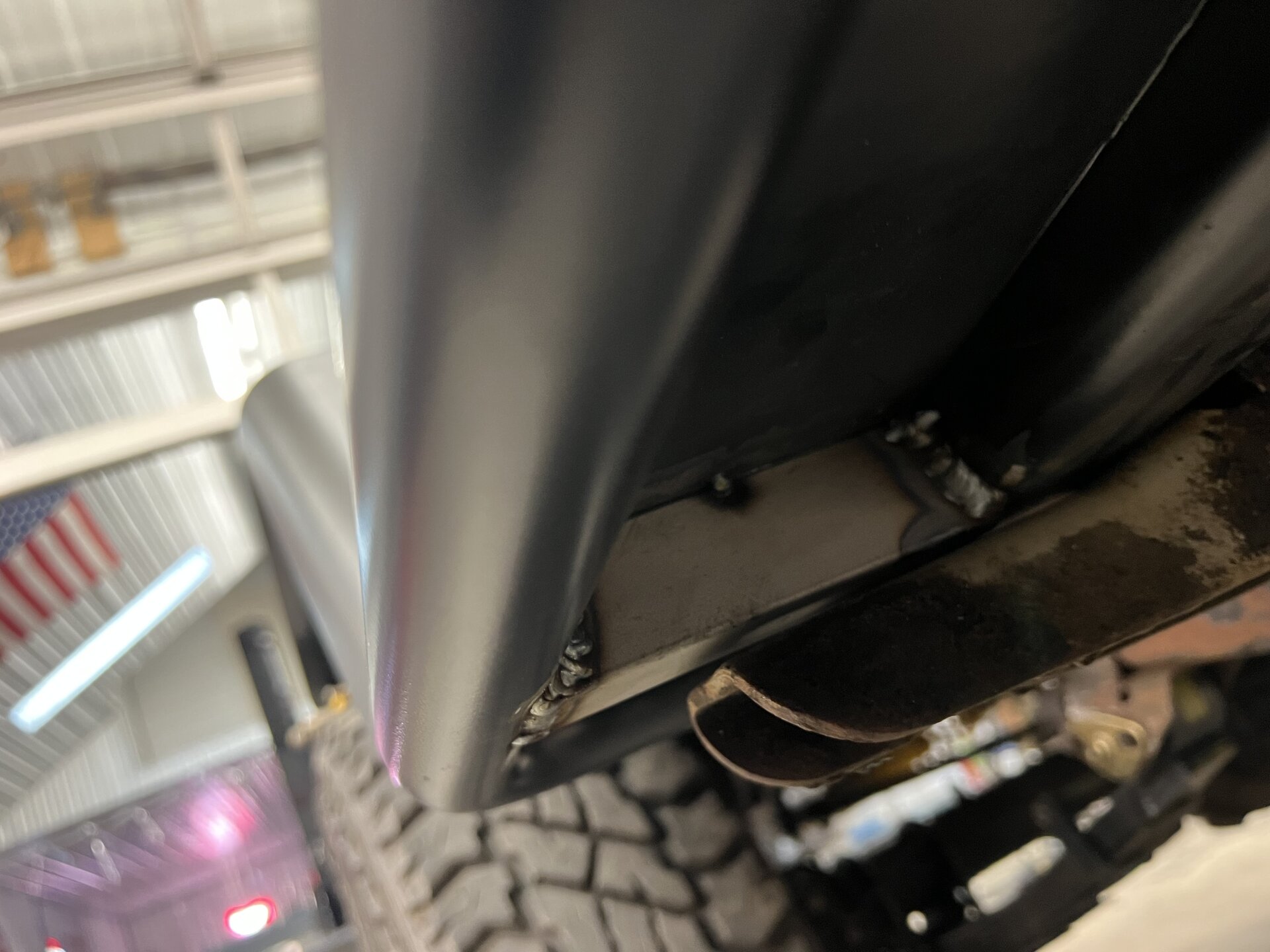

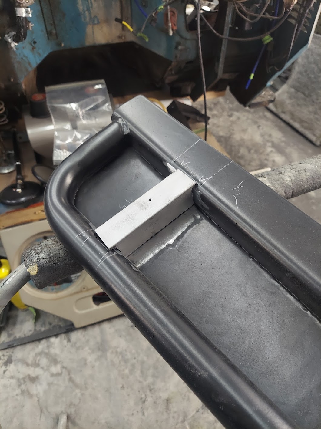

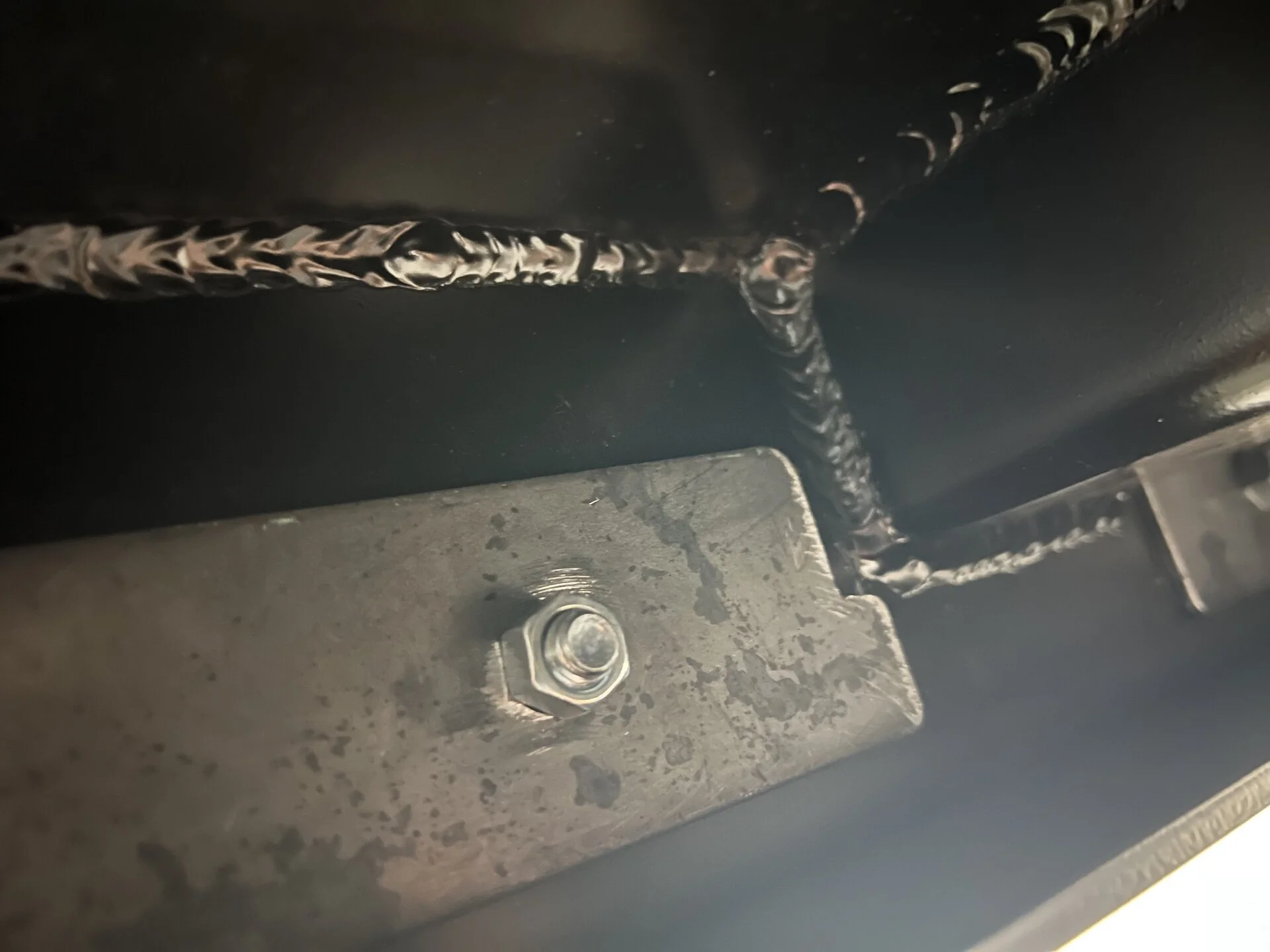

Modified the step and tied into the outrigger. Mounting to an Aq tub so the concern was how to relieve stress on the rocker. Also, installed a backing plate. I was just curious about your COA.

Alex @ RCLC did the fab work to tie that step in. Even with a backing plate there is some stress on the rocker.
