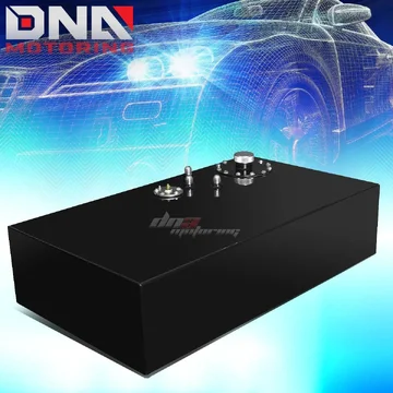

Something like this would very easily drop in with a few fabricated hangers. The trick is figuring out all the plumbing, but those are all easy generic parts. The only bespoke parts may be the fuel filler/neck, which hopefully can be an adaptation or modification of the current filler neck.

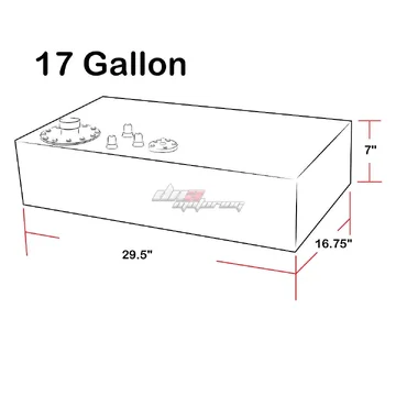

Heck, even this mustang 16 gallon tank or mustang 20 gallon tank would drop right into the space, with dimensions of 32-5/8" x 24-1/2" x 8" or 32-5/8 X 24-1/2 X 9 inches respectively. That's both smaller than spare itself.
Doesn't have enough fittings as it, but that's cake to add with a drill and compression fittings.
24 gallons + 20 gallon aux would make well over 500 mile range.
Buy one and let us know how it goes. I'm sure nothing could go wrong with a $70 ebay gas tank
... that's designed to meet 1964-1969 safety standards :confused:
Yeah ... what could possibly go wrong :bang:
