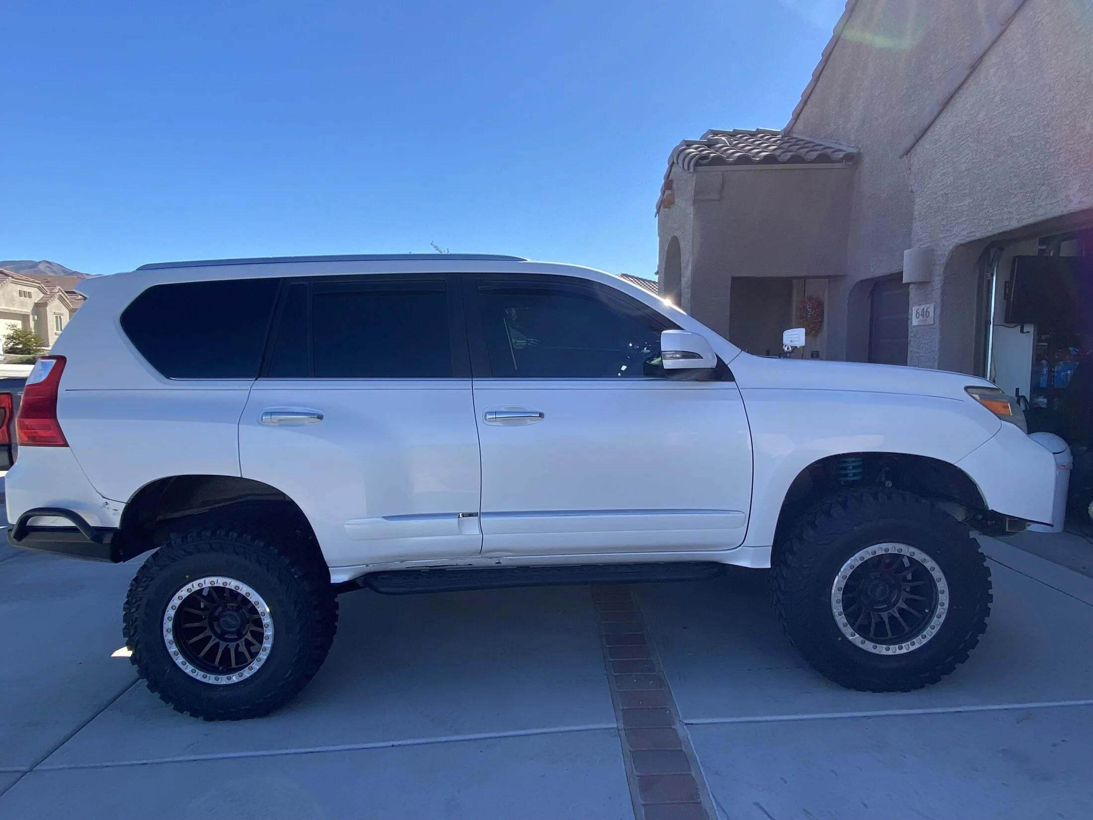

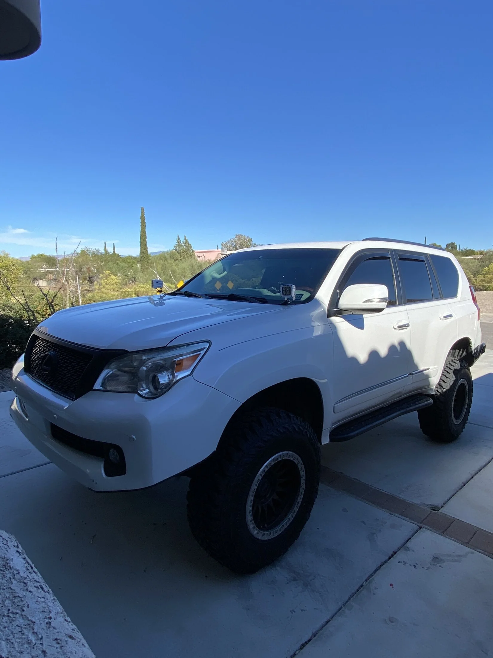

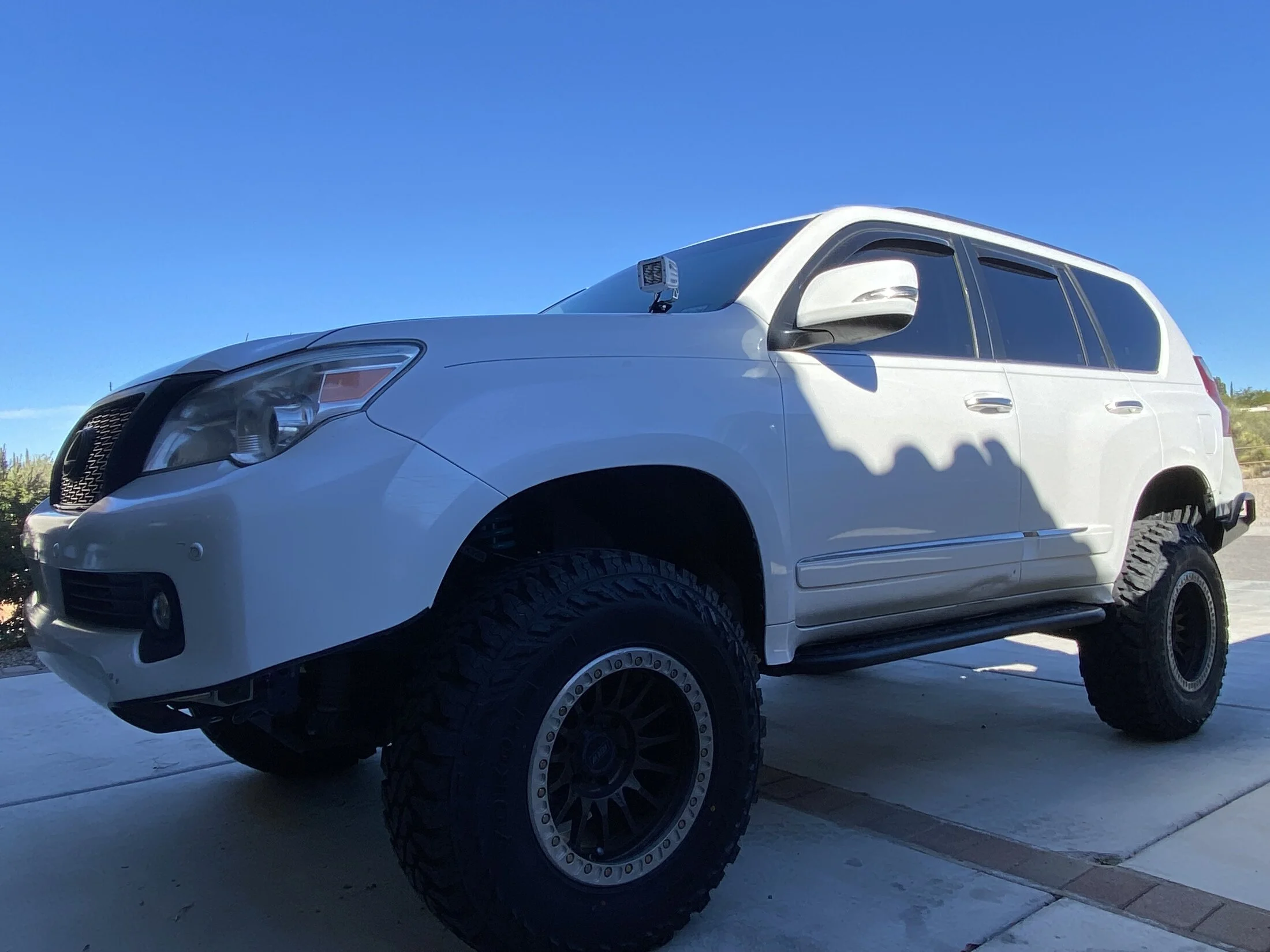

Can you post a couple of photos down the side of your rig to see how flush (or not) your tires are to the fenders?

Recently put Kumho Geolander MT 285/75R17 on my GX. Comes out to about a 34” tire, up from 33’s.
