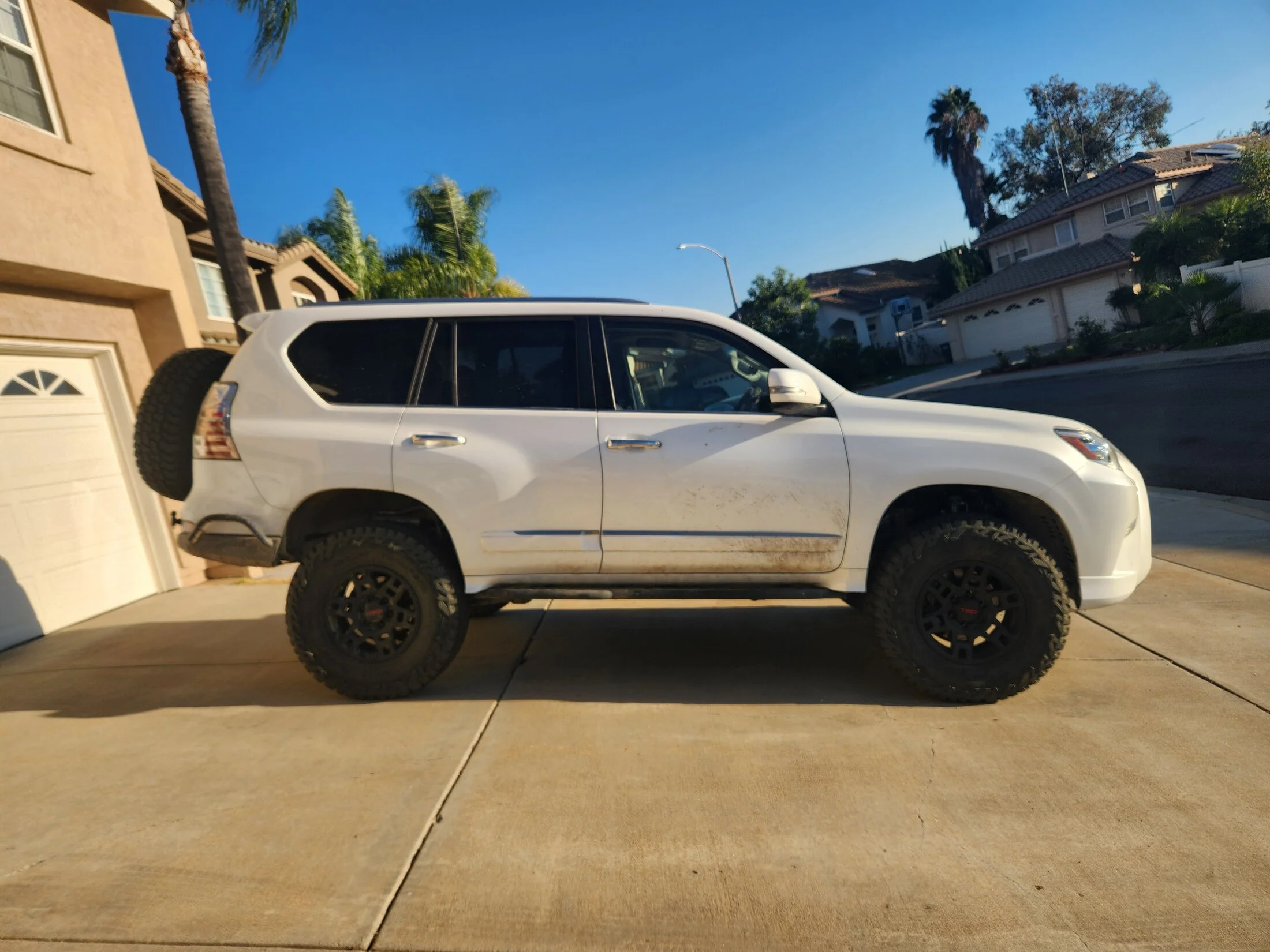

Quick pic on the 255/85s after sorting coilover settings today.
Looks great
Now that ive adjusted coilovers and redone alignment, literally zero rubbing.
When you had the alignment done, did you have them push the caster forward? One of the little tricks to help with rubbing.
Yep, Total Chaos UCAs + taken into account in the alignment. The shop that installed the suspension and did alignment originally did some very wonky stuff... Took it to a Jeep-centric shop closer to my house and they knocked it out of the park.
