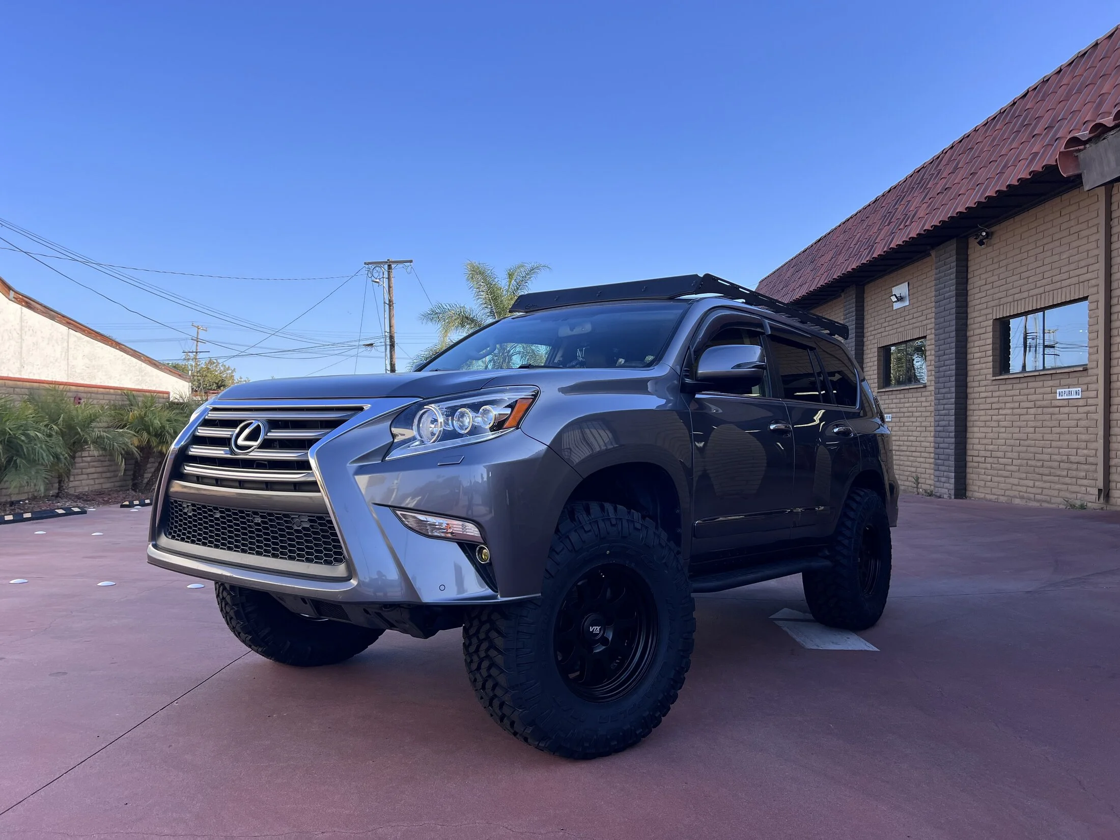

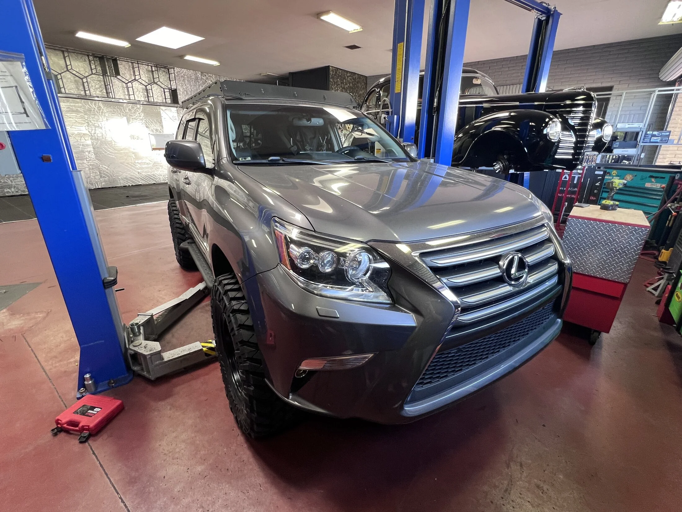

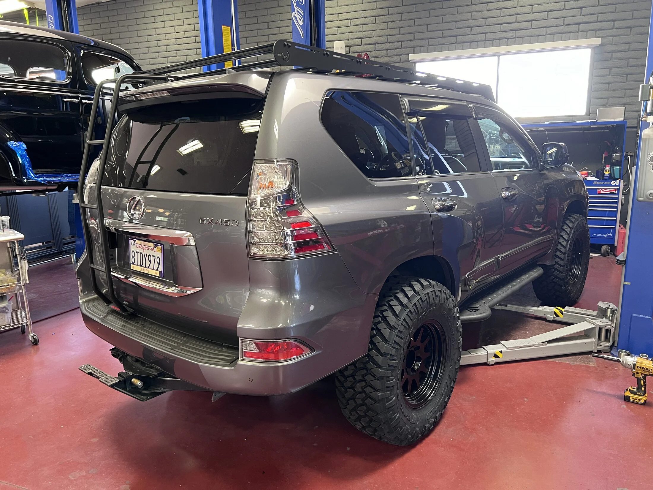

Here we go. 35x12.50R17 Nitto Trail Grappler MT’s are on 17x9 VTX Stinger SL wheels -25 offset. Suspension is Dobinsons monotube 2.5” lift with Dobinsons upper control arms. Dr. KDSS sway mount angle correction and rear drop spacer. Have BMC done.

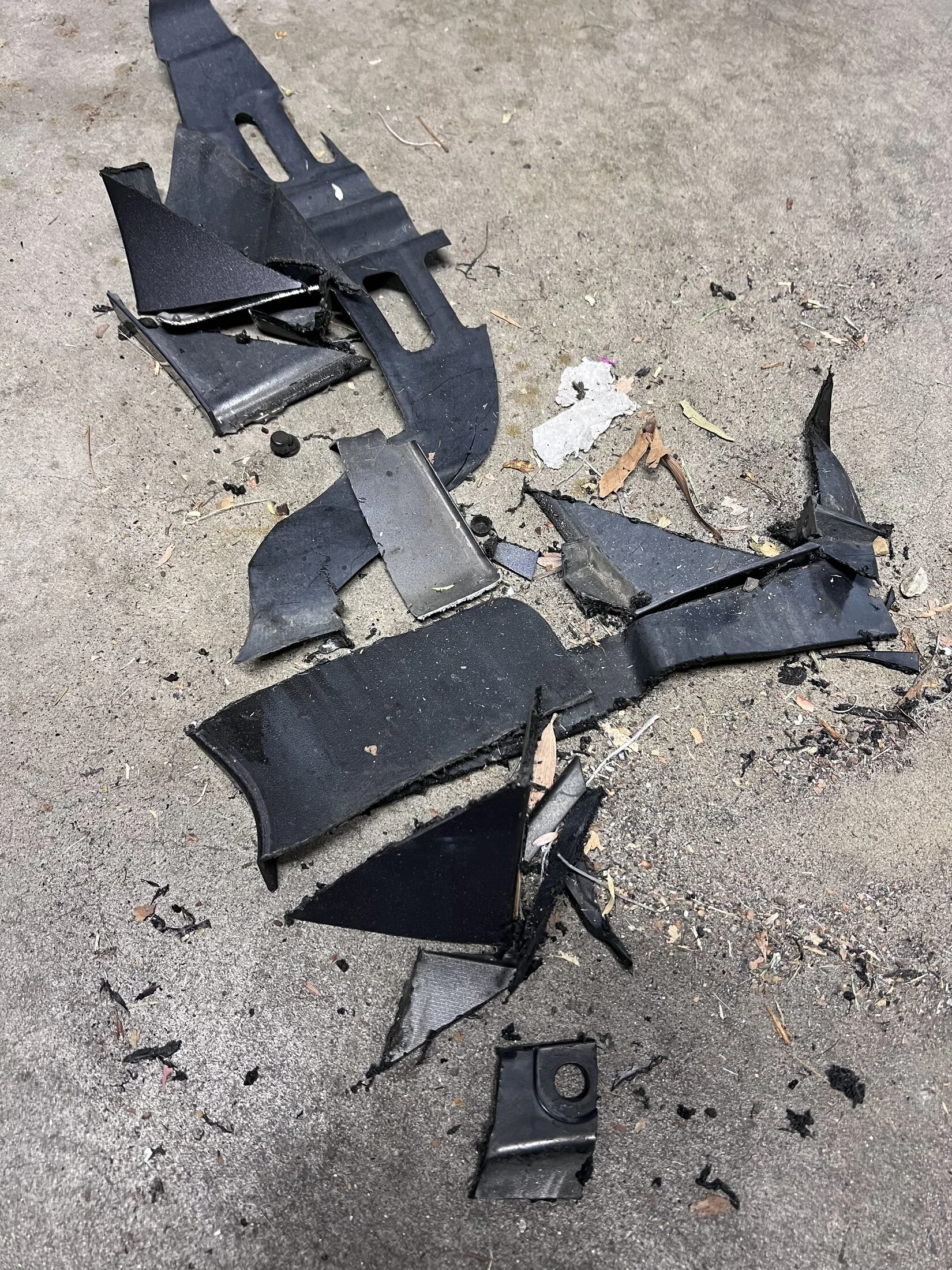

Felt like a plastic surgeon on all four corners. Still rubbing on wheel well liner in the front. Still gotta chop or massage some more. So far not rubbing on BMC or washer fluid reservoir tank, but haven’t tested full compression yet. Just on steep driveway.

Welcome to the club!
Another one on 35's! 👍
If you're still getting rubbing, get a castor forward alignment. It'll either get rid of the rubbing or make it much less.

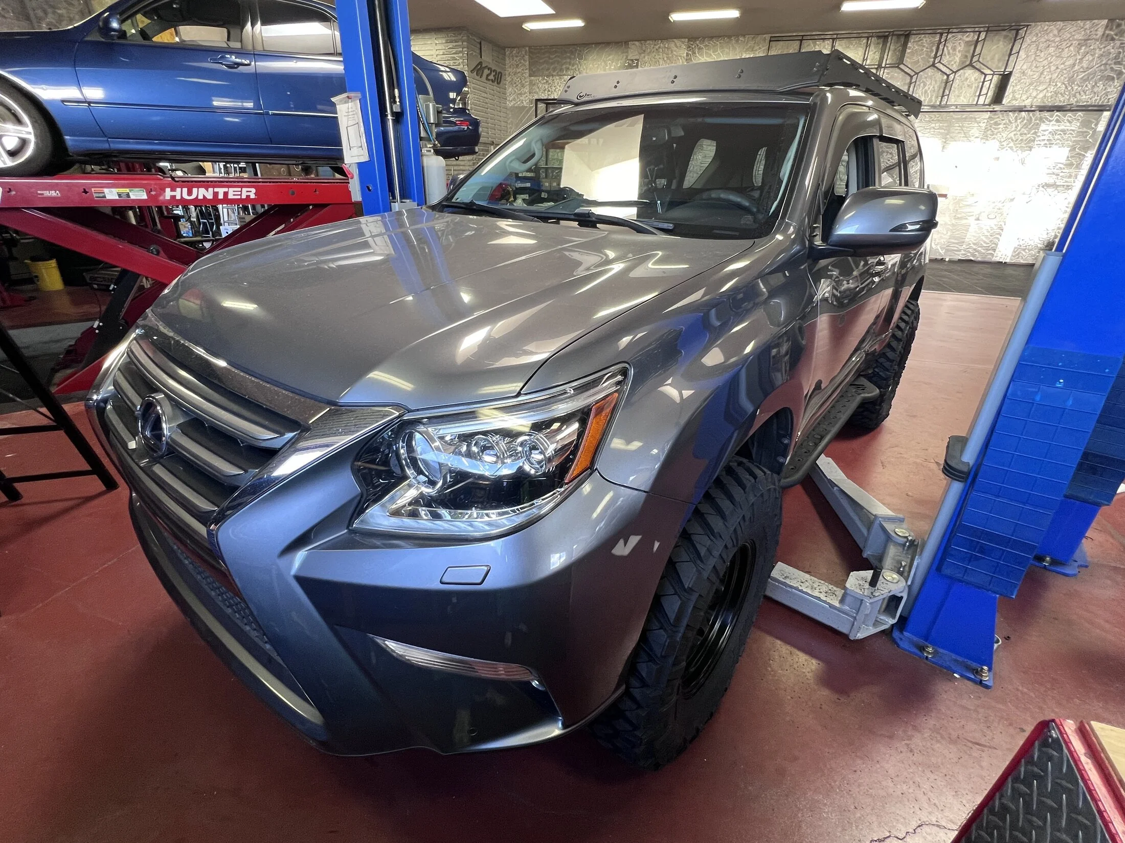

35’s feel great. I’m running 4* castor, 0 camber, 0 toe. Stock psi at 32 psi. Feels like I’m riding on clouds. Road noise is only marginally louder than all terrains. Though it does get much louder on highway speeds. There is plenty of power and don’t feel the need to re-gear. 4.88 would improve acceleration but doesn’t feel necessary.
no rubbing lock to lo lock on steep driveway. Still have yet to test during full compression on a trail.
Due to the weight on each corner, rig feels much more planted on the road. This is not my daily car. I would not recommend 35s on a daily.
