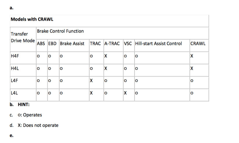

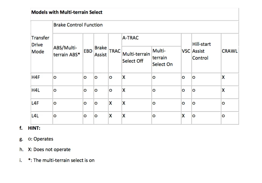

A fellow CL member brings up a good point about when ATRAC is enabled on a MTS equipped 460. Many here who have these mods have pushed their vehicle to limits I will likely never do so curious as to your observations of MTS/Crawl and if you notice ATRAC wasn't engaged in just 4L with no crawl or MTS activated....or if no ATRAC in Crawl if MTS wasn't enabled. They also added a AUTO MTS feature to 2020 along with a Rock and Dirt mode. Some indication MTS is even more dynamic with 2020 implementation.
• You can enable MTS before going into Crawl but not the other way around.
The FSM seems to indicate a Crawl Only 460 will have enabled ATRAC in 4L like a standard DAC enabled model would but the grid seems to indicate if you have MTS install that ATRAC is only enabled by being in a MTS mode prior to turning on Crawl.

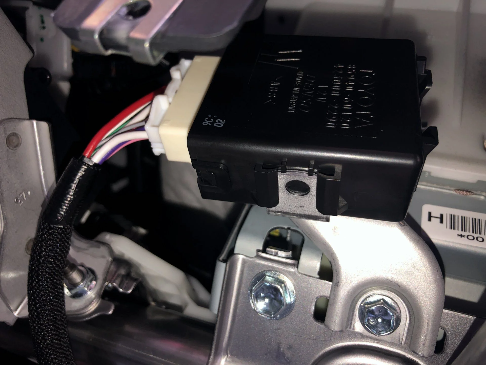

so tried the mod today on my 2020 premium, but couldn't find the computer location can you help.
I found 85940-60120 on the left side of the 4wheel computer:oops:

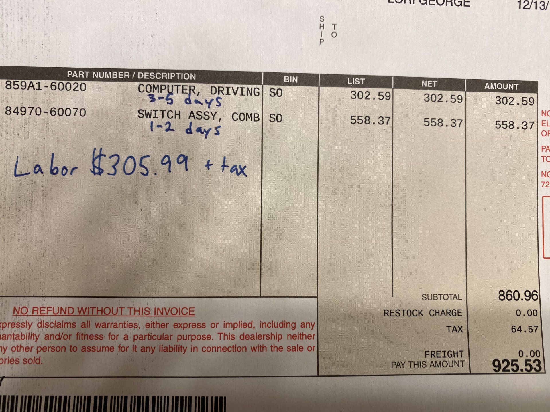

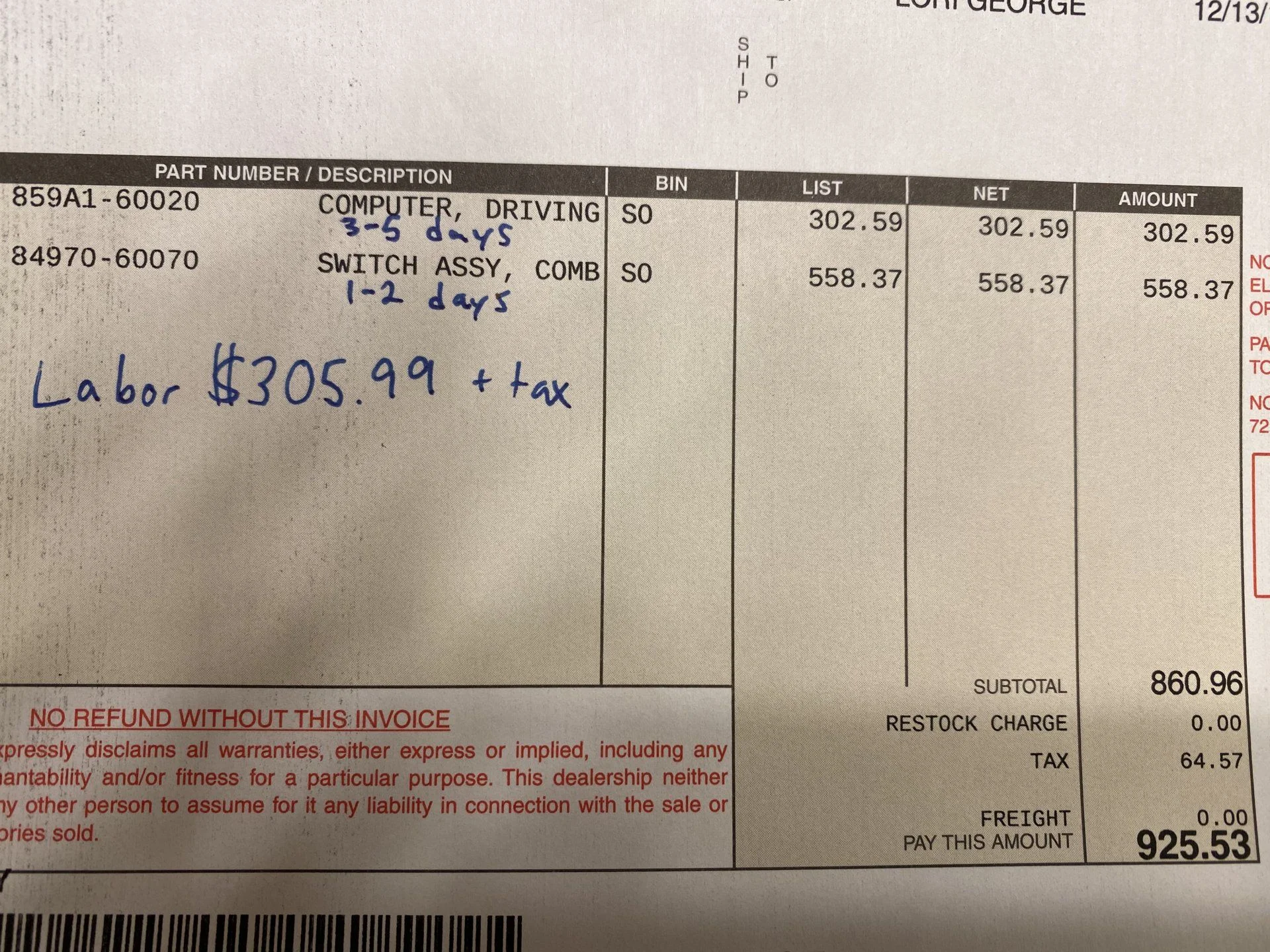

Here is an estimate I got from my Lexus dealer to install the crawl control.
I was in for the Service Campaign recall free service and was going to get it installed until they dropped the $1200 estimate on me.
I told them this was an option for the 2011 GX but was a special order option. I told them the computer was already in there and I wanted the switch installed in place of the DAC switch. I assumed they new what parts they needed and they gave me an estimate of $1200. They didn’t have any parts in stock but said they could order them and have them in a few days (see the hand written notes). Based on some of the posts on MUD, I thought the computer was already in the vehicle but it doesn’t sound like it based on the part needed on the work order. They were more than willing to install.
