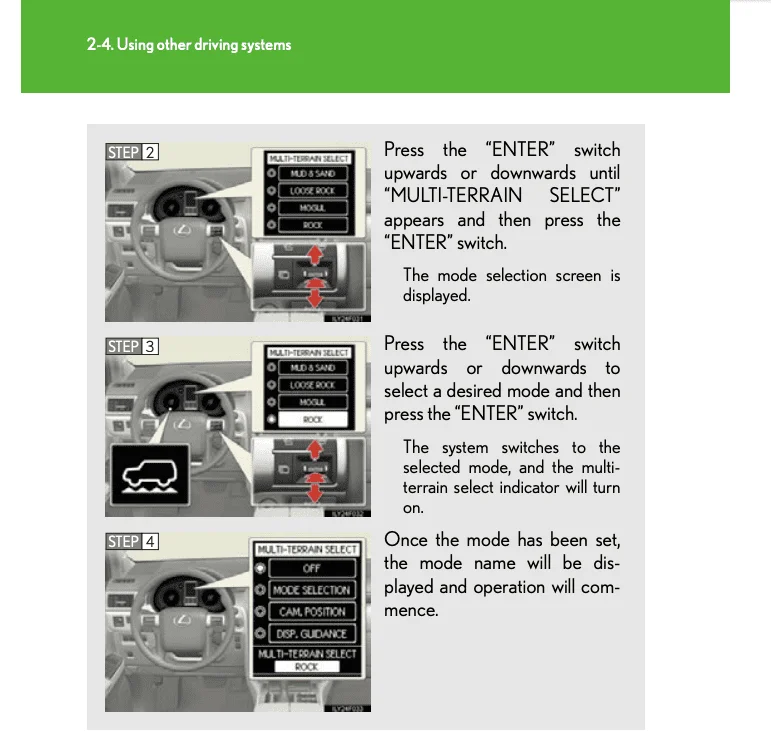

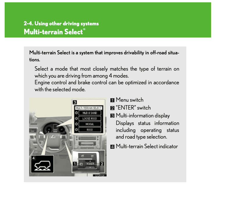

Any updates on compatibility with the 2020's? I'm very interested in adding MTS to mine. How is MTS selected? With my 2019 4Runner I had a dial that I used once I was in 4WD. How are the different modes selected with the GX without the dial?
Unfortunately ...for '20 I haven't heard from anyone willing to look into TIS wiring diagrams or donate a temp TIS subscription to me. I'd be willing to go in and look for the '20 owners. No public/free wiring diagrams are currently available. It may take 6-8 more months before general data starts to show up.

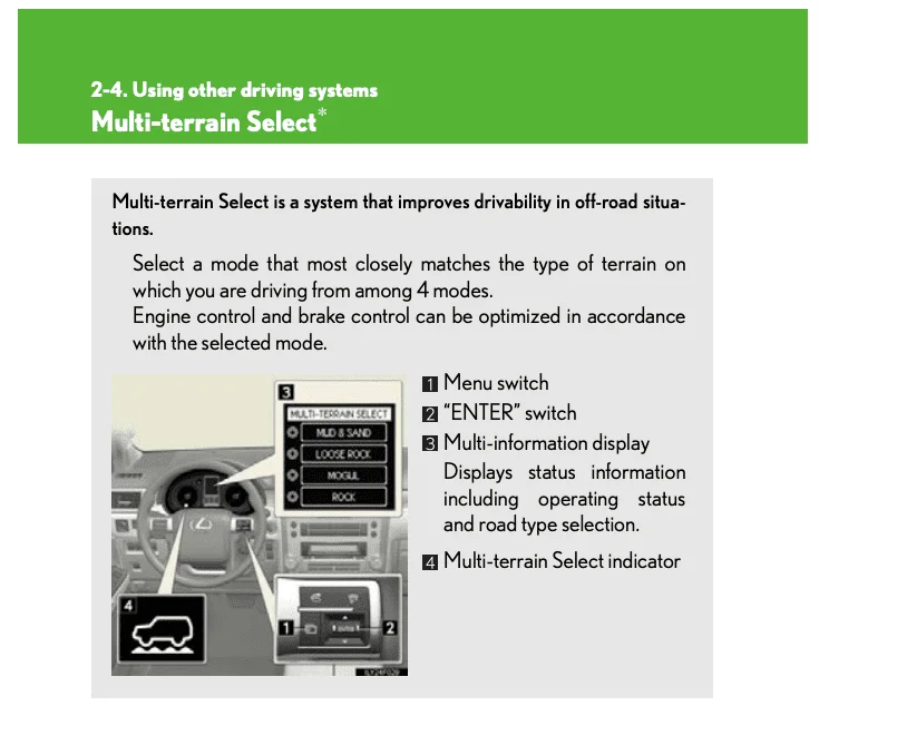

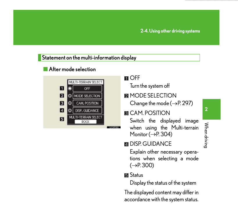

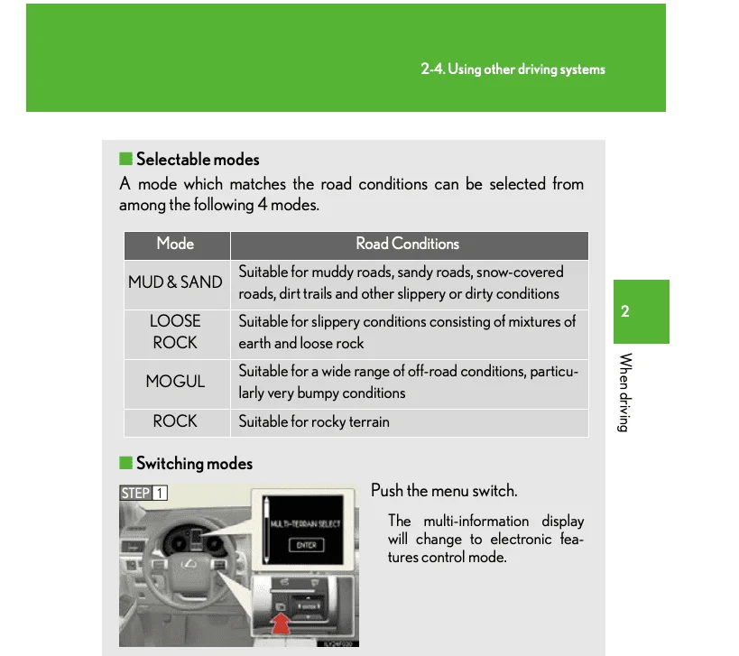

MTS is enabled with right steering wheel button on 10-19 models.

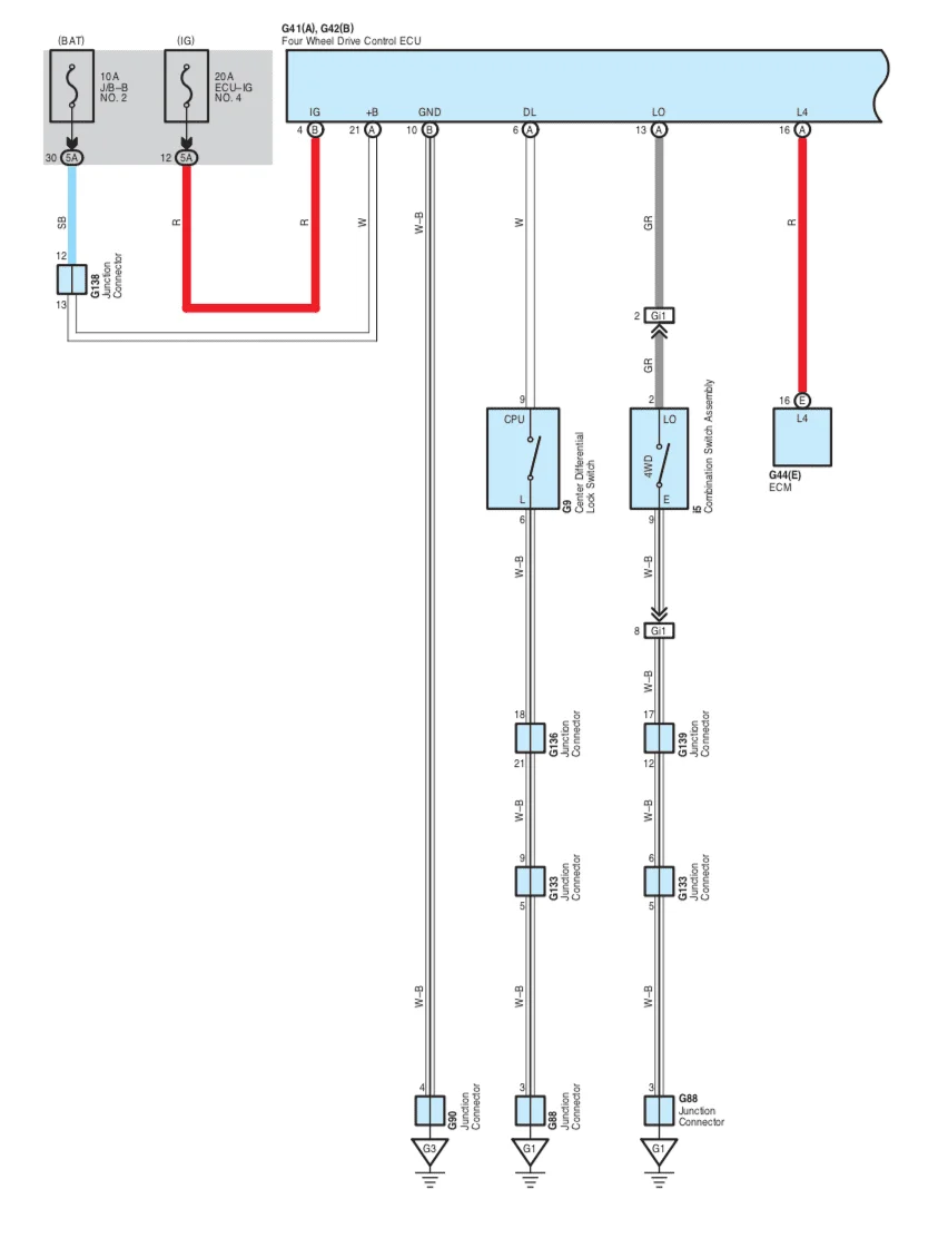

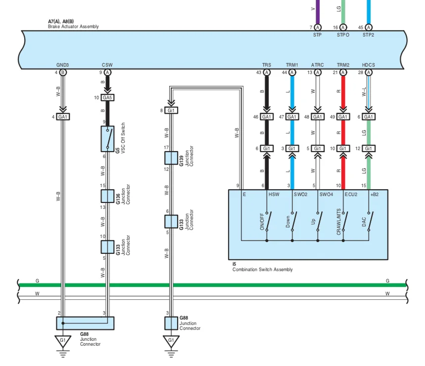

For 2020 too early to tell but looks like Crawl/DAC Switch simply goes straight to the skid control ECU.
This could go a few different ways or other unknowns...
Maybe a simple crawl switch replacement with ZPC gets you both Crawl and MTS? If not MTS is brought about with something else?
Or a more expensive requirement this go around '20+ of also a new Skid Control ECU which is around $1k or more?
Thoughts on next steps? Looks like you don't need the TIS subscription? Is the next step the install a CC switch for a 2020 and see what happens?
I could still use a TIS subscription. This was just some limited info. I haven't see a diagram where the 4L/4H attaches to. It is not shown attaching to the 4WD ECU in diagram I have access to. Much like the risk I took throwing a switch in mine... someone w/2020 may need to take the risky leap as well.

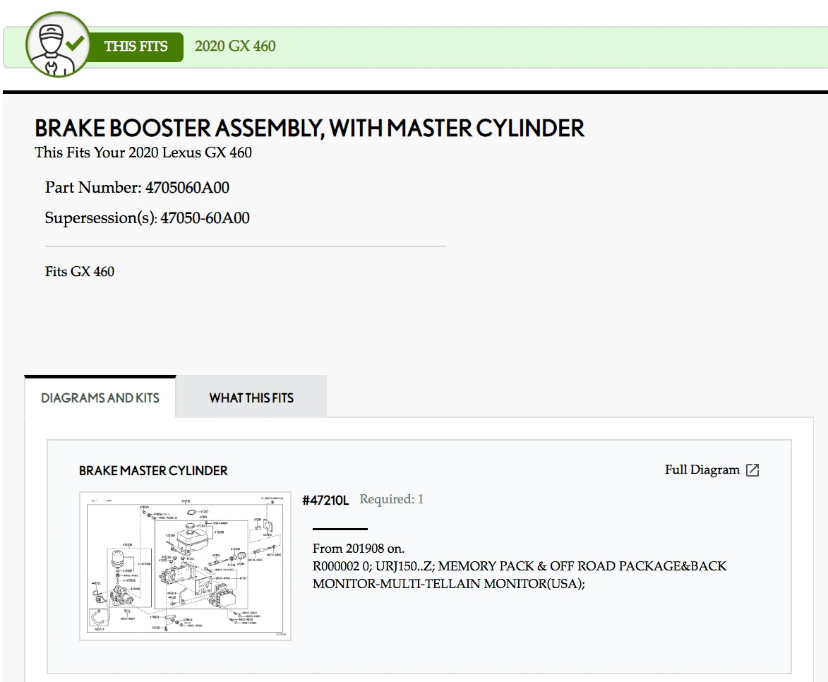

Just a thought....my local dealer is searching inventory for a 2020 Luxury model with the off-road package. Once I have the vin#, order the CC switch and see what happens? Foolish?

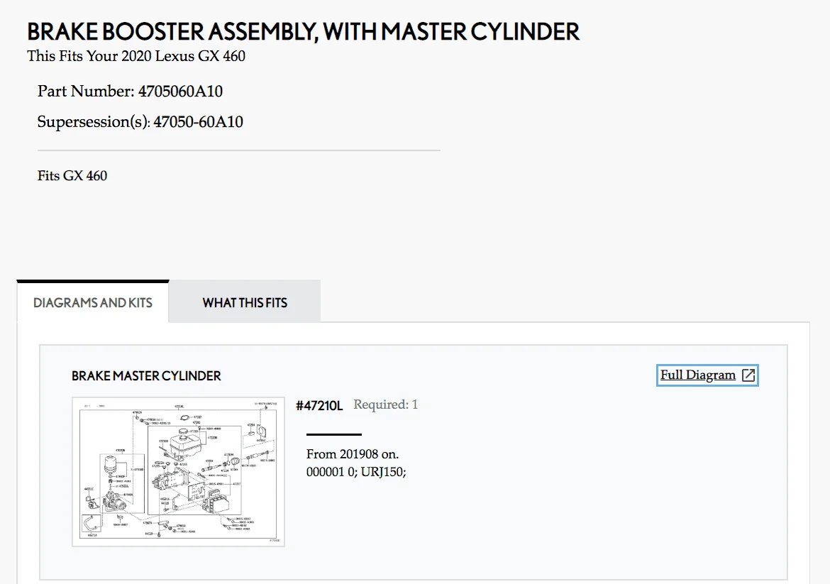

So I received the VIN# of a 2020 Luxury trim level with off-road package, but OEMVEHICLEPARTS.com did not recognize it, and doesn't have any parts listing for 2020 GX460's. :hmm:

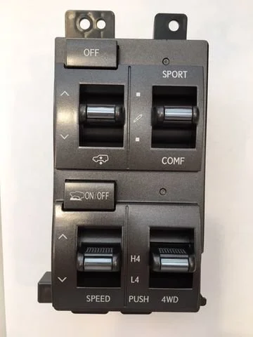

Matt@OEM states that 84970-60450 is indeed the new version of crawl control switch. Only two in North America right now and both would need to be obtained from Canada.
I'm not sure we will be able to absolutely confirm this will enable Crawl and MTS through wiring diagrams alone. This will likely require someone trying it out with fingers crossed.
One could also in theory test out along the same lines as budget crawl but perform steps using the connector and jumpers currently attached to the DAC switch

Just received the quote for the 2020 switch, roughly $400 shipped. Is the thought that both CC and MTS come from the switch and an extra module isn't needed?
Just speculation... at this point not seeing where else the MTS logic would come from. Hopefully not buried in the BCM. Let me see if I can find out more on Crawl and MTS diagnostics in 2020 FSM and see if it all leads back to Skid Control ECU. ZPC is the same as 10-19 except wire method via OBD isn't mentioned.
EDIT: Crawl Control Troubleshooting only deals with Brake Ecu and Combo Switch (then harness repair or meter repair)
MTS troubleshooting is all CAN system
DAC Check CAN, then check combo switch, Then brake ecu master.

I hate to ask....but can you put your edit in simpler terms? I'm trying to learn as fast as I can.
Sorry... this was info passed onto me. It appears that in FSM troubleshooting the Crawl/DAC only mentions skid control ECU, switch, harness or gauge. MTS troubleshooting just mentions CANbus. I wanted to see if there were any other ECU's mentioned for crawl troubleshooting and it appears there are none.
At this point I'm not sure there is much more we can pull for definite confirmation other than a real world test with fingers crossed. A test install with an actual crawl switch or someone can try temporary switches with the existing harness connected to existing console switch like what was done with budget crawl thread on CL.
Wish we had some pics of the underside of console switch and the unplugged connector.
