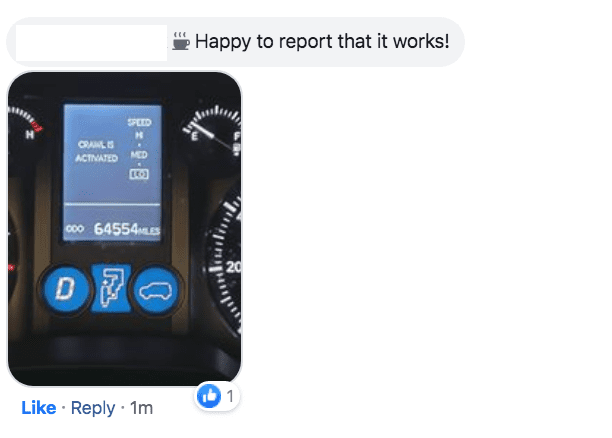

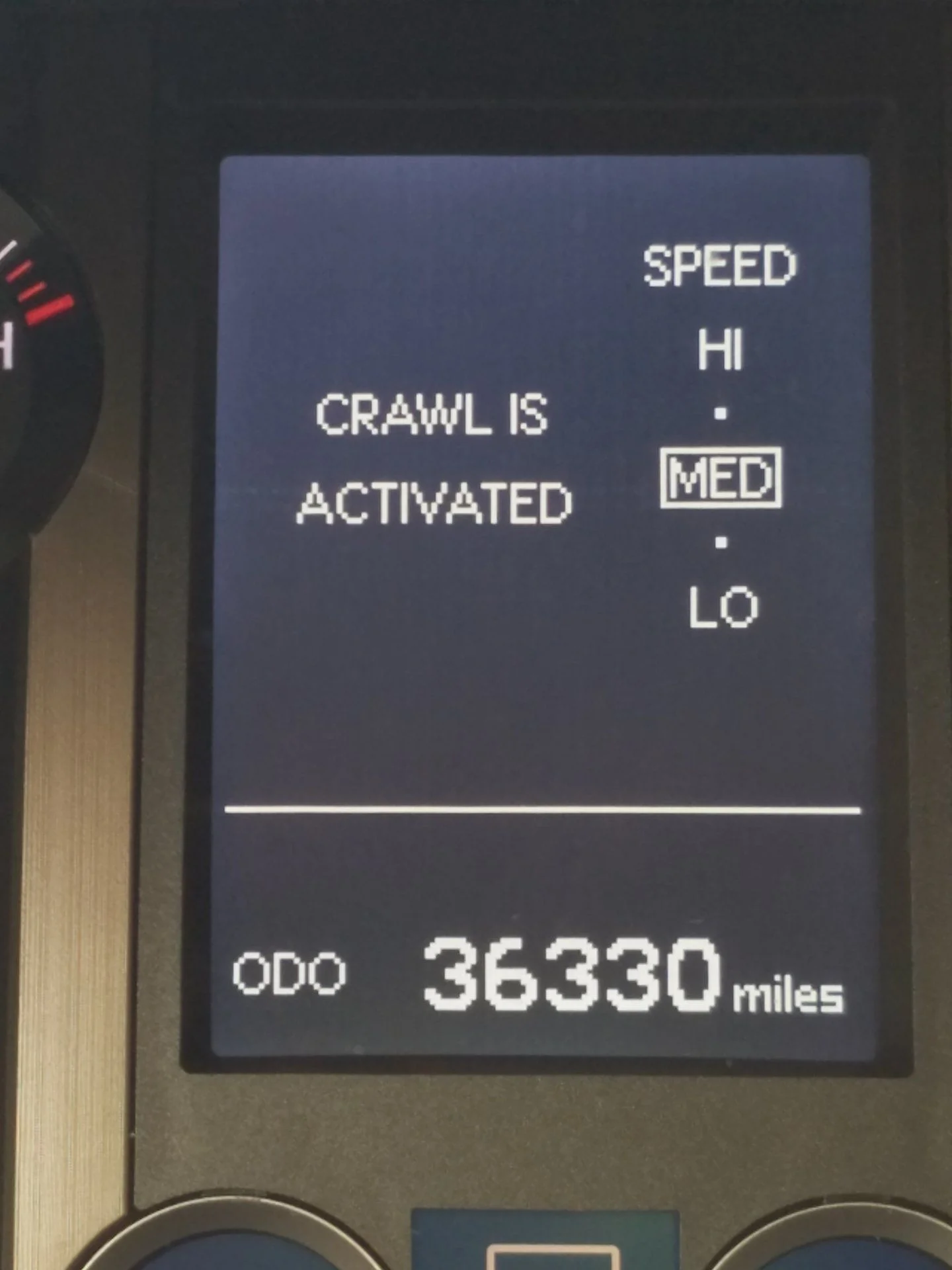

Place vehicle in 4L and press the ON/OFF button above the SPEED toggle. You can still brake and when you release it will keep going. Pressing ON/OFF again cancels. Or stopping and going to 4H

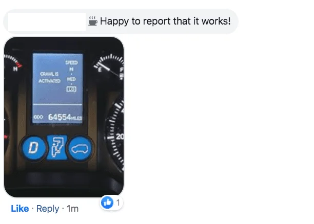

So is the crawl control turned on in the main computer and then speed operated via the toggle in the console?
It should work just like on your LX 570 and TRD PRo. On/Off through console switch and then adjust speed with toggle.

I am happy to report that
A. Crawl Control can be successfully added to a 2016 base model, &
B. It has been added successfully to my 2016 (as well as the Multi Terrain)
It was updated using techstream, and I can't emphasize enough how important it is to "Have it in 4-low, park, and to hit the crawl on off switch before clicking the final exit on the ABS test"...It will NOT work otherwise.
The techs I took it too were stumped until I showed them the post on this forum, as this is brand new install, the computer "handshake" is vital as opposed to a vehicle that already had this installed and just needed a "Calibration".
