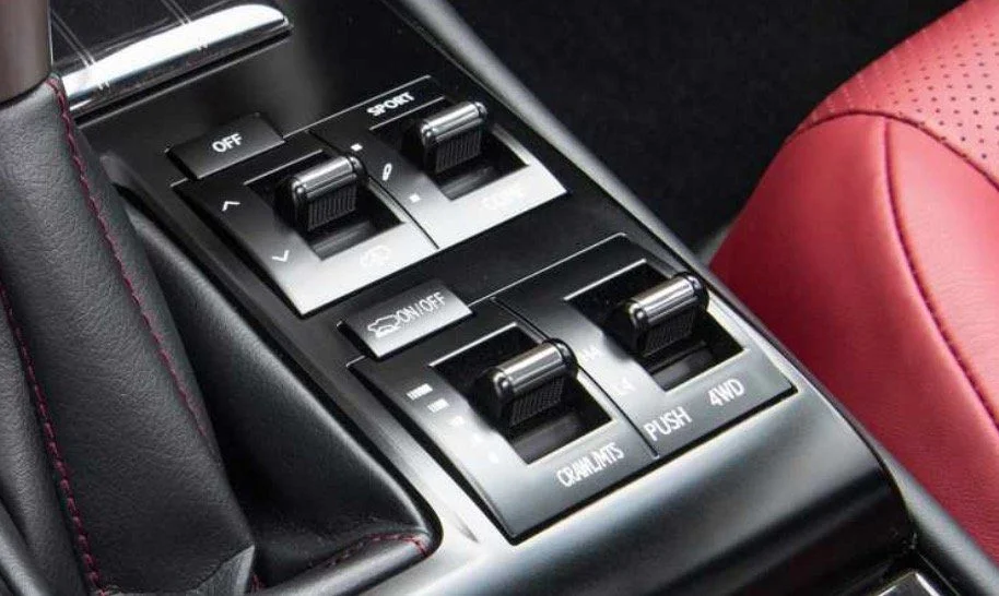

2020 crawl switch which integrates MTS. Poster with an LX 570 on CL mentioned if this works like that rig 4H MTS Mud/Sand mode may be limited to 4L only on the '20s. If one wants to add just MTS to a non-off-road package '20 they may have to purchase the crawl switch as well. Time will tell until someone mods one later this year.

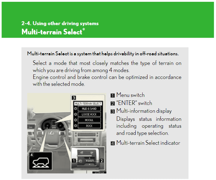

So I want to add MTS to my 2015. My only confusion is how do I toggle the modes? I know you need the switch for crawl but how is the MTS accessed?

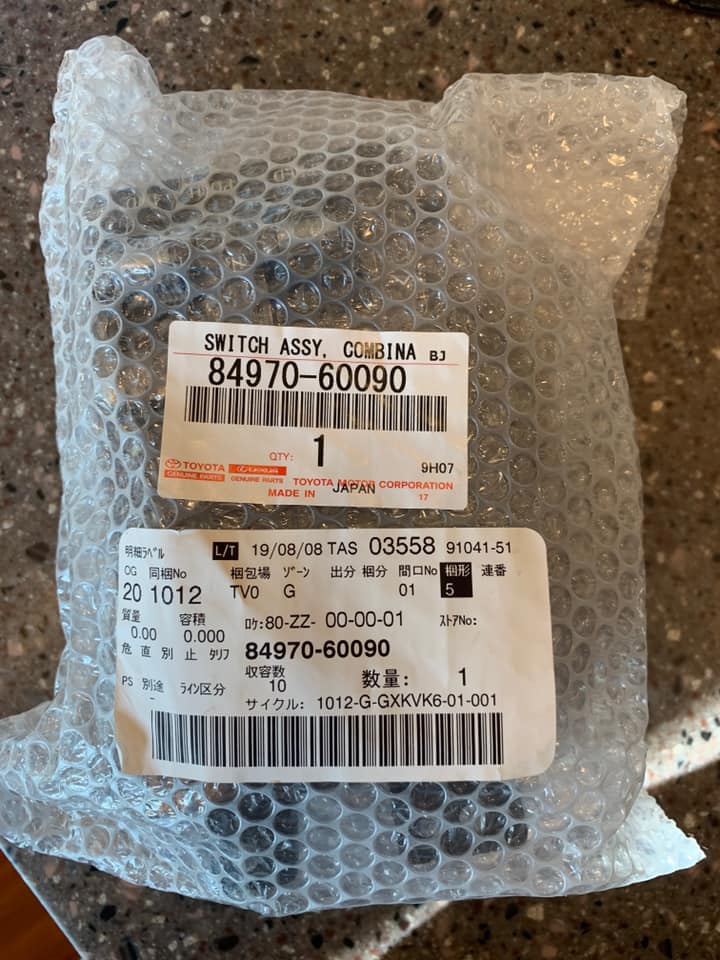

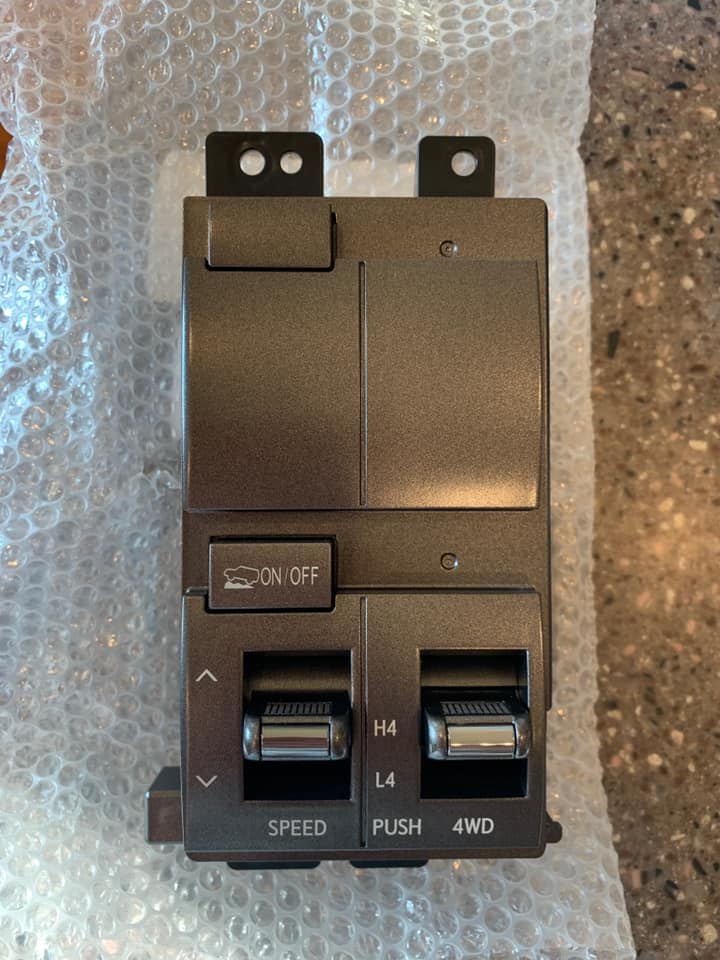

This hasn't been installed and tested yet but looks like the 090 is that unicorn Crawl switch for non-AVS/RAHC models. Here are a few pictures kindly shared by GXOR member who purchased the switch. No confirmed installs yet but really no reason to believe this won't retrofit like the 070. We do not have a confirmed install yet though.

If you just want to do the Multi Terrain switch, all you need to do is purchase the ~$100 switch, pull off some panels that are only clipped in, plug in the module and from I understand, you're done! Just start your vehicle and use the thumb control on the right spoke of the steering wheel and you should see it. It should be listed along with AFS (on/off) and Parking Assist (on/off).
