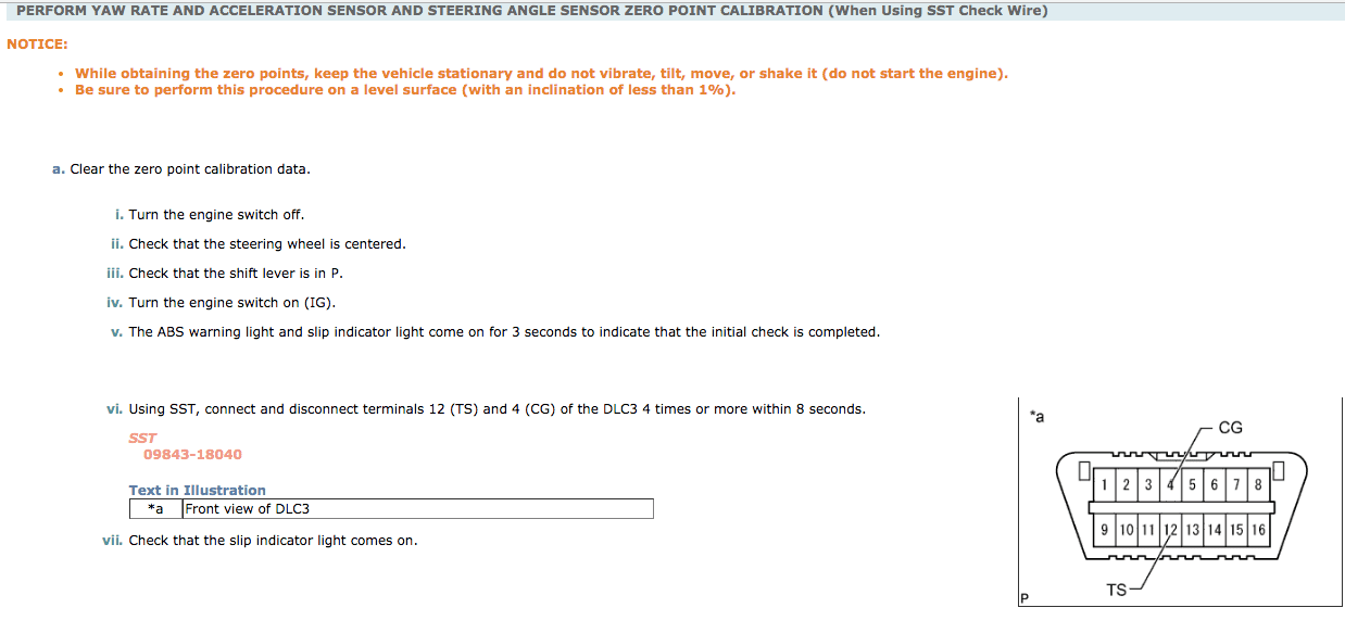

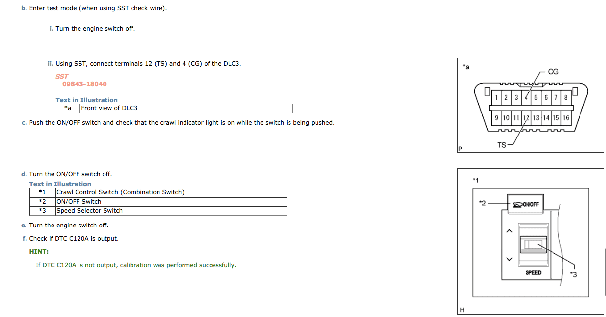

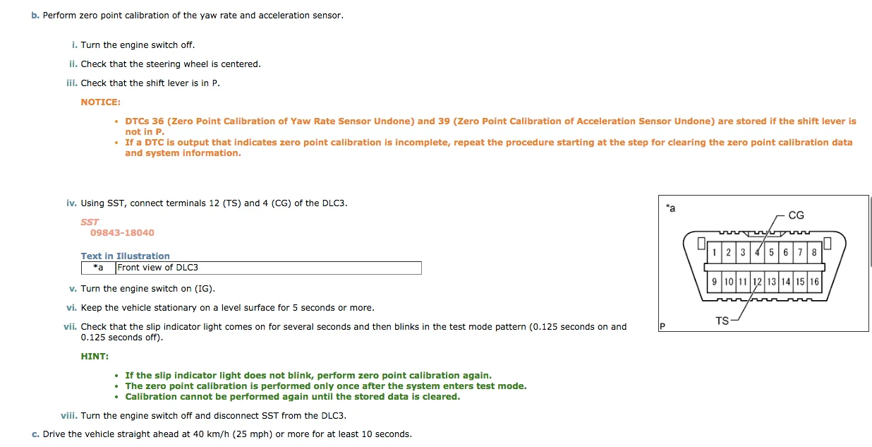

Anyone hear from the guys at OEMvehicle parts lately? Ordered the MTS box almost a month ago and they haven't replied to email or phone calls.
Installed both, got MTS to work but not CC. paid a guy tech stream to do the zero point. Any ideas?
Thanks!
Did he say what part of process failed?
Calibration guide is here
A common failure point is forgetting to hit the Crawl ON/OFF button at the end of Zero Point before exiting process in TS. This lets vehicle know it is equipped with crawl.
Didn't say anything failed, but I'd bet he didn't hit the on/off button.
Would you happen to have a link to the paper clip method?
Paper clip method from FSM. You can do that step talking about driving 25MPH straight... last
