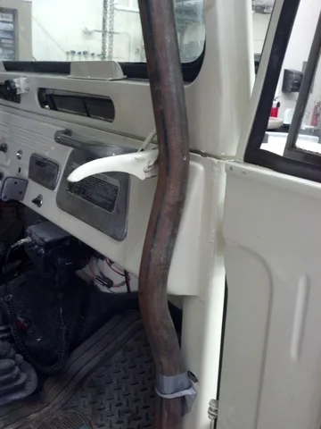

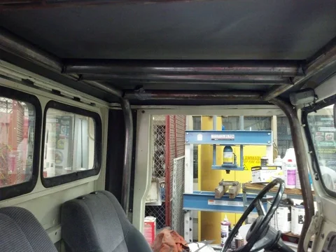

Spent the after noon building a roll cage. I used the POs Metal Tech-ish dash bends, redid the rear hoop because I have to clear the top and he didn't, and added a front spreader and two middle spreaders.
Got it all in and tacked.
The door will not close. The WS will not latch. There's not 1-3/4 to be had between them. There's not 1-1/2 either so I cant rebuild the whole cage out of 1.5 and make it work either. I might be able to move the latch a little, but I don't know if I can move it enough. The latch on the bug-catcher vent window hits too.
