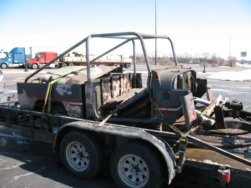

Luke can correct me where I'm wrong but I believe the history of this truck is the last owner was a high school son of a metal worker. They did some repairs to the cab and fabricated a replica of the bed. They also painted over the factory green, (it is an OG truck, originally green) with the gray and fancy 80s stripes.
LukeZero found it poking out from behind a dumpster after it had sat for many, many years and rescued it. He dragged it home and began a major truggy project on it. His title date is 02. He parked it in the lower level of his really cool 1920s-era car dealer building and began working on it. Recently he traded a mill for a buggy and the 45 was put aside. Then he lost his way and sold everything. I was second in line for the 45. After looking at extensive pictures of what is not bad rust for the midwest, but terrible for TX, buyer #1 sensibly opted out. I'm not so sensible.

As of a few hours ago I am the proud owner of frame number 16634. A fixed top SWB FJ-45 with some issues. The title says it's a 66, the VIN tag says 65 and the frame number says early 64.

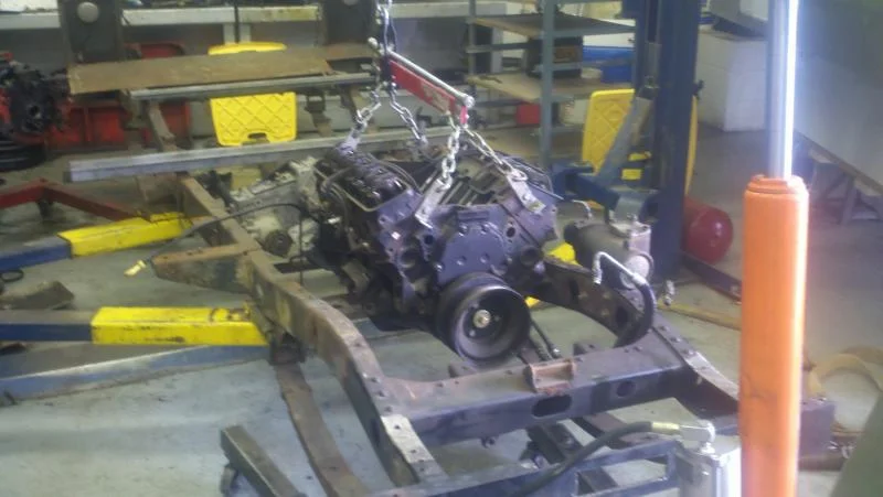

Put the frame on a hoist. Bolted the motor and trans together and dangled them in place.

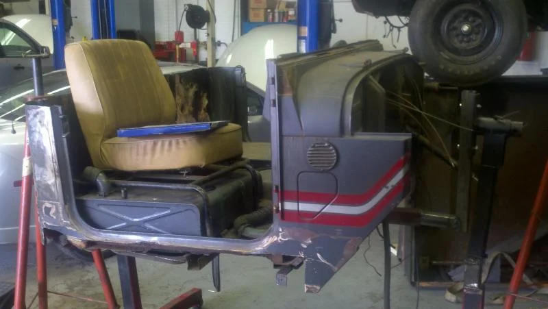

re-built the rotisserie to fit the cab and got that hanging.

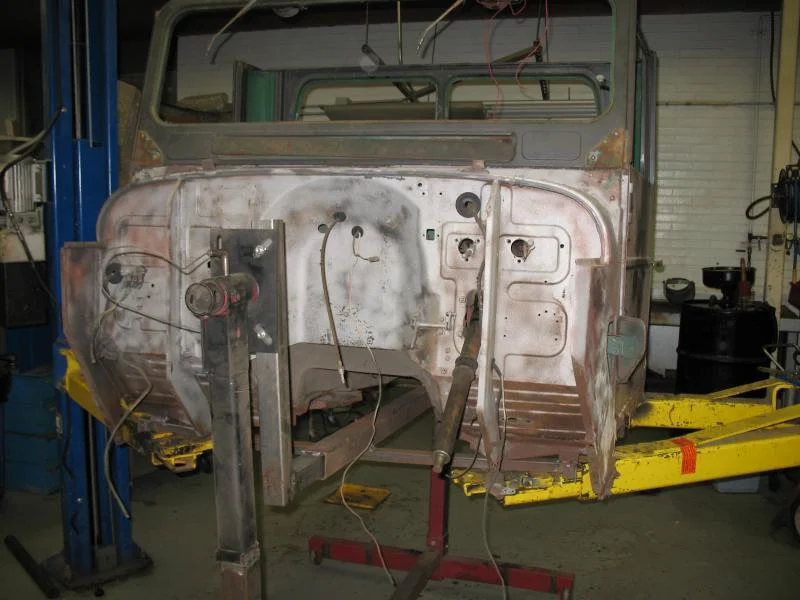

outside of the cab is mostly stripped.
tunnel hump is all sandblasted.

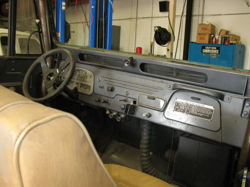

pulled the heater box that was in the passenger footwell out. Doesn't look very factory. Was there a dealer installed after market heater put in the no heater trucks?
I'm liking the grey on the dash. At least the lower part where the dash pads would be on a later truck.

I believe the early heaters were a dealer job, and many 25's, and early 40's had several different makes of heater that I've seen.

I'm not a huge fan of Tracy David, but occasionally he comes up with a decent tip. He did this one when mocking up the motor on his Power Wagon. Better than trying to make mounts with it swinging from a chain.
and no, it's not adjusted yet. I'll put on the exhaust manifolds and crossover and all the accessories first to make sure there's no surprises.

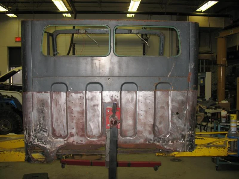

Most of the day was fighting with the sandblaster. I got a cheap pressure tank blaster that it a giant pain to set up so it flows right. I went through 4 60# bags of black magic coal crystal media. I still have 4 more, but it was cold and nasty outside.

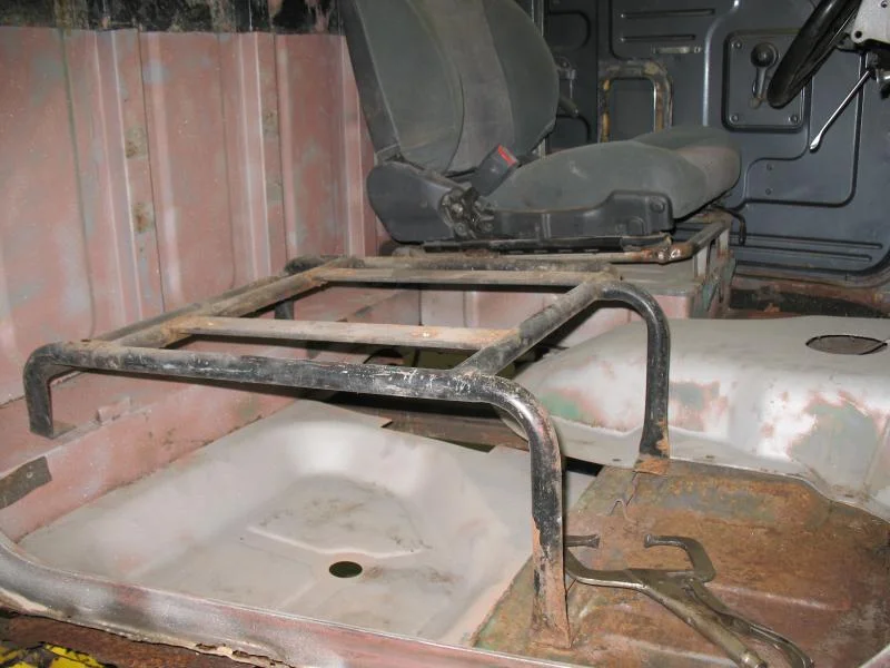

When I pushed the rotisserie inside we put the cab on a hoist to support it and test fit the seats so we could see how tight it was going to be. That led to putting the top panel on to find out how far the seat could angle back, then the wind shield and driver door.
The answer is very tight, but very, very cool.

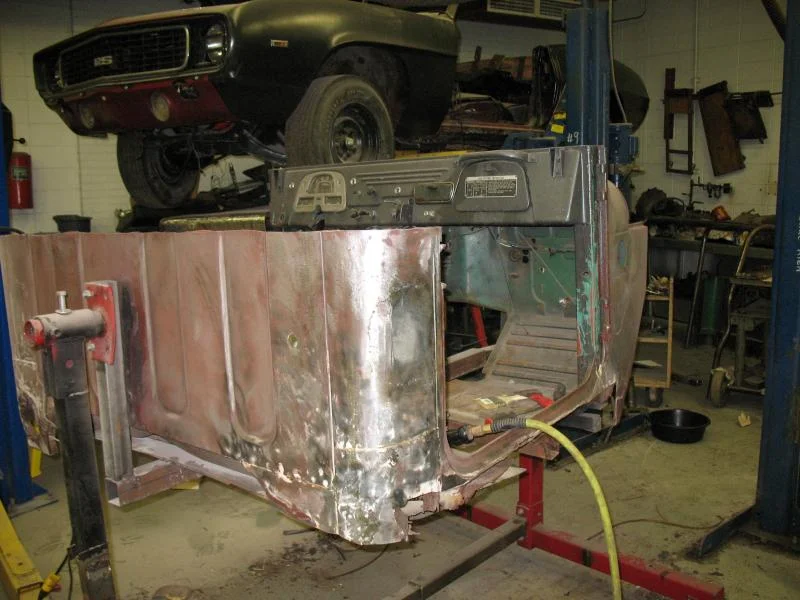

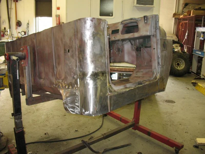

Made panels for the left side sill. I had to two piece it because my brake won't bend a chunk that long. I bent the panel at the top to help create a base for the door opening lip, at the bottom 'cause it's supposed to have a flange there and at the ends to re-create the proper seam.
Made a patch for the bottom of the cowl to tie into the sill.
I made a new panel for the inner lip at the back of the gas tank, along with the channel behind that panel that goes up behind it.
I got them all tacked in and a good chunk of the seams TIGed in. No pics yet, but the passenger side is looking pretty good already.

Getting there. Still got a bit of finish work to do. The little pieces behind the stuff you can see took a lot of time.
I wore a helmet and a welding jacket almost all the time, but I am sunburnt, smelly and my eyes are tired and dry. I sure wouldn't want to do this for a living.
