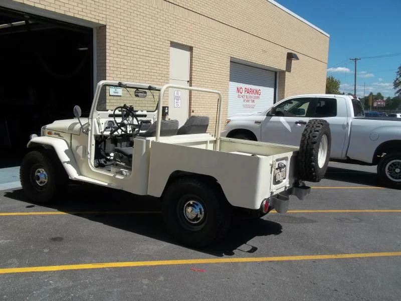

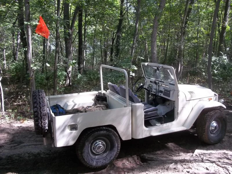

Ended up with pass side rear tire carrier and single bar in the bed. I might go with more of a headache rack look at some time in the future. Right now I wanted easy in and out.

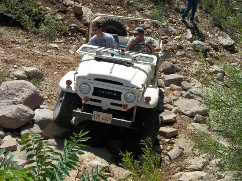

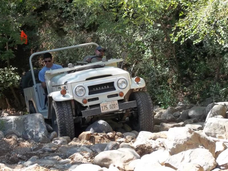

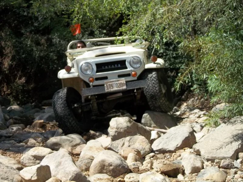

Went wheeling this weekend. It was really nice to drive something different and something that took a little attention on the trails. The Pig has been through these trails so often that it is pretty mundane. The 45 was anything but.
