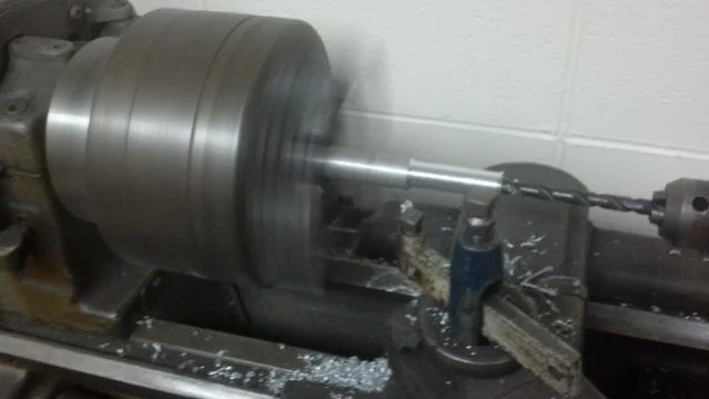

Ive had a problem for a while with the brake pedal having too much play and being too close to the throttle, especially given the very tight quarters. I made a new aluminum bushing for the pedal, notched it and bent it to put it more under the column and closer to the floor.
nice idea! I like this. Are you making any extra bushings? :-)
