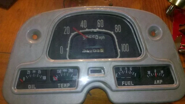

Fuel sending unit and fuel gauge showed up this morning so I took a different gauge cluster apart to see if my plan to fit sun pro gauges into the old cluster would work.
I think it will work great. I got the idea from looking at tornado's cluster.

And, of course, put new gauges in the gauge cluster
It's getting pretty drivable.
Wired up the gauges this morning and installed them. I had 100 psi of oil pressure and 250 degrees of temp at start up. Amps were right on though.
Put in the sending units that came with the gauges and everything it right where it should be

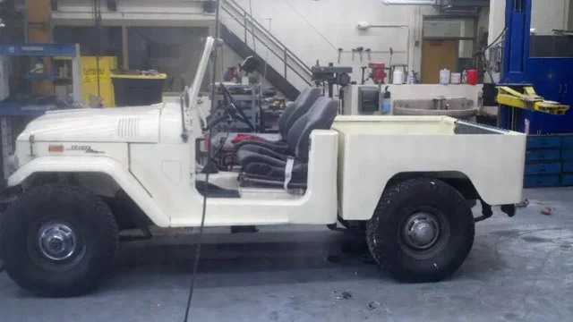

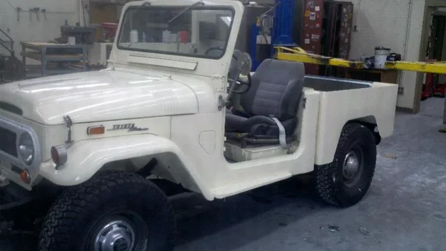

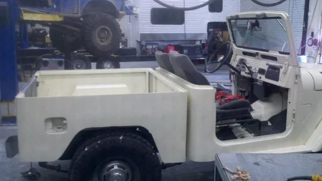

Got the gauges in in time to find out there was almost no oil pressure. Killed the motor. Swapped in a different short block, but I've been waiting on a part. Started the bed. Got it in filler and high fill primer the last couple of days. Sealer and color tomorrow.
App started working. Now I have pics.
I just sat it on the frame. I have to bolt it down, paint the inside of the tail gate. Put the fuel filler door back on, Mount the gate, and put the tail lights back on. It's easier to get the rear bed bolts off if I drop the lights.

Wow, looks real short (2short?)! Now that it's all one color you can really see it! Bummer on the motor...
