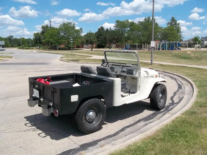

Today I:
Mounted the bed
Installed the tail gate hinges, chains, plate bracket and plate light with the tail gate.
Installed the new plate.
Installed the drivers seat belt. I need to round up a passenger one
Test fitted a head ache rack, but took it back out.
Welded up the passenger seat frame and installed the frame and seat.
Installed the bumperettes
welded in the fuel filler mount in the bed and installed the door.

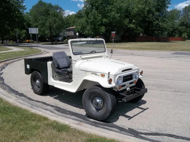

Got a ways to go. Gotta do all the body work on the bed and tie up a lot of things.
Took it for a drive to Jersey Mikes this evening.
Has a bit of a speed wobble. The motor is way too fast for the suspension. Alternator still isnt working, although it was really hot when I was hooking up the battery charger when I got home.

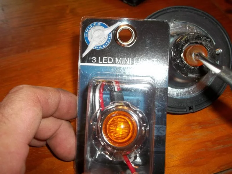

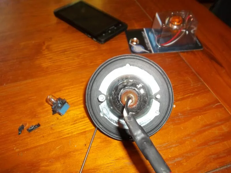

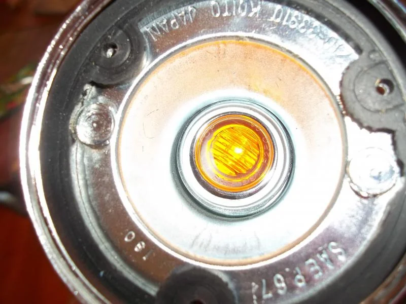

I got a couple of 3 LED marker lights in the mail yesterday. My previous attempt at making a shorty bib light failed. This looks like it might work. I need a short light on the driver side to clear the scout PS box.
I cut the bulb socket off. The black stuff is RTV from the other bulb. If I hog out the back to 3/4 the grommet on the light should seal it right up.
Edit - it did seal perfectly with the grommet.

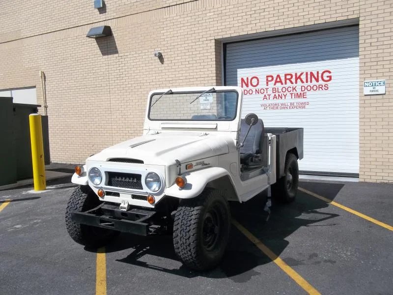

....and she is home!
