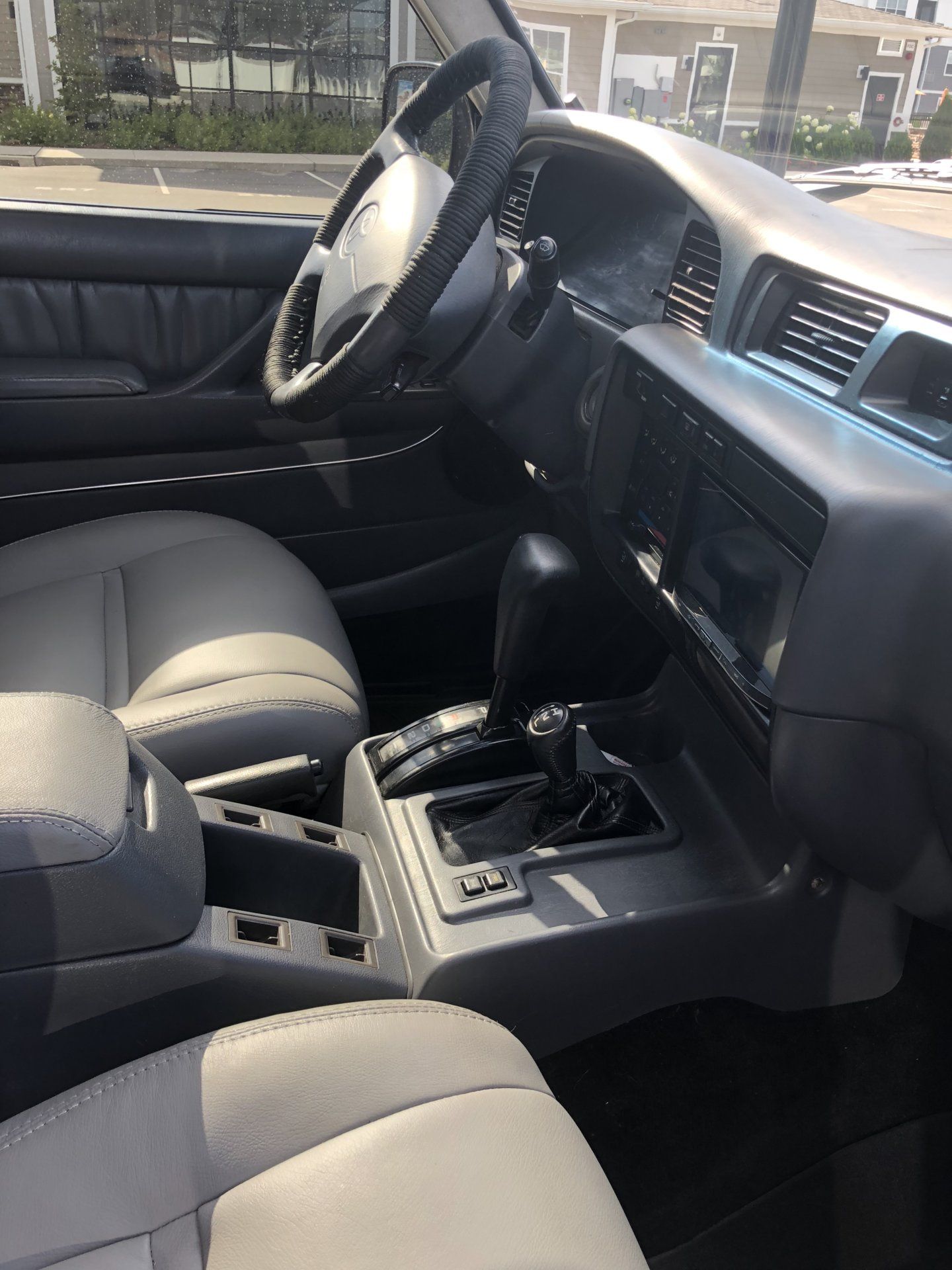

/e Also did the heated seats when we did new leather from Land Cruiser Heaven, well worth it!
WOW M1C4H! Your rig looks amazing. OK, I guess I am being swayed - exactly why I wanted to post this before I formally begin work on the 25th of February. I've definitely added heated seats and LED reverse bulbs to the plan of record. The leather you got looks amazing. We want to try to match the two-tone 40th leather as best we can.

Only had the truck a little over a year and my buddy Drew at True Roots Customs has rebuilt the engine, new lower remachined everything, Toyota everything to accompany it, rebuilt knuckles, new leather with the heated seats, wheels and nitto g2s, brakes, and this radio;

OEM Toyota seat heater switches
Parts
Dorman seat heaters for both front seats
Labor
Installation of seat heaters and factory switches into center console
Parts
USB ports for the switch blanks (still need to keep looking for flatter switches)
Labor
Installation of USB ports
