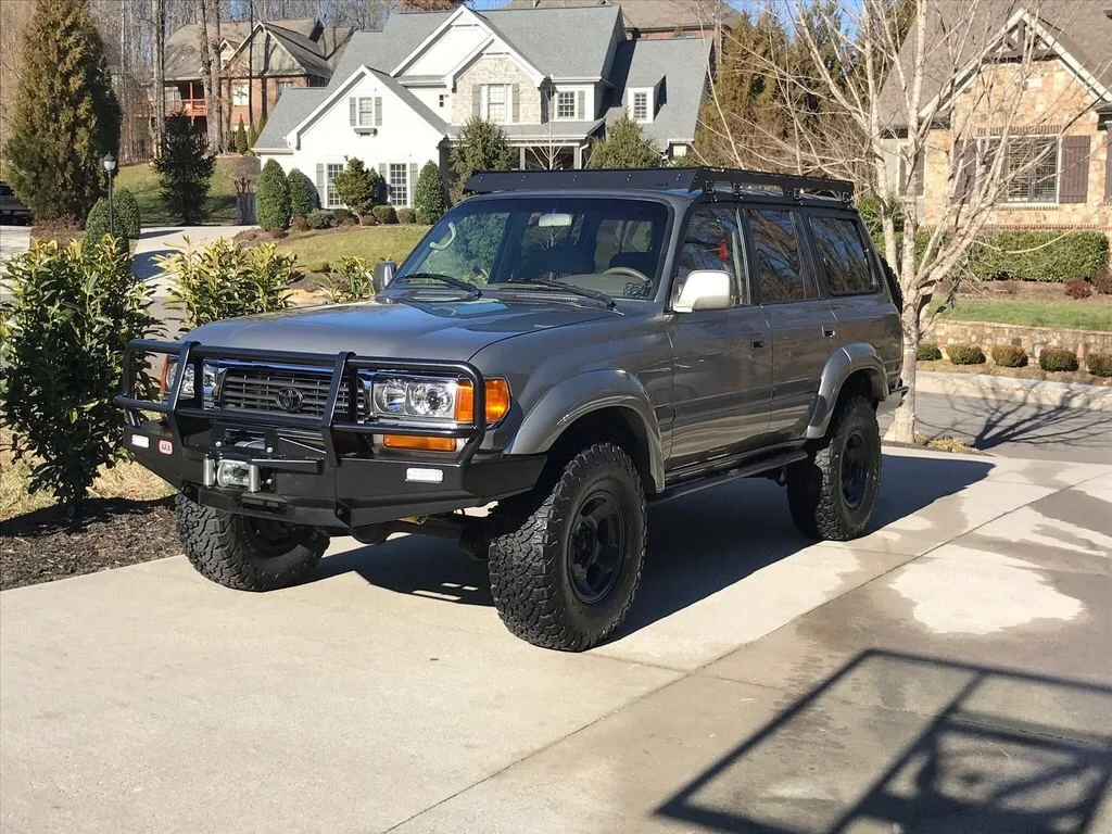

Love the vehicle, the goal and the inspiration! Doing the same with mine currently, more or less.
Food for thought, the ‘18 TRD Pro wheels perfectly fit the LC80, sans the lug cap and look awesome.
LED reverse lights are pretty dope... just saying ;)

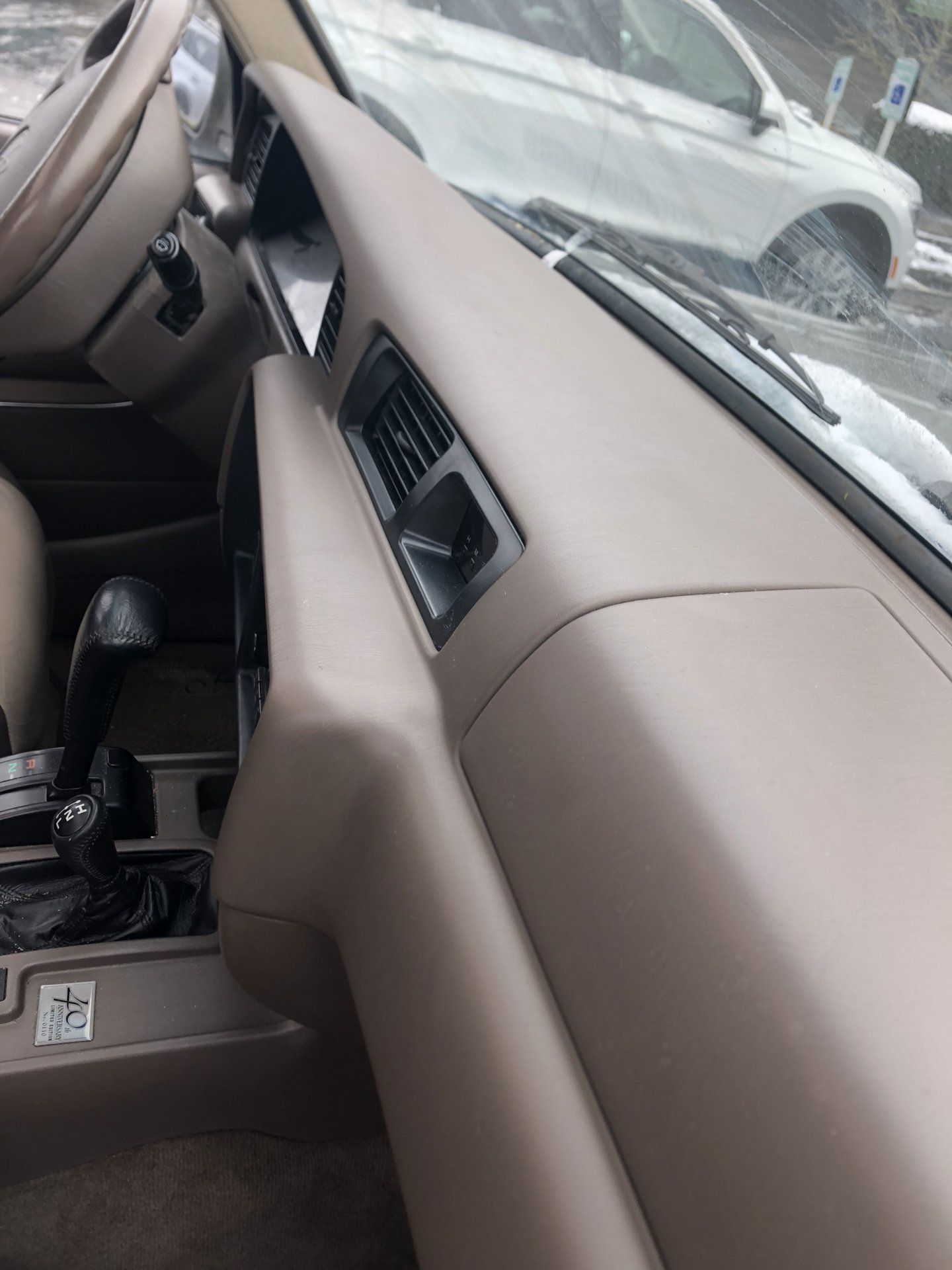

I appreciate the responses. First of all - photos. I meant to take and upload some photos when I started the thread. But then it snowed, and I took the truck up to the top of Hurricane Ridge in the Olympics, and it's too cold to clean the beast. So here are some photos of my 40th Edition as it sits now.
And here is another view of the exterior and a few other points of interest. Its not in bad shape. I have considered the possibility that it doesn't need new paint, and could be detailed/buffed to remove oxidation. Because of the snow I didn't get good photos of the hood or roof but it doesn't have the problems some LC's have there. You can also see that there is a lot of green growth under the sunroof faring, which will be removed and not replaced. When this snow melts here in the Pacific Northwest, I will take much better photos of the car - both to post here and so I have a solid set of before/afters for the work we're about to do.
Do you have any leads on LED reverse lights that you like? I guess I worry that there will be too much in the way of extra transformers, etc. but perhaps I am overthinking it.
Also I looked up those wheels. I have to admit, they look amazing. Food for thought.
