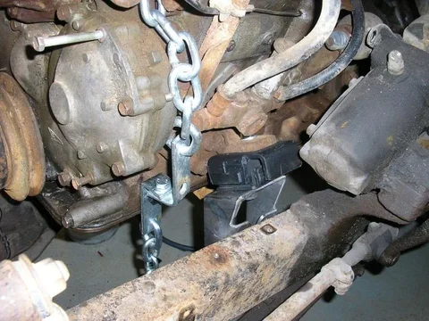

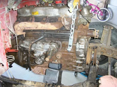

To start this thread off I have just finished a small run of 40 series 3B motor brackets. These are the brackets that rivet (or bolt or weld) to the frame rails and will locate your 3B conversion with the correct offset and height when welded or bolted in the correct spot ;). I made a set for myself a while ago and below you will see them in use. They are 3/16" thick and identical to the original in all respects.
These are offered at $90.00 a set plus shipping
In the center is a factory set I used to build from. The "top plate" is not welded on yet in this pic.
Left side
Right side

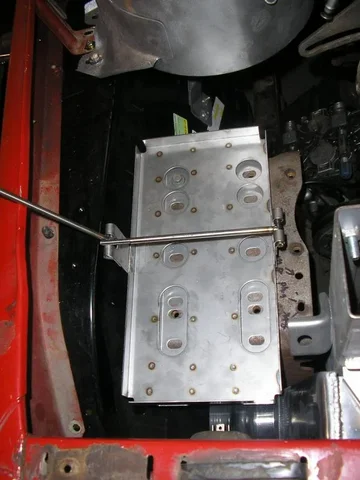

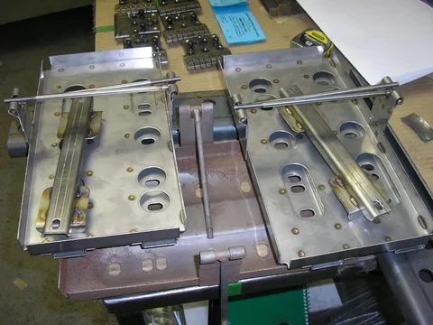

Another item I can supply is stainless steel battery trays. I made some for my build to fit two group 31 batteries. Now, my build is custom so the larger batteries fit. I can make them any size you want or even your own design. Battery trays like these or original size are priced at $70.00 each

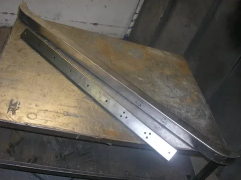

I have 79-84 rear sills for your rusted 40 also. This part is in beta testing (sold one to see how well it fits for him). These are exactly like the originals with a couple small differences where it doesn't matter (i.e. the recess for the doors doesn't end in a rounded fashion but in a square corner - it's covered by the side panel anyway) One thing I have to add still is the holes and captured nuts for the tire carrier etc. I will add them as soon as I figure out where they are :hillbilly:
These will be about $250.00 once I add the captured nuts.
I will be doing earlier sills once I get some measurements and time; they will be a bit cheaper because they are easier to make.

I have now located all of the captured nuts in the 79-84 rear sill

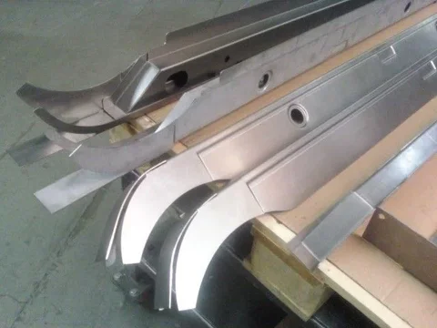

Here are some pics of one I just did - the two halves are not welded together yet cuz the paint was still wet (I painted the inside where you can't get to later with a really cool stainless steel paint I have at work that can be spot welded through)
These are available now (ship in ten days kinda thing) for $250.00 complete
The inner piece with drain channels like the factory
Floating stainless steel captured nuts for the door catch (M6)
Captured M8 nuts for the lower tire hinge and M6 for the rubber stopper and latch
