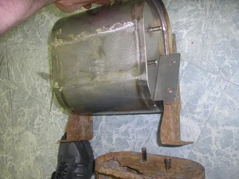

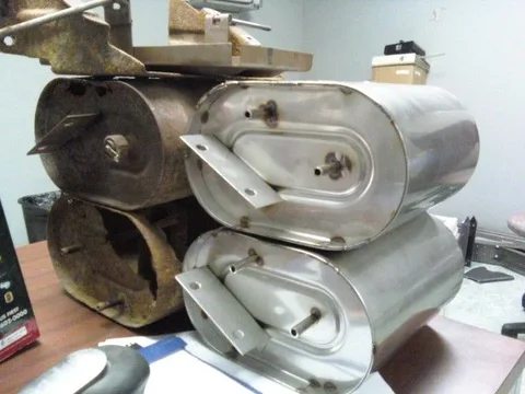

Pictures as promised

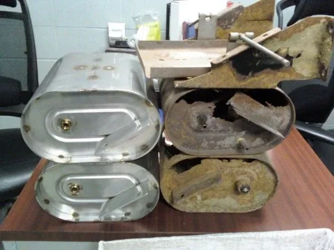

This stock one miiiiight not hold any vacuum
Not powder coated yet but you get the idea

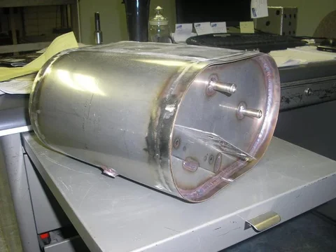

Update: I have improved upon the vacuum tank by adding the rib detail and changing how the ends are welded on. Here are a couple of pics showing two tanks prior to full weld - just tacked together.

Hey why did the stock air tank have that bracket in the middle ????
This makes me want to buy an LPB just to assemble one of your beds on it. Nice work. PM me a shipping price for one of your early rear sills. Can I get one with the soft top tailgate hinge captured nuts and no tire carrier nuts? Its for an FJ25.
Fox - if we can hash out some dimensions I'd be happy to.
I believe you are reffering to the "baffle" inside the vacuum tank - I'd say it is for strength to prevent collapse

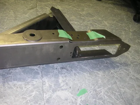

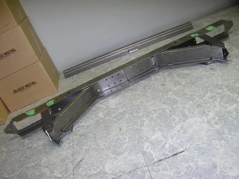

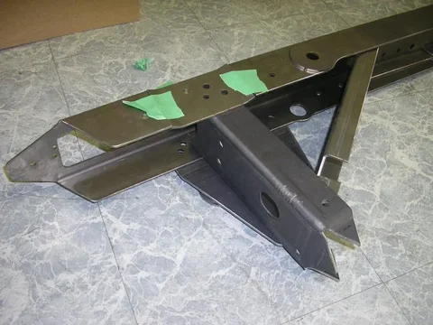

A while ago a friend needed to replace the rear end of a 79-84 40 frame so I made up these components. While I was at it I made the spare set shown here - currently for sale.
Edit: added prices so I don't keep forgeting
Frame Gussets - $156.25/set
Frame rear member = $306.25
Shackle plates – $112.50/set
Frame ends – $112.50/set
These parts are shown before any detail welding is done hence the tape holding in a piece.
There is one minor error on the assembly and that is the mounting holes for the bumperettes are a little oversized. The sample I was given to copy had been drilled out by some PO - nothing a flat washer can't fix
These parts are available separately of course but you could replace everything aft of the rear axle hump in the frame. Well, everything but the spring perch which I don't make.

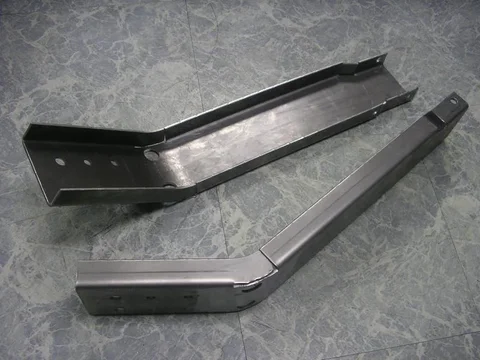

The last foot of the frame rails - they have a built in offset fish plate for welding
Left and right frame braces
spring perch plate
