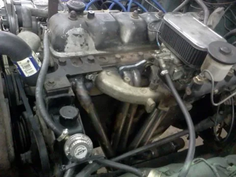

how well did the washers sit flat on both the header and intake? Typically the header flange is thinner and you will need to run 1/2 washers to shim up the common washer and even the load

Don't know yet. Not sure why JTs doesn't sell those washers. Were hoping what we did works.
You have to cut a thick 5/8" washer in half....grinder and vise grips
Awesome!!!!

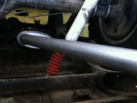

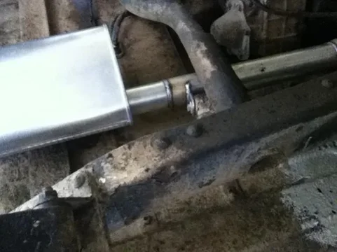

Did you turn out the exhaust to the side? If it is going straight out, you will suck fumes. If on the side like OEM you won't.
Really makes a difference.

Why y'all hatin' on flow master? I have had a 40 series on my 40 for years. Love the tone. Oh and I will let you drive a LX 450 with a magnaflow that will make you dig out the ear plugs after about 20 minutes.
