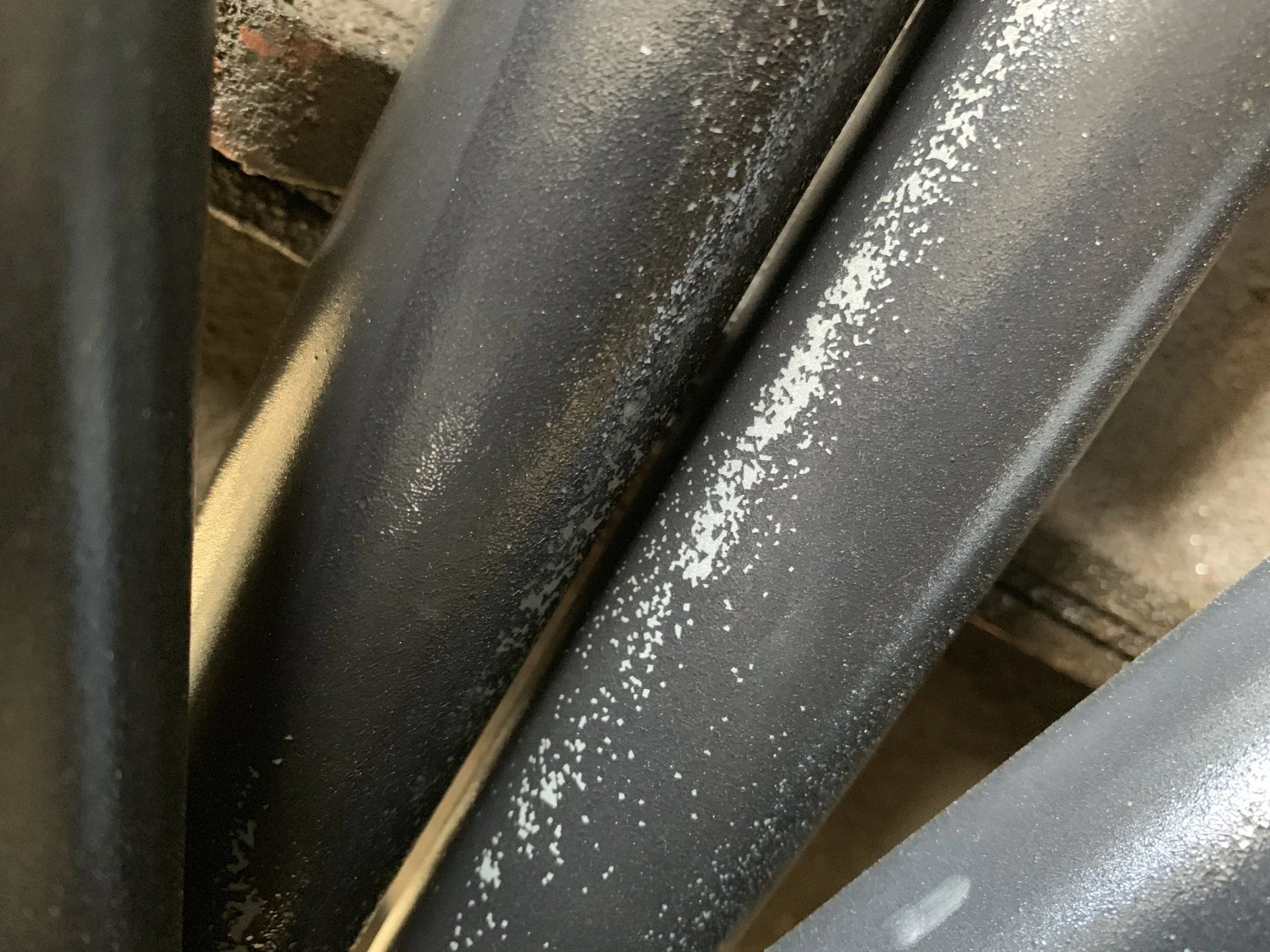

So my ceramic coat is all crumbly.
Mine did the same. $200 down the tube.
Theyre going to recoat them in a more durable finish for me and pay for removal and replacing. I guess we will see.

I could be wrong but it looks like the ceramic coating was applied over some sort of primer. Appears primer could not hold up to the heat and cause the coating to flake.
I cant tell if whats under the flaking black is grey or the steel. The black definitely didnt take to whatever it was coated to. I drive the 40 just about every day, but 2 weeks is a little soon for it to fail. Especially since it never gets above 3,200 rpm

Well im planning on getting the header off tonight after work, and getting it to them tomorrow. They said they could have it back to me in 2 days. I leave for Oregon this weekend, so wont be able to install it back until I get back. Maybe the black coat is just not very strong or durable, and their silver is the stronger spray? Ill be sure to keep you updated. I have used Ricks for powder coating stuff before and their powder coat is great.
