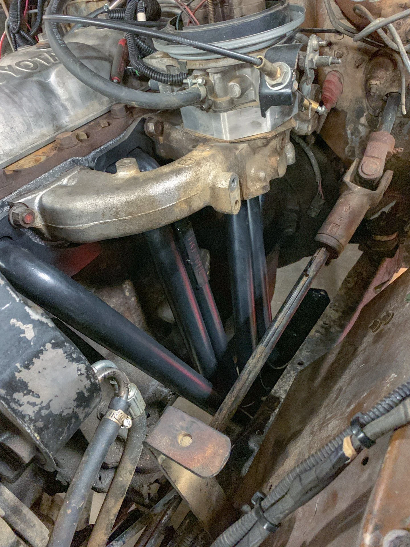

Ceramic coated headers in. The temperature difference of the hot air on the shins is pretty dramatic with the vent open. Load is a lot smoother. The very back hole for the bolt was stripped but put a longer bolt in it and kinda made it work. 10/10 worth it. Couldn’t fit the cat though. Back to amazon it goes. Glad I got it coated. Hopefully won’t have to worry about it again for a while

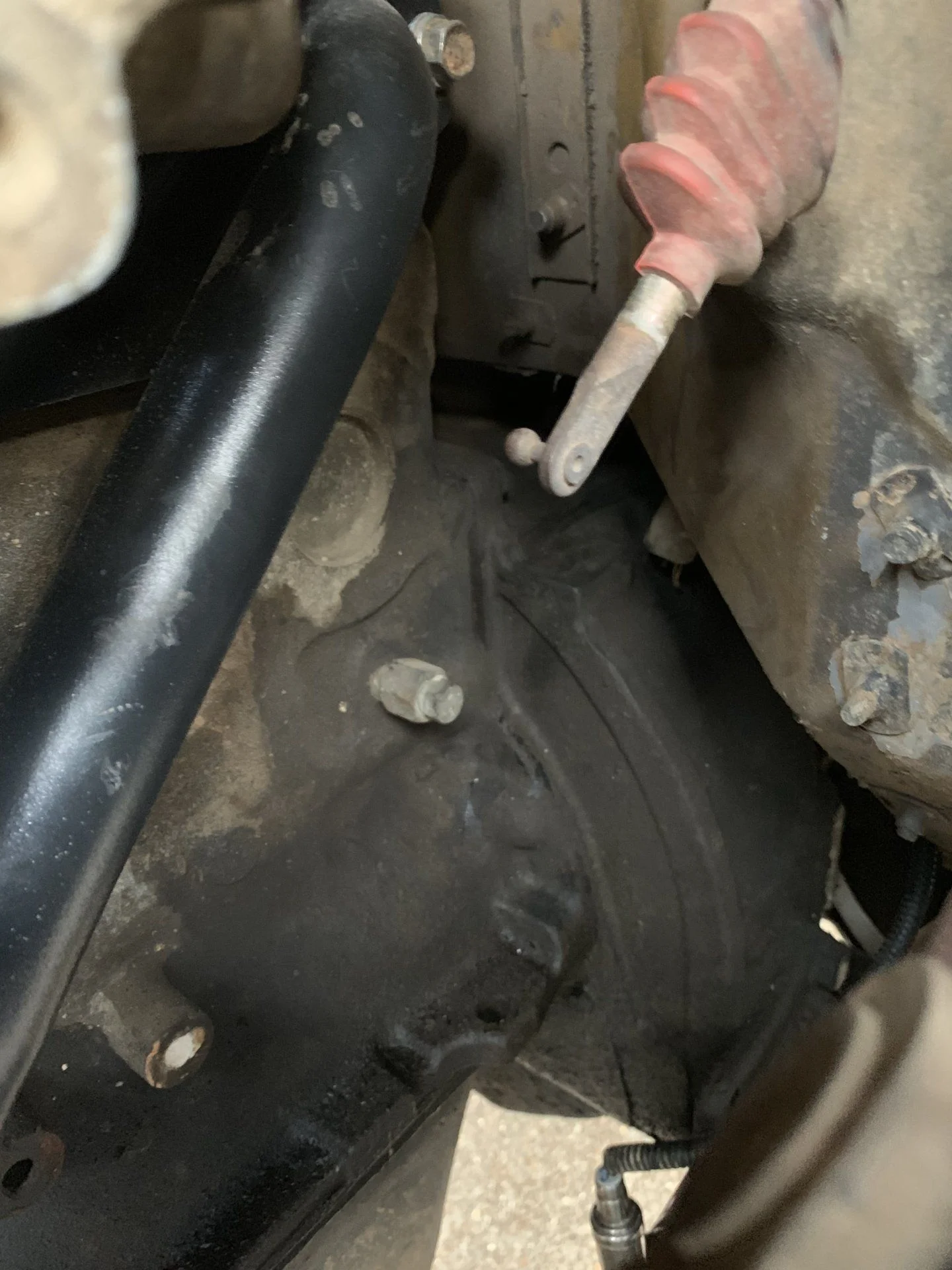

Theres some kind of oil leak out the back of the motor coming out of the inspection plate for the bellhousing. After reading I think theres only the cam plug and rear main that can leak oil there. Thankfully no gear oil is leaking and trans and T case are perfectly dry. Leaking oil is darker in color, trans fluid is brand new and clear.

Cam plug. That’s a freeze plug. It’s not likely leaking. If you get the bellhousing off and it’s leaking they are generic and can be picked up local.

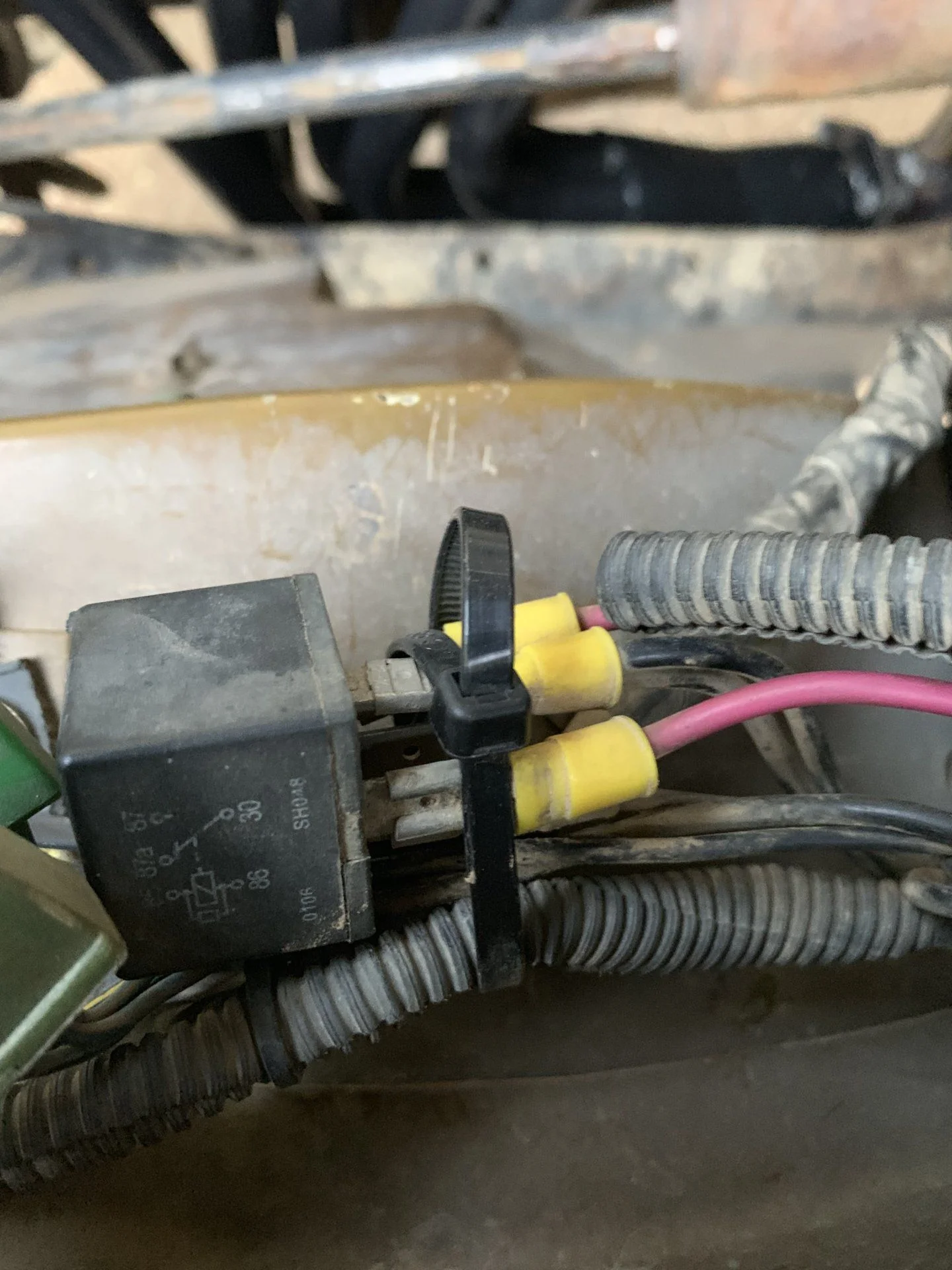

In an effort to get my oil gauge working. Was wondering if anyone had any tips for me. So I’ve got a sender unit, but the wire comes out of it and seems to go to a Bosch relay. Maybe a EFI shut off switch if it loses pressure?
Here’s the sender:
The red wire comes off of it and ends here:

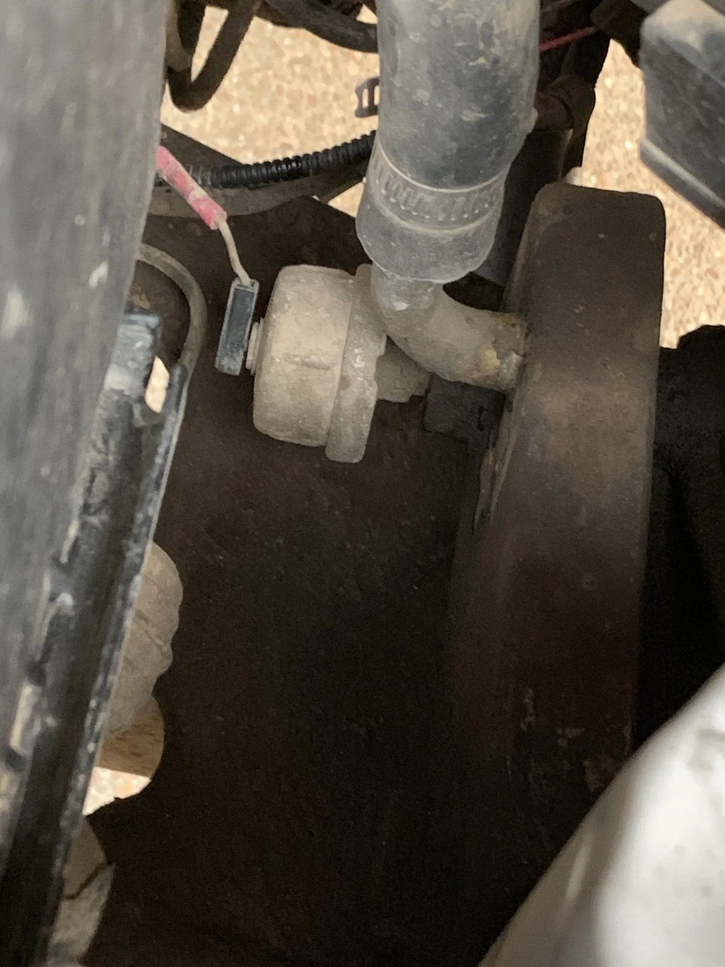

I have a spot on the block that looks like it’s plugged off. Was wondering if I could put the a second sender in it the yellow black wire that goes to the cluster is there. Didn’t know if that was a stock location

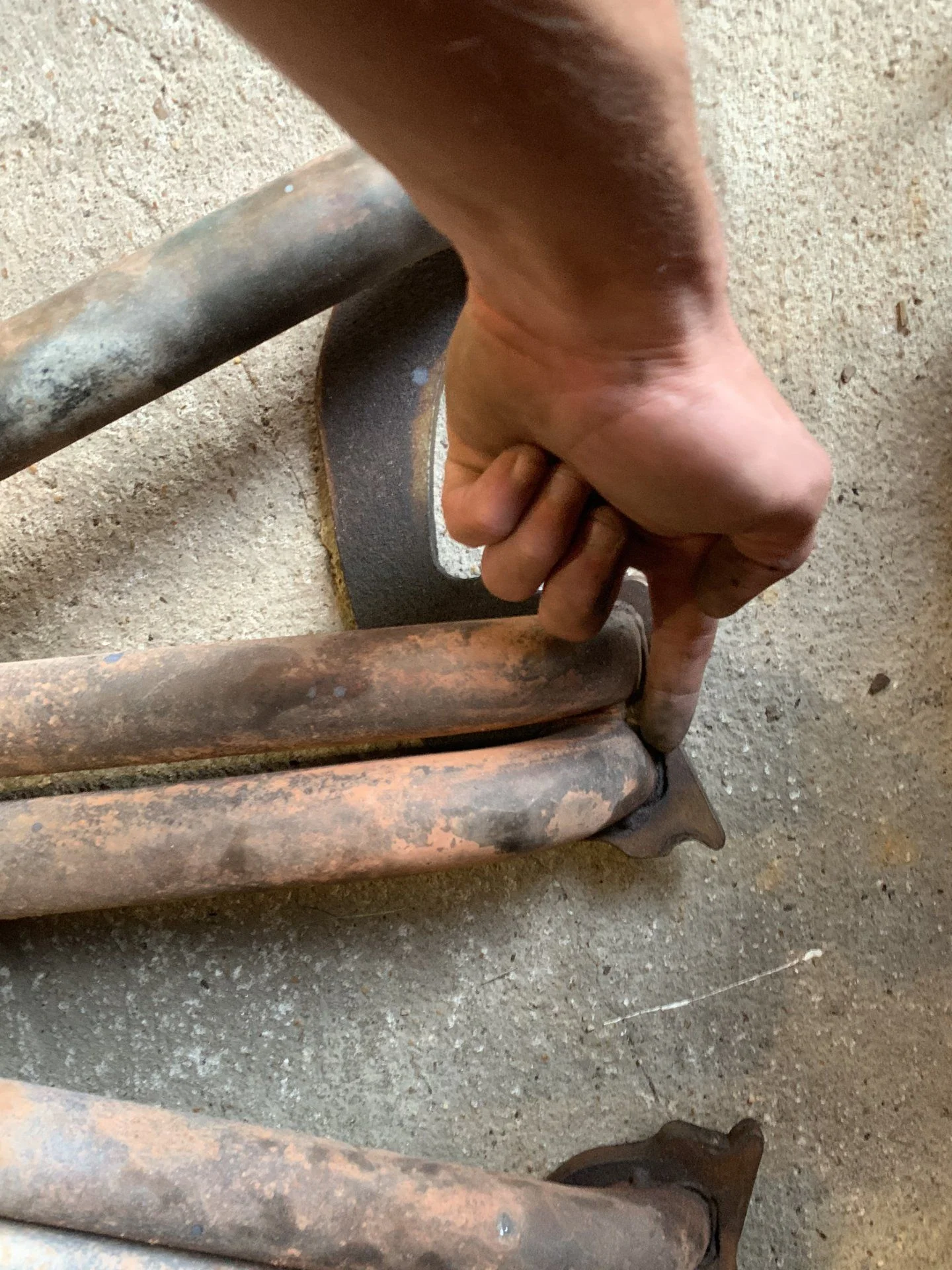

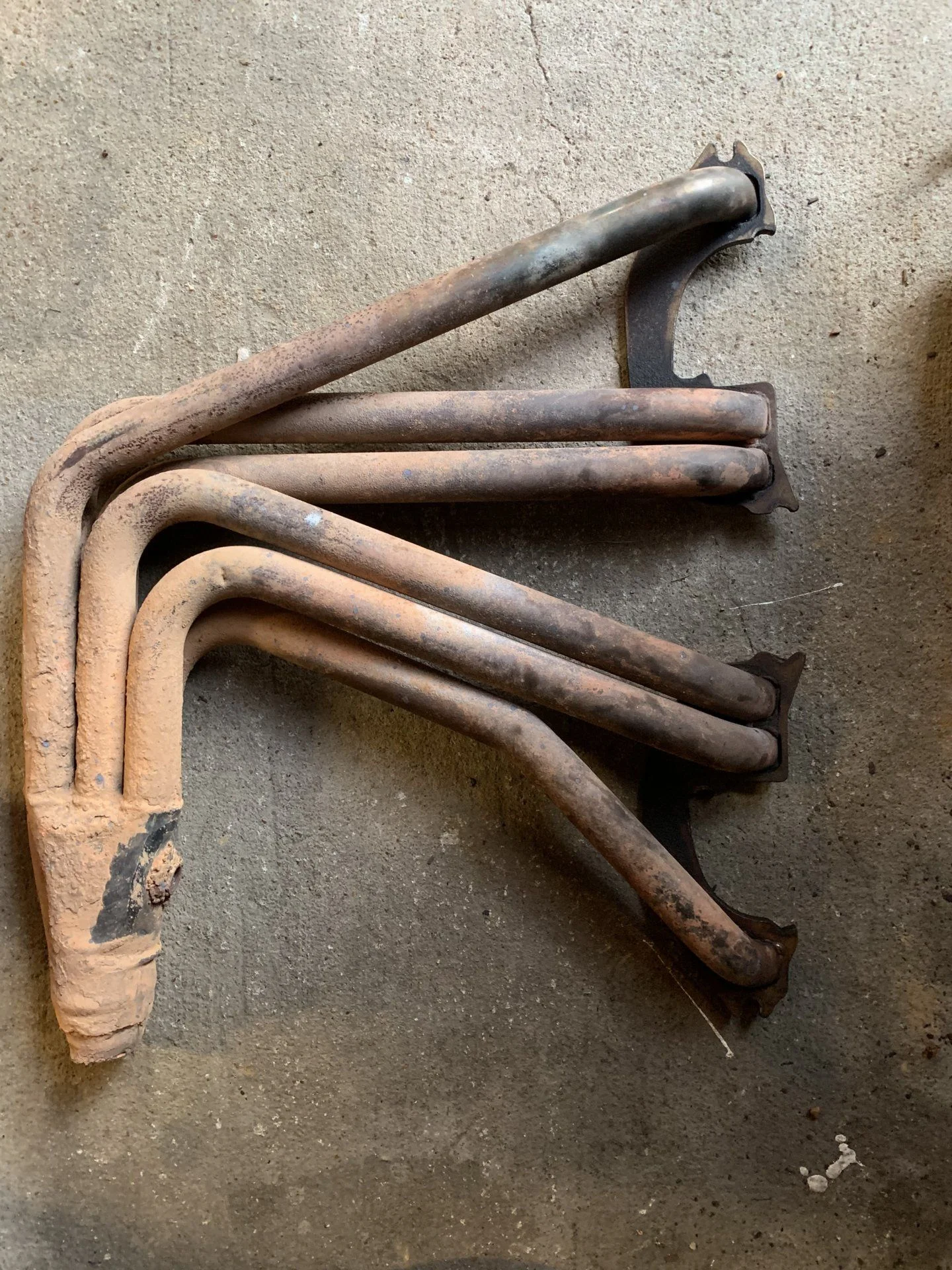

Also if anyone needs a header for a 2f the old one is up for grabs. It’s got a spot for an o2 sensor and has small repairable leaks where my finger is pointed

Wire should not be going to the relay. That relay is for the light bar. Follow the wire carefully, it can get confusing once you get to the firewall.
As far as the plug on the side that is the block drain to drain coolant out of the engine. You can put a sending unit there but it will read coolant temp not oil pressure.

Ah okay might be overthinking this hah
