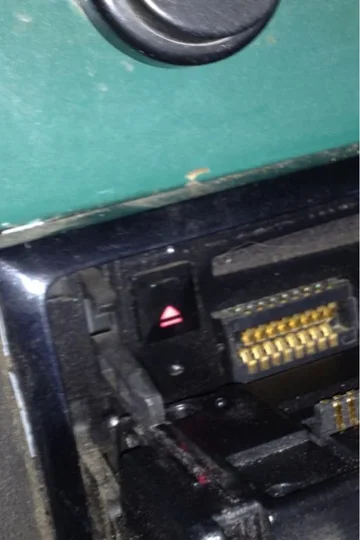

Well the red eject light is illuminated so it looks like radio is powered. I can not find a wire that comes directly off battery to power the radio. Looks like I might be getting knew radio.

mike, that radio should be fine. what is wrong with it? cd player not working or radio not working or....?
will it take a cd? I think you can "lock" that unit bc the face detaches....look up the manual on a google search?

Sounds like your constant power (yellow) is connected. Does it have a clock and does it function? If there is a clock button on the face, press and hold it to see if the clock comes on. That yellow wire may be routed to an "always hot" spot in the fuse box. It also sounds like the ignition power (red) is not connected or the in-line fuse is blown. HTH
