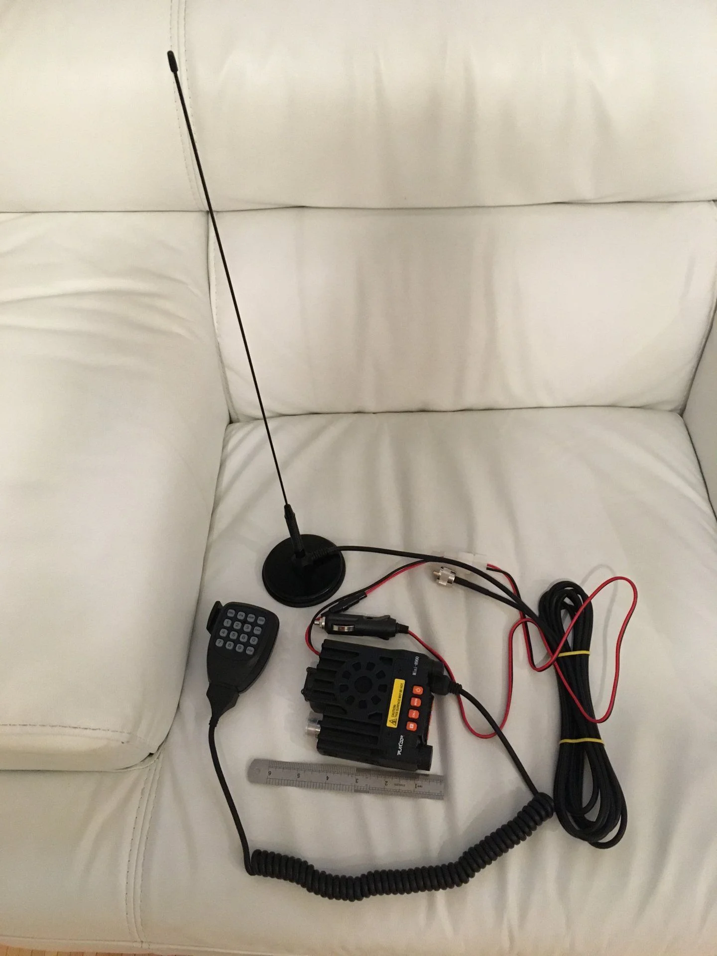

Baby HAM setup for the GX came in today:
China-made Talkcoop KT-8900, 25W VHF, 20W UHF. ~$70 from Amazon, + Nagoya UT-72 magmount ($28). The "English" in the manual is a hoot...
There's a USB programming cable included, and supposedly this works with CHIRP. Interwebs say it only draws 5A on transmit at max power, so power from the cig lighter ought to be fine... we'll see what the noise is, and then I'll consider stringing cable from the battery.
And there's a PL259 to SMA pigtail, so I can run my Baofeng handheld with the magmount antenna.
The antenna is 1/4 wave on 2m, so middle of the roof on the GX ought to be fine re ground plane (similar setup in my '80 worked well). It's 5/8 wave on 70cm, we'll see how that goes. The repeaters here that I'm familiar with are in the 2m band; some of the emergency comm channels use 70cm, so I'm curious how this setup will do on 70cm.
Radio manual states that you ought to cut power to the unit if smoke comes out (seriously?? why not let it burn?)... we'll see. Last time I chanced one of those ChiComm Radios from Amazon, someone had already let the smoke out before it got to me - both fuses in the harness were blown :)
