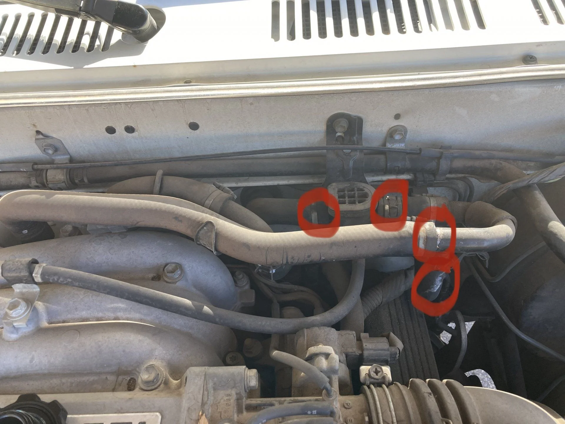

Among the myriad of Toyotas in my stable is a mostly stock 1990 4Runner with the 3vz-e engine and front and rear heat. The original heater hoses have finally deteriorated after 3 decades and are now leaking. In the below photo I’ve circled in red all of the locations where coolant is seeping out.

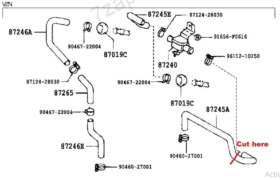

I'm not familiar with the 3VZ, but it appears some hoses are available.
1: 87245-89231, $26.03 list
2: 87245-89269, $15.49 list
3: 87245-35040, $70.14 (OUCH!) BUT, this looks like a hose for a truck without the rear heat. The hook can be cut off for your truck. See pic.
4: NLA
I can compare the hoses on both the 22re/3vze but I have an 87/88 year range. Not sure if it changed for 2nd gens. Also, my 4Runner is not equipped with rear heat.
4: NLA

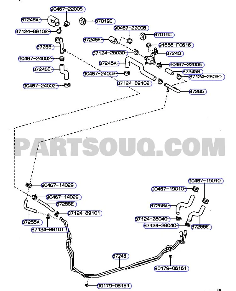

Thanks @pappy Below is the diagram for 3vz with rear heat that I was working from.
