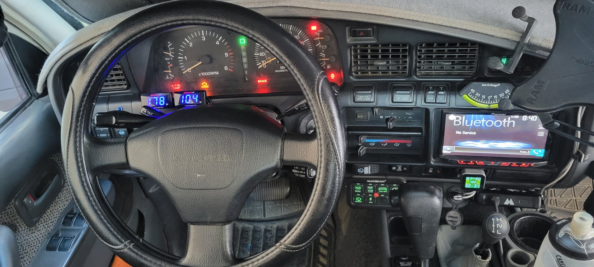

I’m gonna go out in the limb and say its the water temp sender off the theromstat housing, the back wire tends to get real corroded. Make sure u replace with OEM or a used OEM that works. Aftermarket will give you these symptoms, at least my autozone one did, but it would go above the middle mark and back down again, multiple times a day. And burp ur system by driving the front right tire onto a ramp and let her cool down overnight, then top off the resevour.
Get an aftermarket temp gauge and never have to worry about the stock idiot gauge anymore...
Coolant and tranny temp is all you need.,,
I looked up my receipt from Partsouq- replaced the temp sensor 8942220010 and thermostat at the same time. I’m thinking it’s probably the wire like was mentioned.
Marco- I’ll have to dig into the aftermarket solution at some point, right now I’m trying to get this thing baselined. Feel free to drop any links or products that would be good to research them.
You are on the right track. My advise is to add a digital or analogue aftermarket coolant temp gauge ASAP. Kill 2 birds w/ 1 stone while you baseline your cooling system, etc.

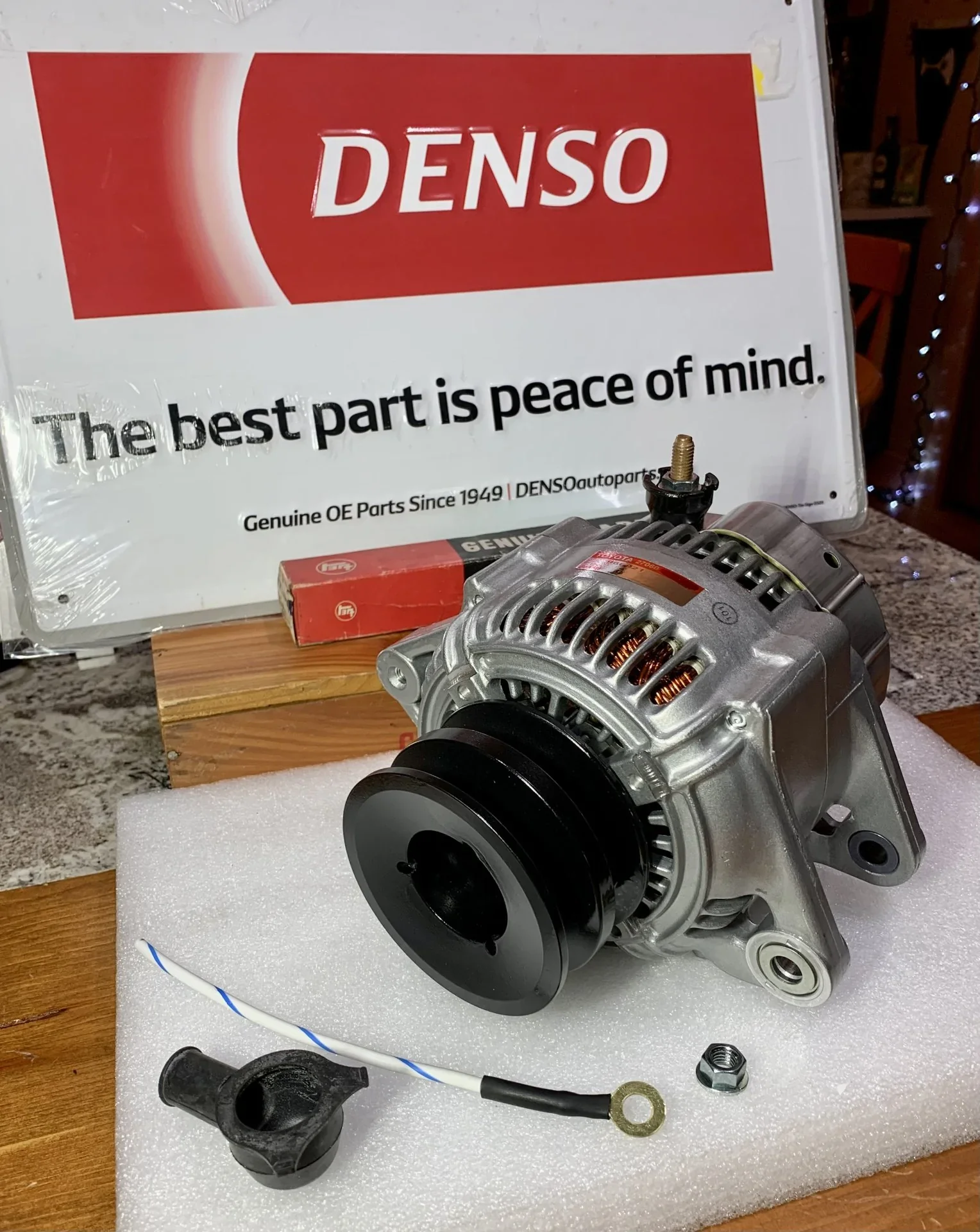

Matt, a bracket to handle the 90A alternators would be peachy. I mangled one of mine with a grinder to allow juuuust enough room to get the belt to tension, but either a block with proper angling (to go between the motor and the bracket) or a longer bracket would both be great.

- i offer a industrial version Genuine NipponDenso 90A External Fan unit , also the OEM internal FAN unit for a 3FE
i know the bottom pivot tabs spacing is different ?
- why does the external fan unit work all years 3FE and the internal fan unit only some years 3FE is how i understand this to be a issue ?

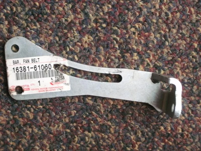

So I have the $21.07 bracket from the dealer, this bracket is for the 90 amp alternator, and the part number is 16381-61060. As you can see from the first pictures, the bracket is slightly different from the original one used with the 80 amp alt. However, I still could not get the 90 amp alternator to fit at the lower mounting point. This mounting point is part of the DS engine mount, so is there also a different engine mount used for the 90 amp?
Has anyone successfully bolted on the 90 amp(part number 27060-61100-84) without grinding the alt. to fit? Try as I might, I couldn't find the hole and get the bolt in. In the end I just put the 18 year old cruddy 80 amp alt back in and put everything back together. I think when I try to replace the water pump, I'll give the new alt. another try, since there will be a lot more room to work in and inspect/see whats going on, and where to grind.

The 90A bracket (16381-61060) being NLA:
