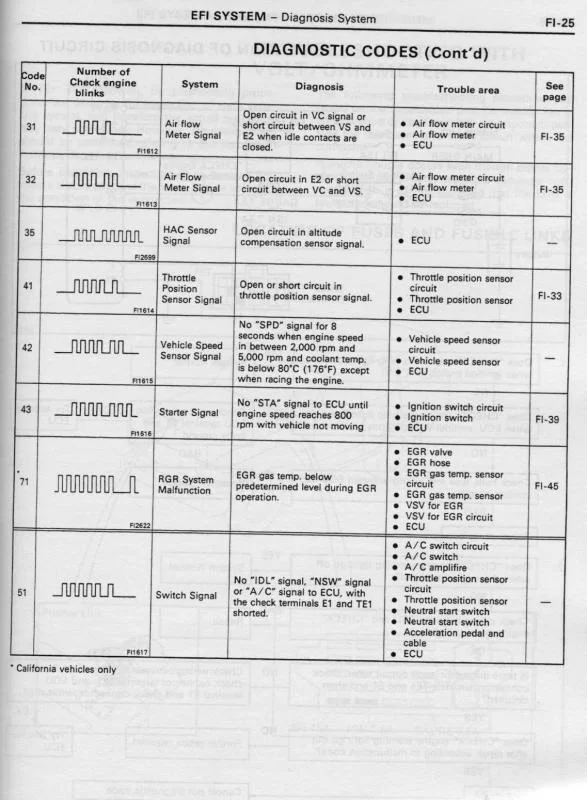

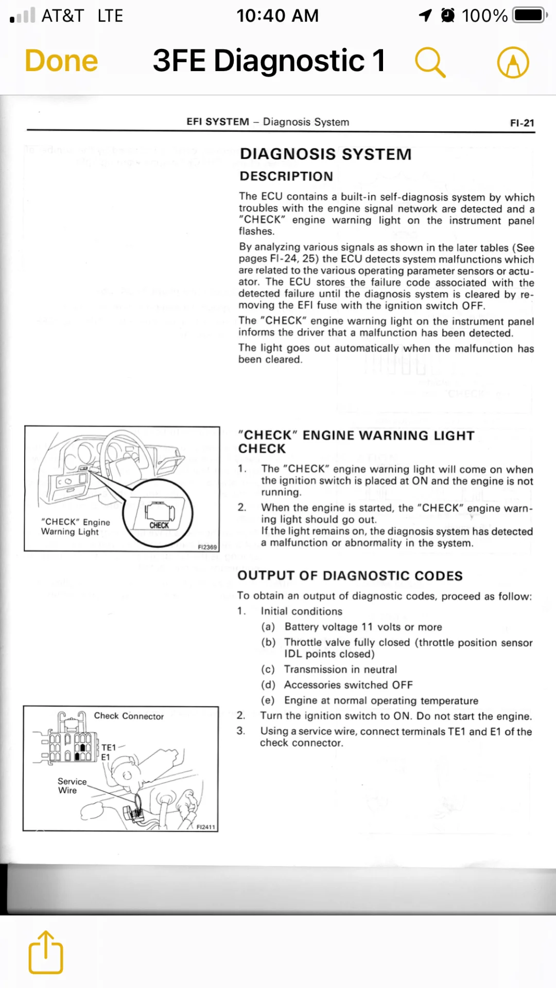

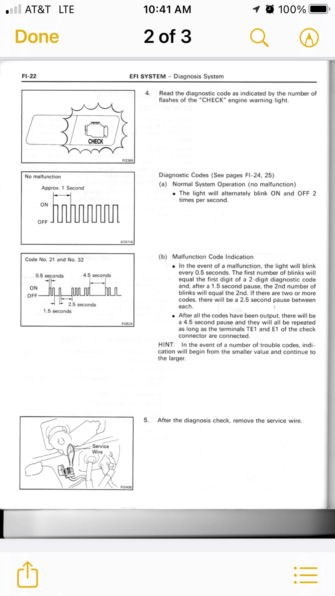

How do you retrieve the codes?
It’s easier than you think. Follow the following steps to find out how your engine is running.
  • Initial Conditions:
    • Battery voltage 11 volts or more
    • Throttle valve fully closed (TPS IDL points closed)
    • Transmission in neutral
    • Accessories switched “OFF”
    • Engine at normal operating temperature
  • Turn the ignition switch “ON”. DO NOT START ENGINE
  • Using a jumper wire, connect terminals TE1 and E1 of the check connector.
  • Read the diagnostic code as indicated by the number of flashes of the “Check Engine” warning light.
There will be a series of flashes. For example, if your ECU showed an error code 13 you would see one flash a pause and then three more flashes. Then a pause of 2.5 seconds and you would see the single flash again then a short pause then the three flashes again. Have a pen a paper ready to write when the light starts to flash.
This is just one page of the codes, if it not on here, post them and someone out there can open up their shop manual.

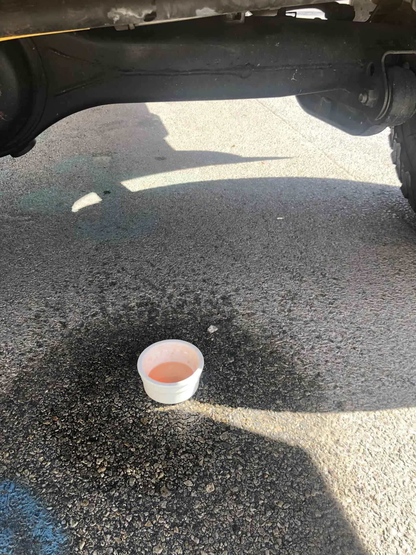

Recently my temp gauge has been flaky- it will bounce back and forth from bone cold to operating temp several times in a 20 mile trip.
Trying to get a feel for where I need to prioritize this with the other maintenance I have. It doesn’t seem to affect driving performance, would the ecu get the signal and dump fuel when it show cold (but isn’t)?
Welp… thankfully I ordered a new radiator yesterday and magically today found a leak… gonna do drive belts and rad hoses, possible a water pump while I’m in there
Thermostat?
