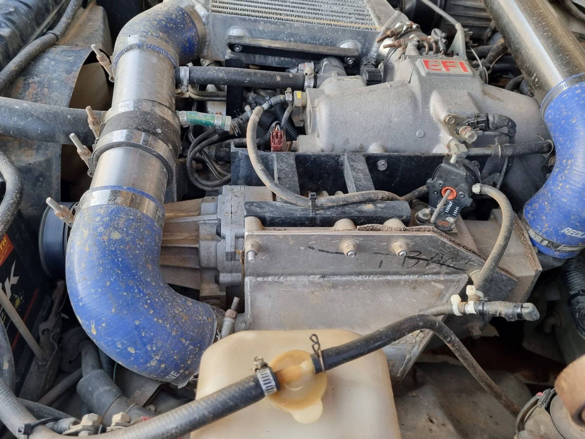

Not sure if I belong here or not? 80 series 3F-E in my FJ62 with a H55 and split-case behind it (And a few other mods such as boooost)
Have any pictures of your turbo manifold?

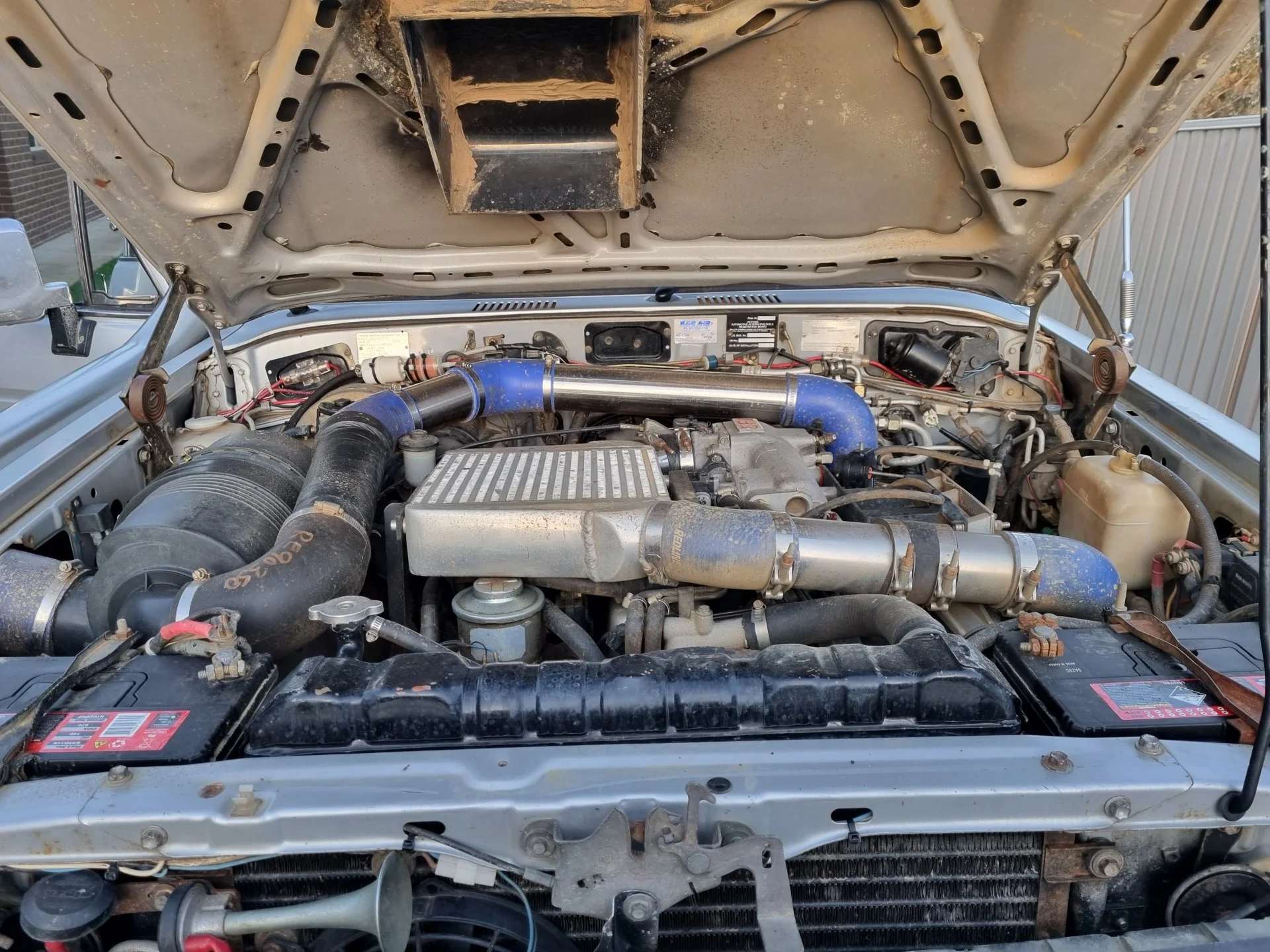

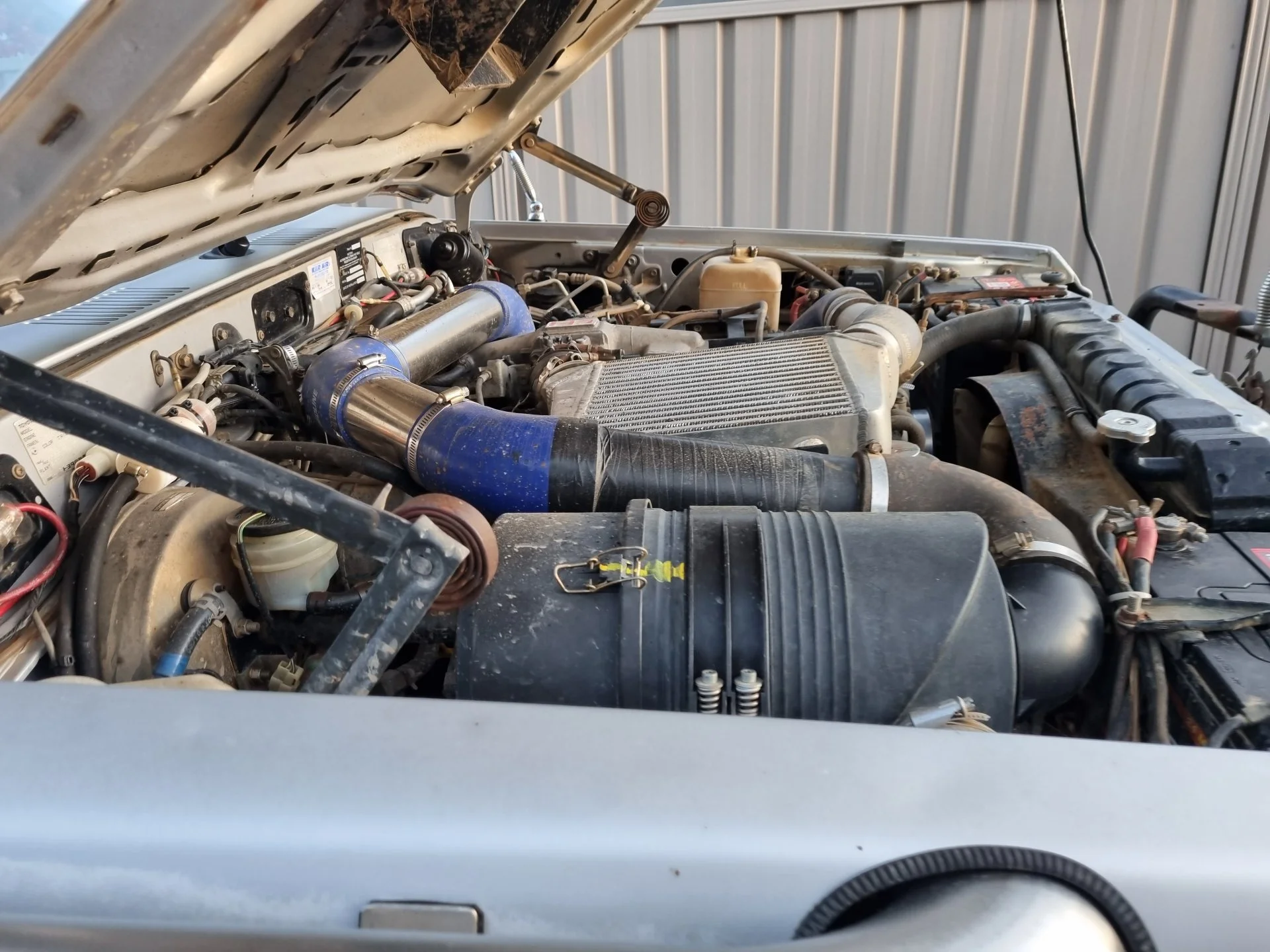

She's supercharged, bit of a list of components below. I'll get some proper pics over the weekend and post if you're interested (I don't like how the piping etc. looks and it's a pain to add engine oil and PS fluid, but haven't yet worked out a better way to do it...)
Eaton M90 - Buick 3.8 litre factory blower
generic intercooler and pipes, can't remember the dimensions
440CC injectors (1JZ/2JZ) part number from memory 23250-46100
Bosch '044' Fuel pump - external mounted
Wolf V500 ECU
LS coil packs - sequential ignition setup (she ran for a while with the factory distributor/coil etc, the LS setup is nice to have rather than neccessary)
Engine is stock from an FJ80, done 230,000 km, about 30,000 of these have been supercharged. Never been opened up, but good compression test (185, 182, 187, 190, 180,185, about 300m above sea level)
Multi rib belt with custom made crank pulley
custom mount etc. to hang the blower off the side of the 3F-E
Hurricane headers
Big donaldson airbox and Stainless snorkel
A few things to think about:
This would be very difficult to do without a body lift, it probably could be done if you could fit the blower lower but you'll run into alternator clearance issues.
An LS swap would make much more logical sense
We never got the 3F-E in a 60 series, only in 80s, and no smog stuff like cats, EGR etc.
A supercharged 3F-E barking through 6-2-1 headers and 2.5 inch exhaust with a resonator and lukey chambered muffler sounds mint
With the factory bypass valve connected to manifold vacuum (I think the Buick engine has a solenoid controlled by the ECU to operate this) I cruise at about 10 inches of vacuum, but the throttle pedal becomes like a 'boost switch' - as soon as vacuum drops slightly it shuts the bypass valve and you've got 8 psi of boost.
Throttle is quite touchy with the wolf, similar to a 12H-T diesel if anyone has ever driven one.
More pics to come

I'm familiar with the M-90, it's a great supercharger for a diy boost setup. I'm super interested for pics whenever you get the time.

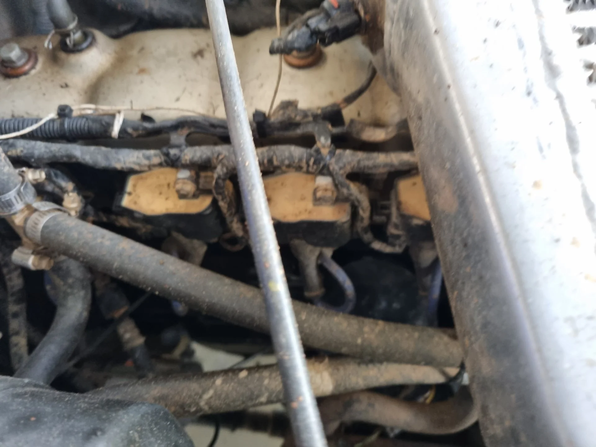

It's pretty cluttered in here but here's a few pics. Please let me know if there's anything specific you want to see?

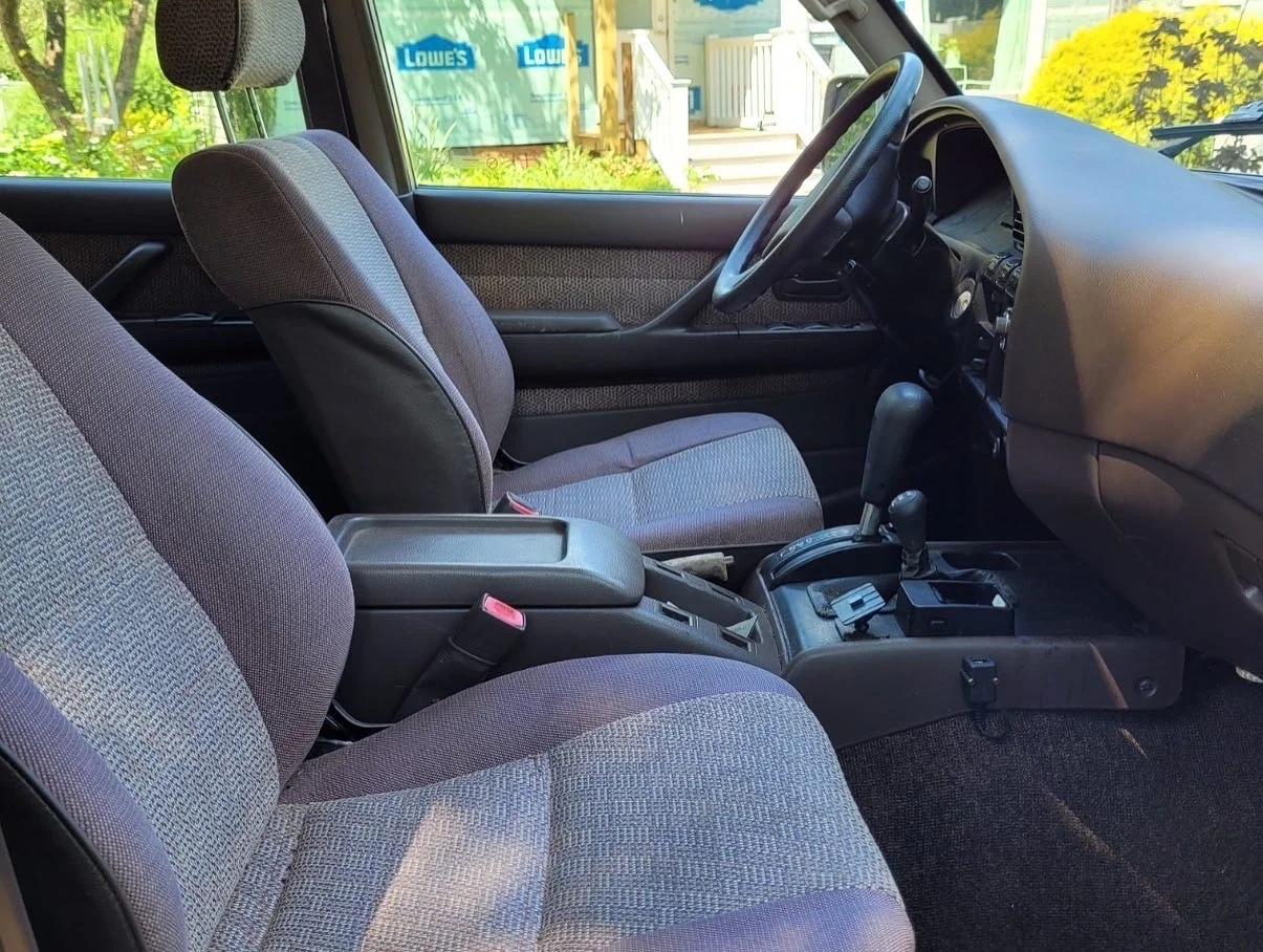

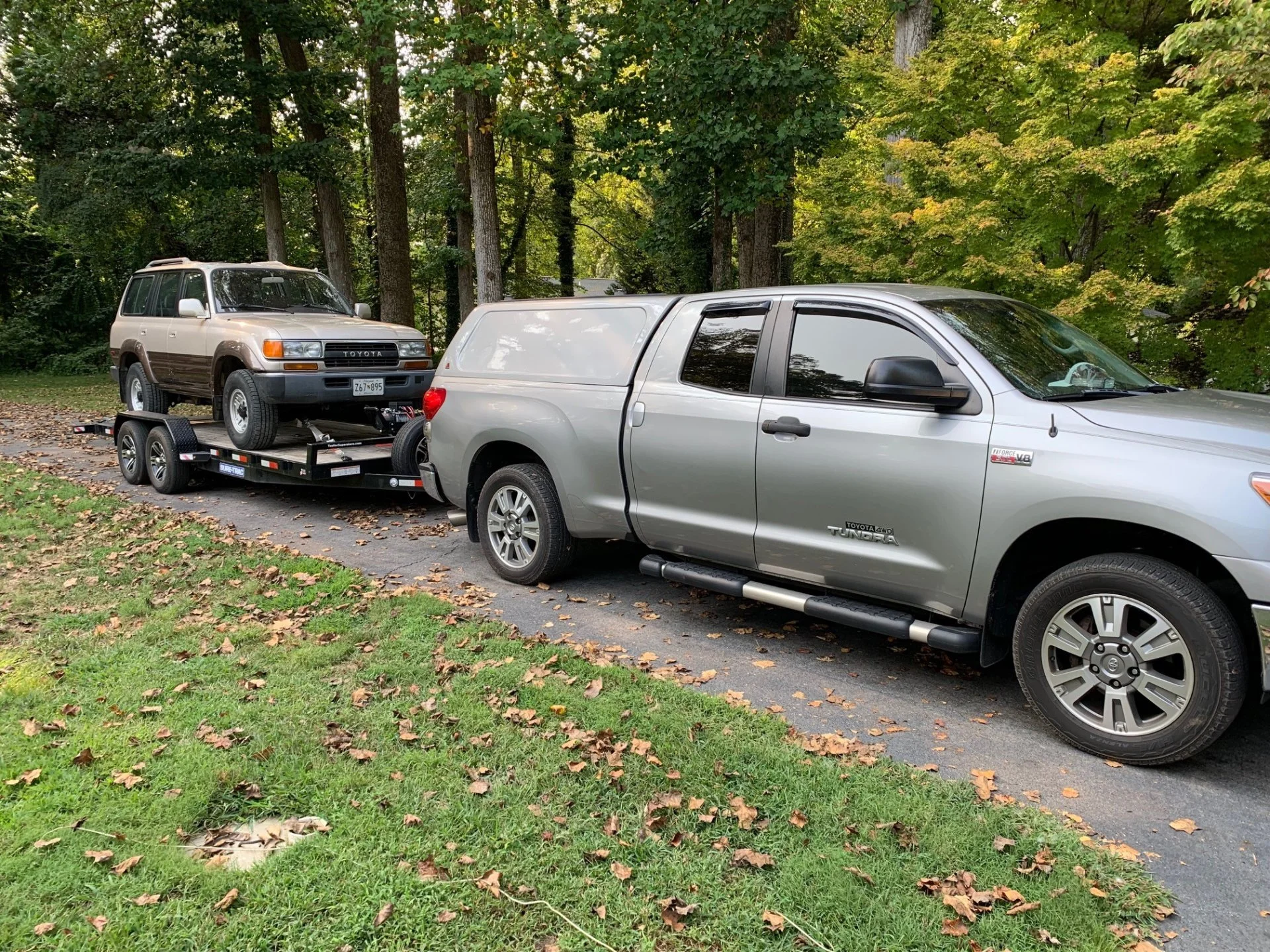

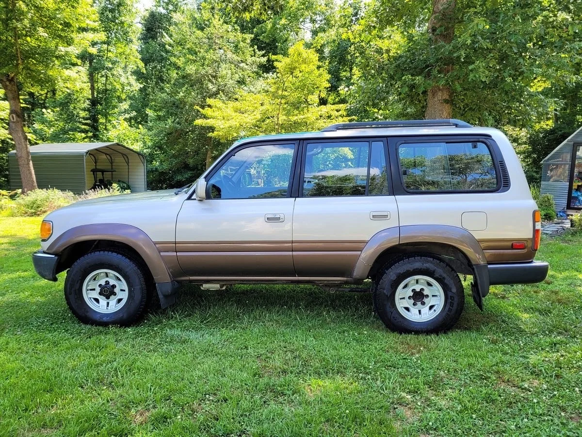

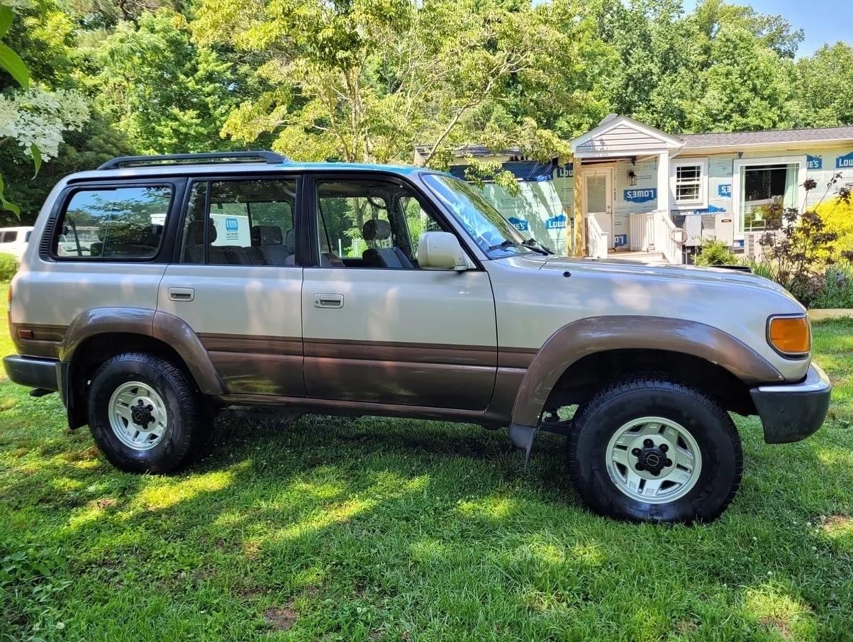

i was driving along and all of a sudden this appeared on my trailer.... at least that's what i told my wife lol. My 98 100 series was lonely so picked up this 91 for a song, 211k, runs and drives like a top other than the v belts squealing at me.

MAN THAT'S PRETTY! Looks to be in better shape then mine, someone loved it! What's your plans for it?
thanks man, ya it has been well cared for. I bought it from the wife of the original owner (who has unfortunately passed on) she told me some stories of how he love this cruiser so much the dog was only allowed to ride in his porsche 924 but not in the cruiser ( he didn't want to get the seat messed up ) lmao
as far as plans for it goes, really just going through an baselining it, taking care of all the little things and getting in perfect running order. Don't get me wrong it runs great but all the belts need to be done and i believe one of the idler pulleys is going bad (i'll tackle that stuff shortly) Tires need to be done due to dry rot and ill be rebuilding the birfs as they are starting to seep
I already have a pretty heavily built 100 series and i dont need 2 built trucks so this one will probably stay pretty mild, slightly bigger tire and maybe a small lift. Just keep it nice and enjoy it

Sounds like you should built this up for a trail rig as 80s are much more comfortable on dirt and not so much in highway manners (compared to 100s anyways)
But what a beauty. congrats.

i completely agree with you..... my wallet does not lol
this isnt my first 80 and i'm well aware that it would out drive my 100 7 days a week and twice on sundays, we will see where the build goes
nice. have you dyno the rig? numbers?
She was dynoed with the blower and stock ignition system, I haven't run yet with the sequential LS setup, and only on 95RON fuel so scope for more timing with 98RON or E85 or something.
102 RWKW and 410 RWNM on 35" Baja Claws, I'm sure there's a lot more in it, just a matter of getting the time to strap her down again!
EDIT - the above figures don't sound like much, but I can assure you, it's a massive difference. Speed-wise, she's fairly level, maybe slightly slower than a mate's remapped and exhausted VDJ79 dual cab, also on 35s. I'd say 0-60mph 10-12 seconds, I need to do a run.
