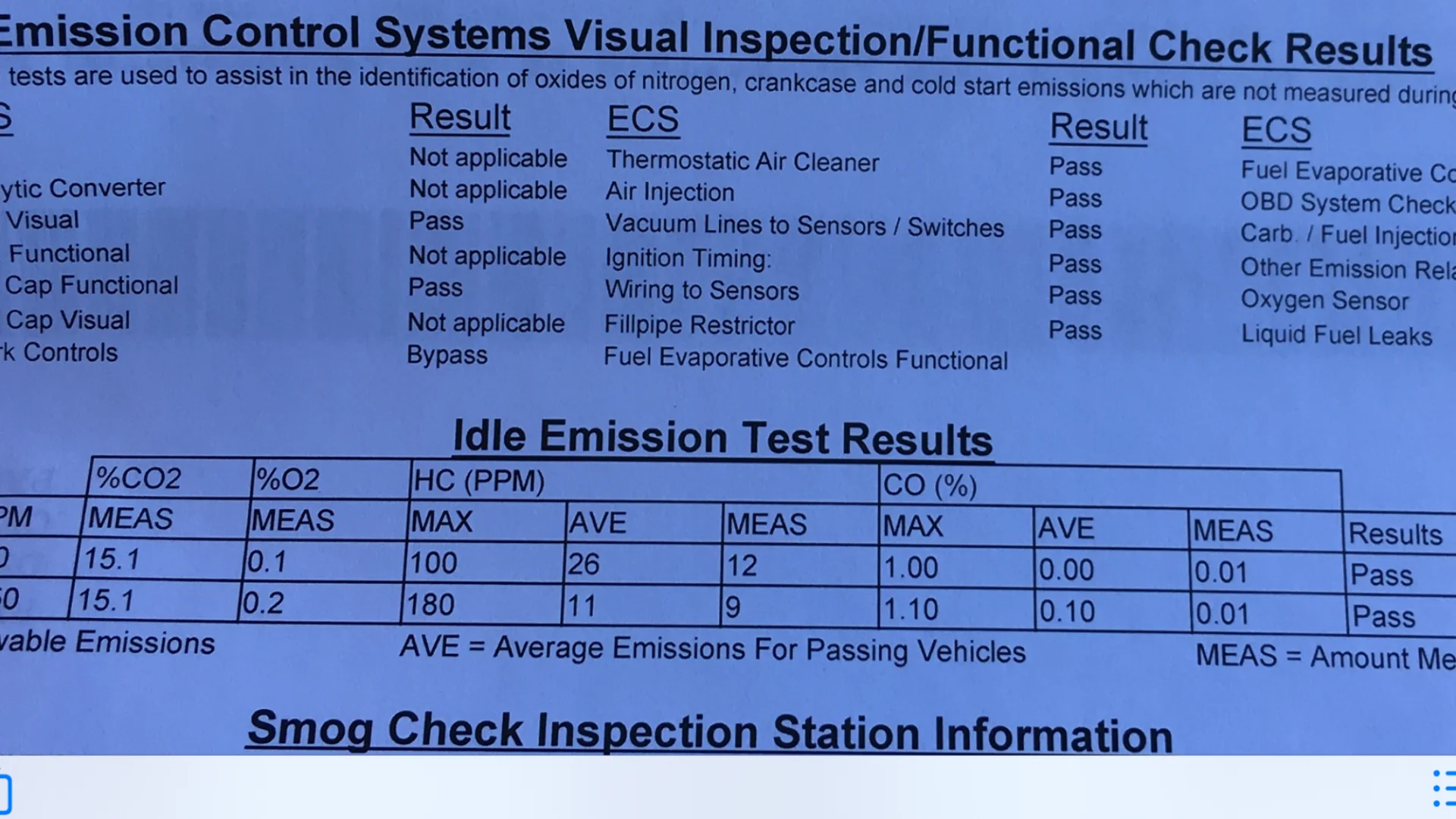

Would valves being out of adjustment cause it to fail at idle like this? I’d rather take my time and do the valves myself since I don’t have a shop in my area that I trust my land cruiser with

Your numbers should NOT be that bad. Look at mine (attached). My bet is that ur EGR isnt closing on idle which is an indication of blocked vacuum. Check the top ports off the throttle body and look for blocked/rusted lines under the intake manifold with a vacuum pump. Help-25/26 code on 3FE - https://forum.ih8mud.com/threads/help-25-26-code-on-3fe.340715/

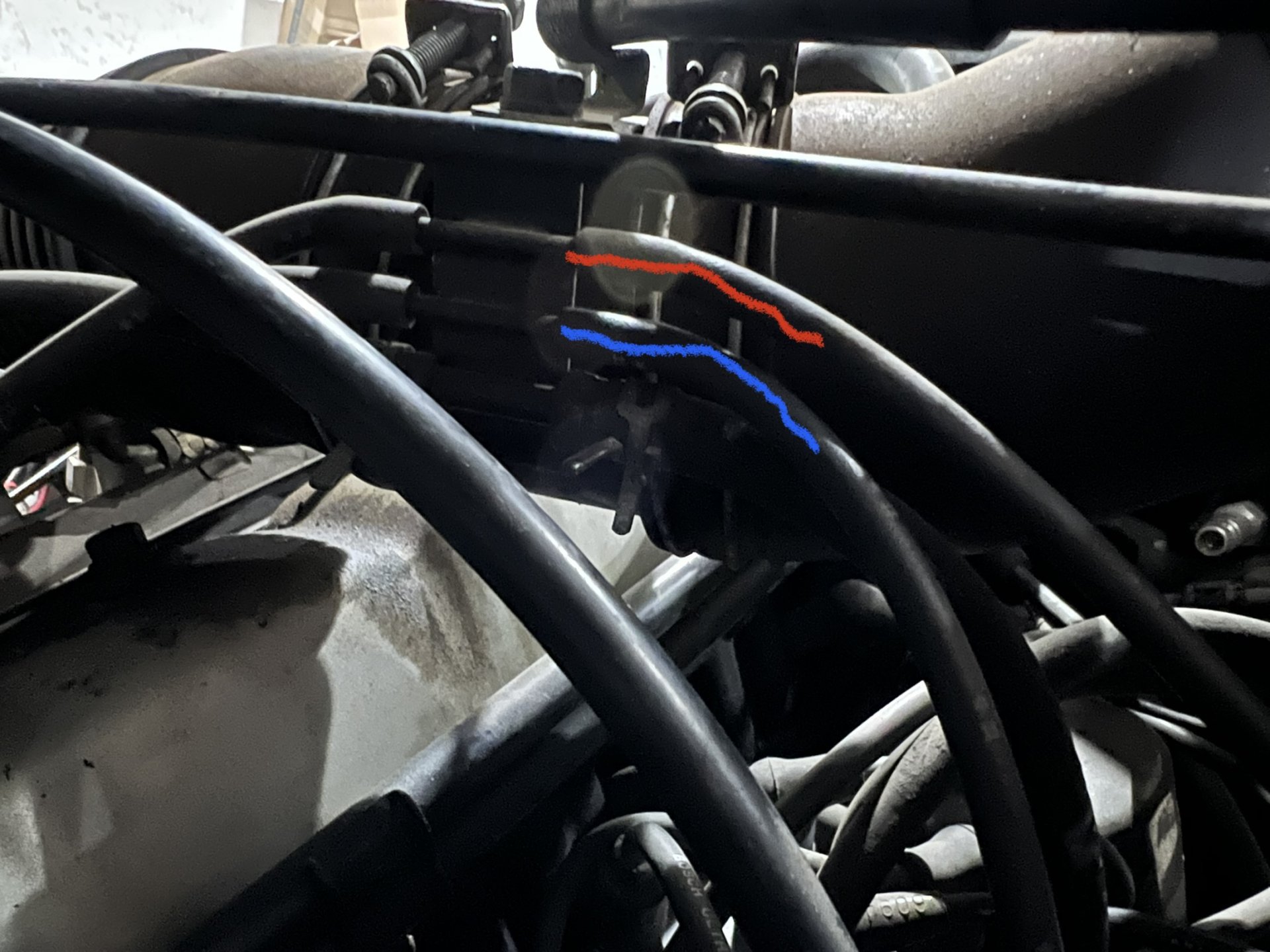

Well all the egr system tested good. But going through vacuum lines, I believe I found to that were crossed. I believed these 2 (red and blue) were switched. The blue one was going to the air filter housing but was supposed to go to the charcoal canister. I switched them and it fixed the wanted to die when coming to a sop issue. What do the mud experts think, would that have caused my failed smog test?
I would think that a fuel vapor line designed to go to the charcoal canister going to the air intake instead would contribute to issues with emissions testing. It makes sense to me that adding fuel vapors into the intake side of the system certainly wouldn't help. Just trying to think logically, no real experience on my end. I am NOT an expert. Best of luck- It seems you should be close, as the low idle issue appears to be fixed by the swap.

Switching those vacuums lines got me through smog. Time to pull the egr again and enjoy 2 years of a smooth running 3fe. Hopefully in the next few months I’ll get to adjusting some valves and tracking down some oil leaks.
