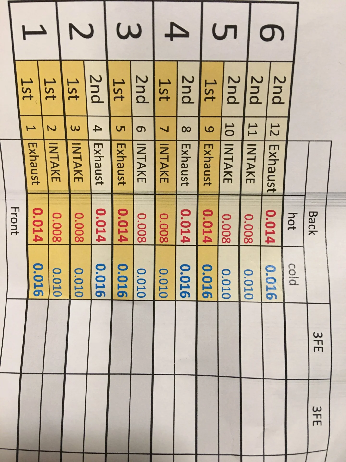

Remove and clean MAF AFM, throttle body and 02 sensors with maf cleaner <~~ easier on the sensors. Test fuel pressure and replace fuel pressure regulator or dampener if necessary. If fuel pressure is too high because regulator is old then the fuel pump will fail shortly. Replace fuel filter with OEM, adjust valves when hot (i like to idle the engine with the valve cover off). See pic for order and numbers. This will bring you up to the 10.5 mpg average range. Do the plugs, wires and fuel injectors (with new rubber orings and round seal x3) if you want that extra umph and 11.3.

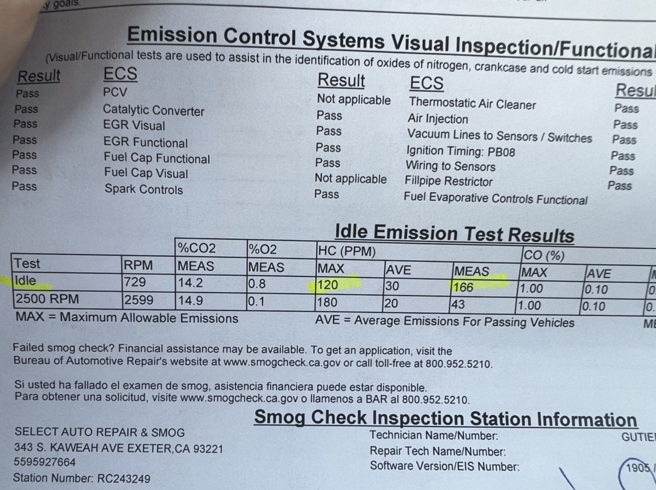

My problem is with my current work schedule I only have a couple hours a week to work on it and I need to get it smogged in the next week or 2 for registration.

Looking at the smog sheet I also noticed that my idle rpm was 730, in gear my idle usually sits around 600 in neutral it sits around 650, I wonder what is up with that rpm reading
Sorry, I meant to say why not get the valves adjusted properly and go from there? It will only takes 2-4 hrs to get them adjusted. Your idle is little low based on your readings. Also get your timing set properly when you get your values adjusted.
Timing is set dead on. The reason I haven’t done the valves is because I don’t have the 2-4 hours right due to work. I’ve never adjusted them before so I’m sure it would be closer to 4.
How much is your time worth? I was in the same time boat, paid a shop $300 to complete. I supplied the valve cover gasket and spark plug grommets to make sure there was no downtime.
I’m in not in California so not sure all the rules, but here if we fail we have a certain amount of time and cost to fix the problem, and once you hit that time you apply for an extension.
If I were you I’d call the number on that sheet and see what all your parameters are to correct the failed test and by when.

My first adjustment went great- it took like 90 minutes
Would valves being out of adjustment cause it to fail at idle like this? I’d rather take my time and do the valves myself since I don’t have a shop in my area that I trust my land cruiser with
