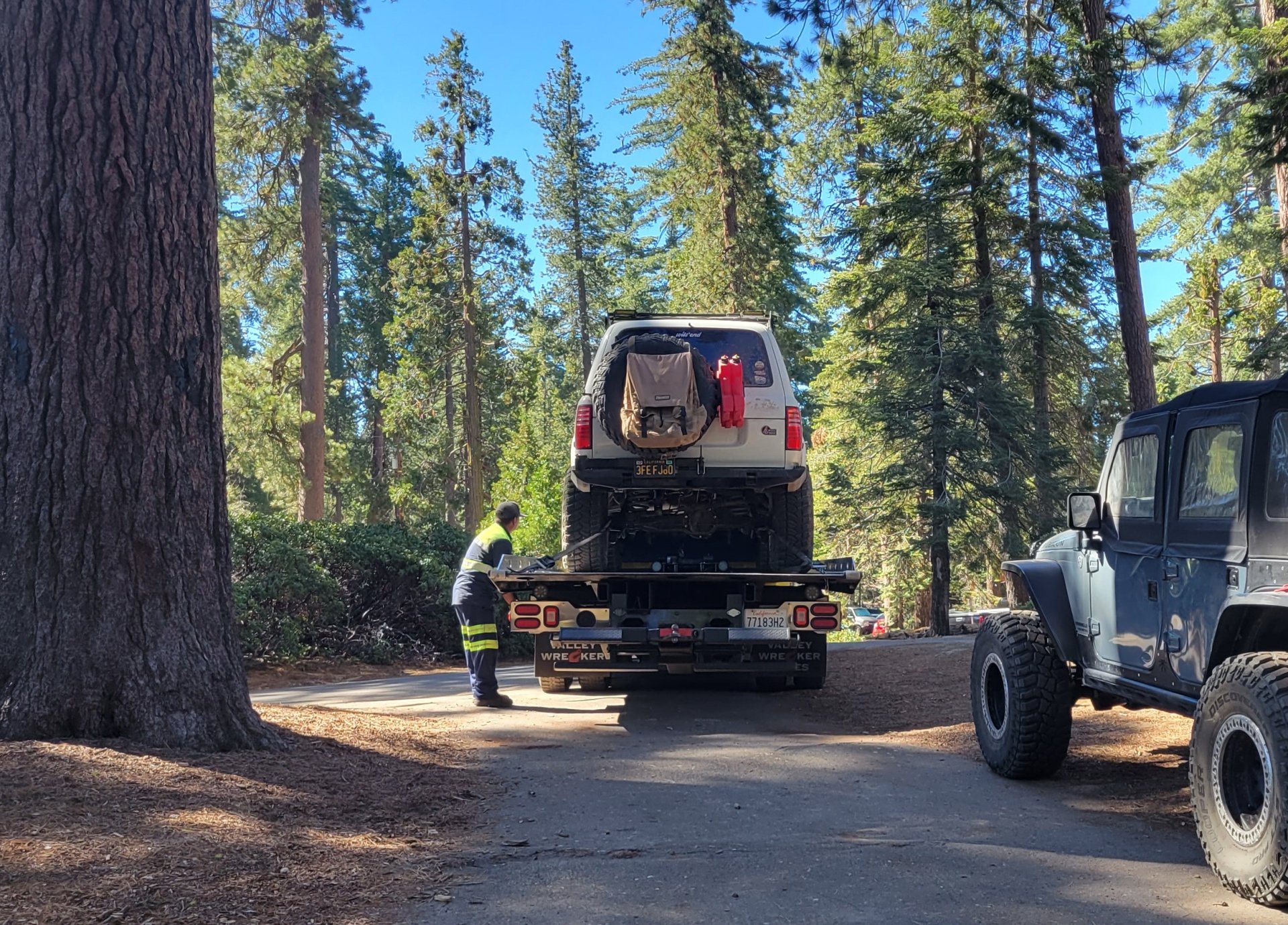

Well, my trip to the Sequoias National Park last weekend wasn't exactly smooth sailing. This was the 4th time in 6 yrs, 2 times with a blown radiator, 1 time with fusible link/grounding and this time what I believe is a bad torque converter. Was pushing the rig pretty hard up 6500 ft/ 300 miles of driving, and after turning into a 4x4 trail, a whining noise from the tranny becomes more apparent and started experiencing gear slippage. I pushed on forward about a couple more miles just to get off the dirt road and campground was not far ahead. Pulled into the campground and lost all forward gear and reverse. Checked the tranny fluid, it was full and no burning smell. Started up the rig and it would grab, had forward and reverse for a while and completely slip and lost all gears again. Long story short, I have started experiencing slight shuddering and vibration for the past few months from a dead stop to about 5 mph, and long delay shift from 1st to 2nd, and not thinking too much of it- big mistake. My rig was running amazing with the WAT nomad valve body upgrade since 2020. I am taking it to a transmission shop to see what they have to say, all symptoms point me to a bad torque converter. I have a set of high/low transfer underdrive waiting to install, so it would be a good time to do it along with upgrading my Torque converter to a Billet HD unit from WAT to go along with the HD Nomad valve body already in the car. Should be a bullet proof setup with close to ~5.29 final gearing with the underdrive high transfer regear along with my 4.88 in my 3rd. Stay tune for more update folks...
Dang that sucks.......

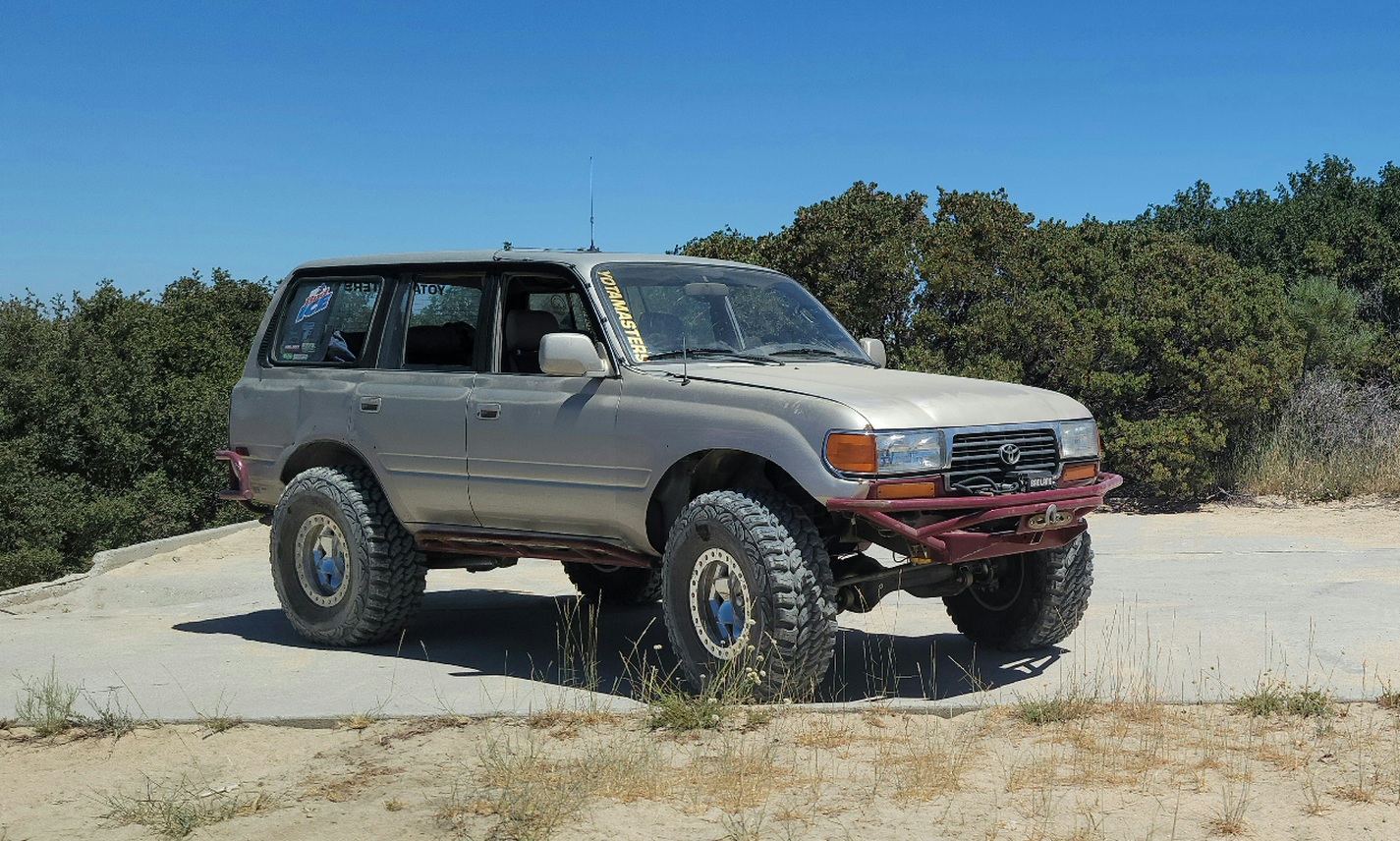

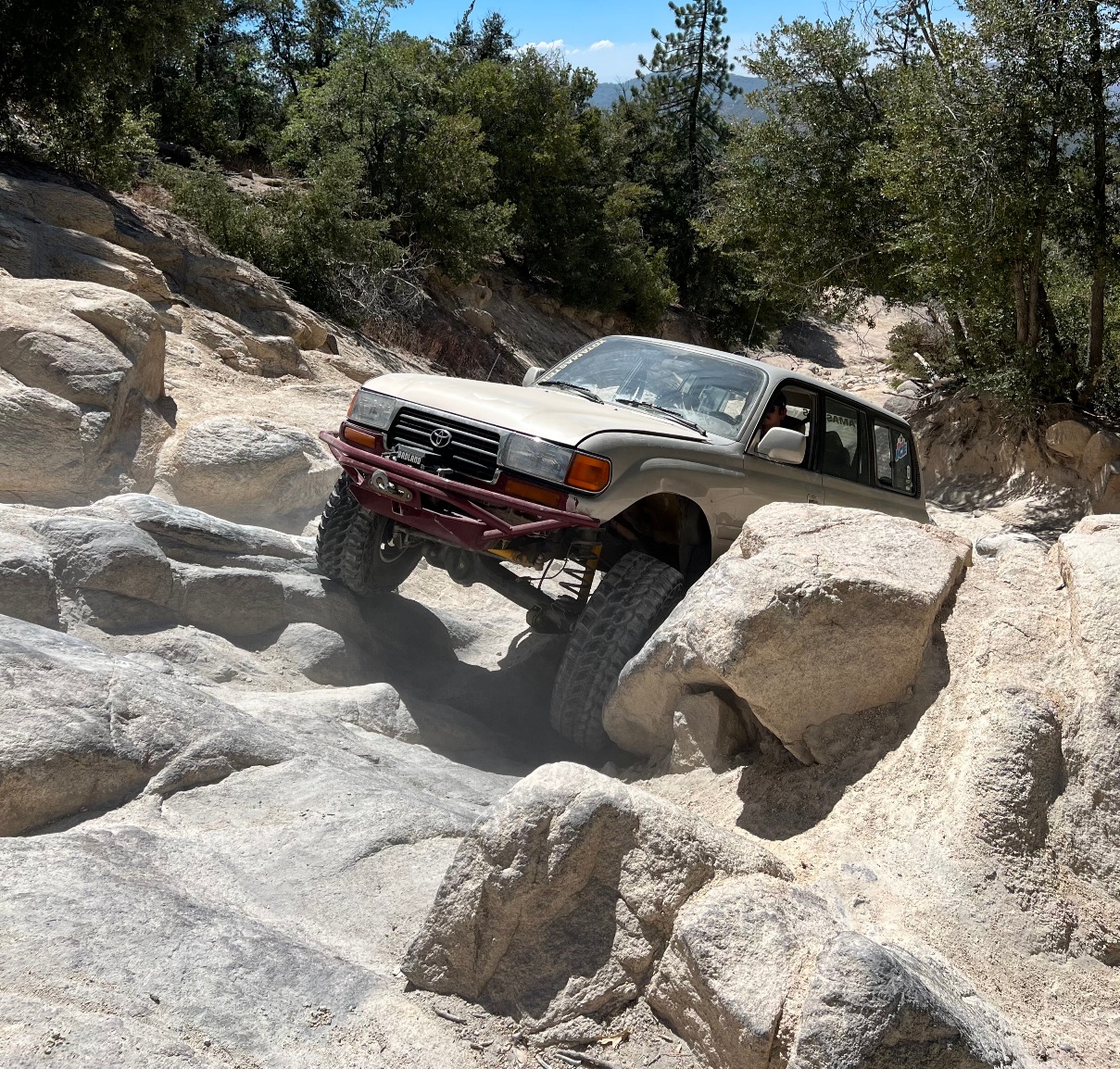

Figured it was about time I added my pig on the check in.
Bought it in 2019 bone stock and it has snowballed into a weekend rock crawler, with the goal being as big of tires and low COG on as low of a lift as possible. I'm pretty pleased with how it wheels right now on 37's and OME 850s up front and 860s rear with L shocks all around.
Looks like the last picture from Dishpan Waterfall? Rig looks good!
