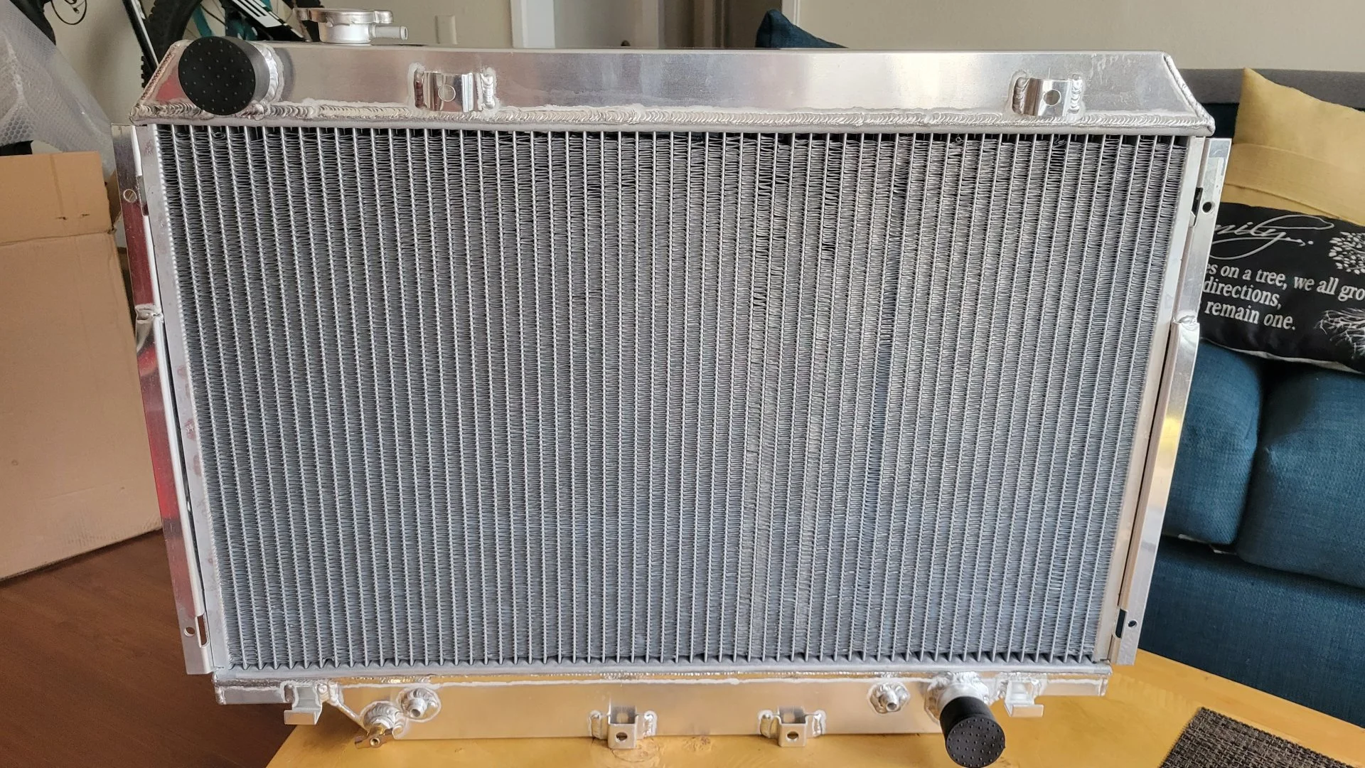

I bought mine from parts geek . Unfortunately they look to be out of stock in the model I bought. P# 8062-05725327.
There are a few other options that looks to be the same build.
Sorry to hear your radiator got damaged. It looks pretty stuffed!

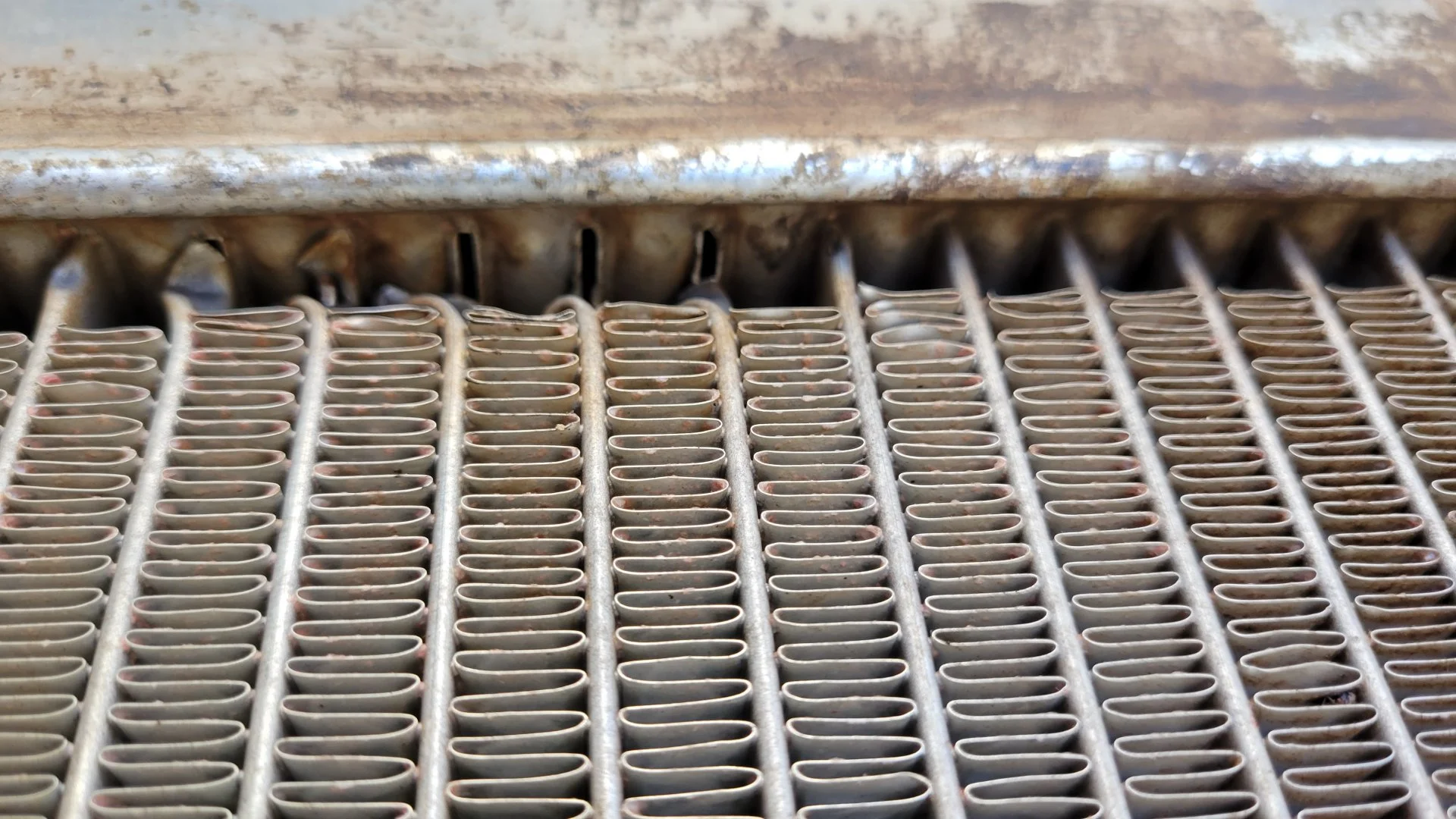

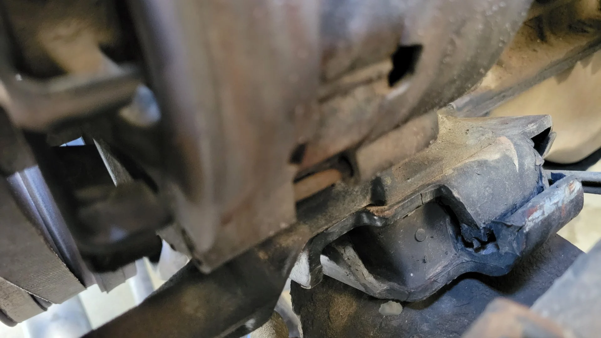

got the Ron Davis out, and now i can see the damage on the top fin just below the top tank. the ebay unit is going in this week while i wait for my new Ron Davis to arrive..but we will see how this one holds up...I am suspecting my motor mount/s are toasted. They were replaced 6 months ago. Can someone take a look at it and let me know if the driver side mount is bad?
TIA
TIA
Marco, mounts look good, no cracking at the rubber to steel junction. I’m running a LiLand rad for 3+ years and it keeps the temp down in the summer months going uphill, with the wind, loaded down, in first gear.

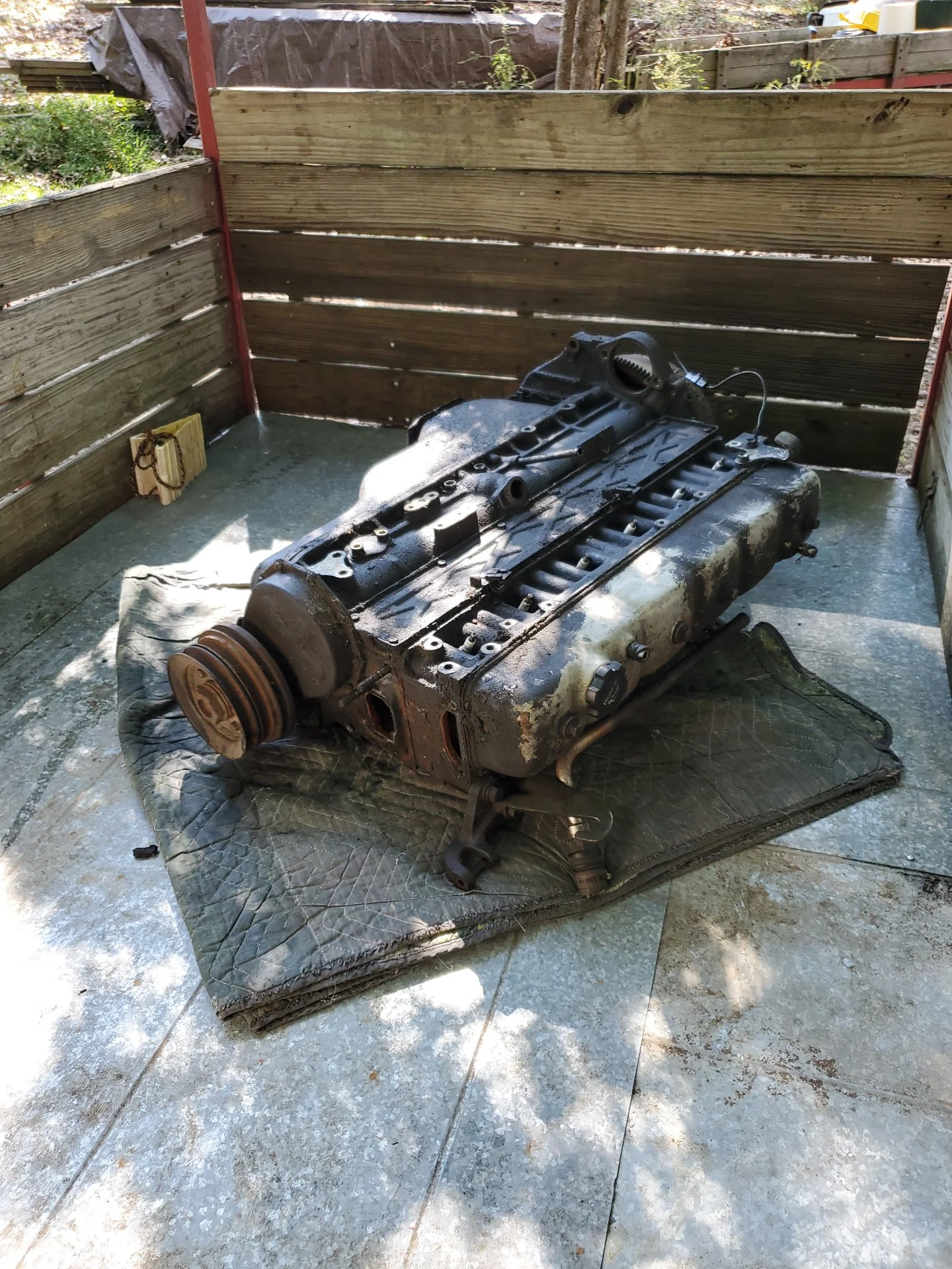

Excited to have this donor. Planning to evaluate and hoping to swap this in for my knocking original with almost 250k. This one was supposedly running good and with under 100k miles when it was pulled, so fingers crossed!

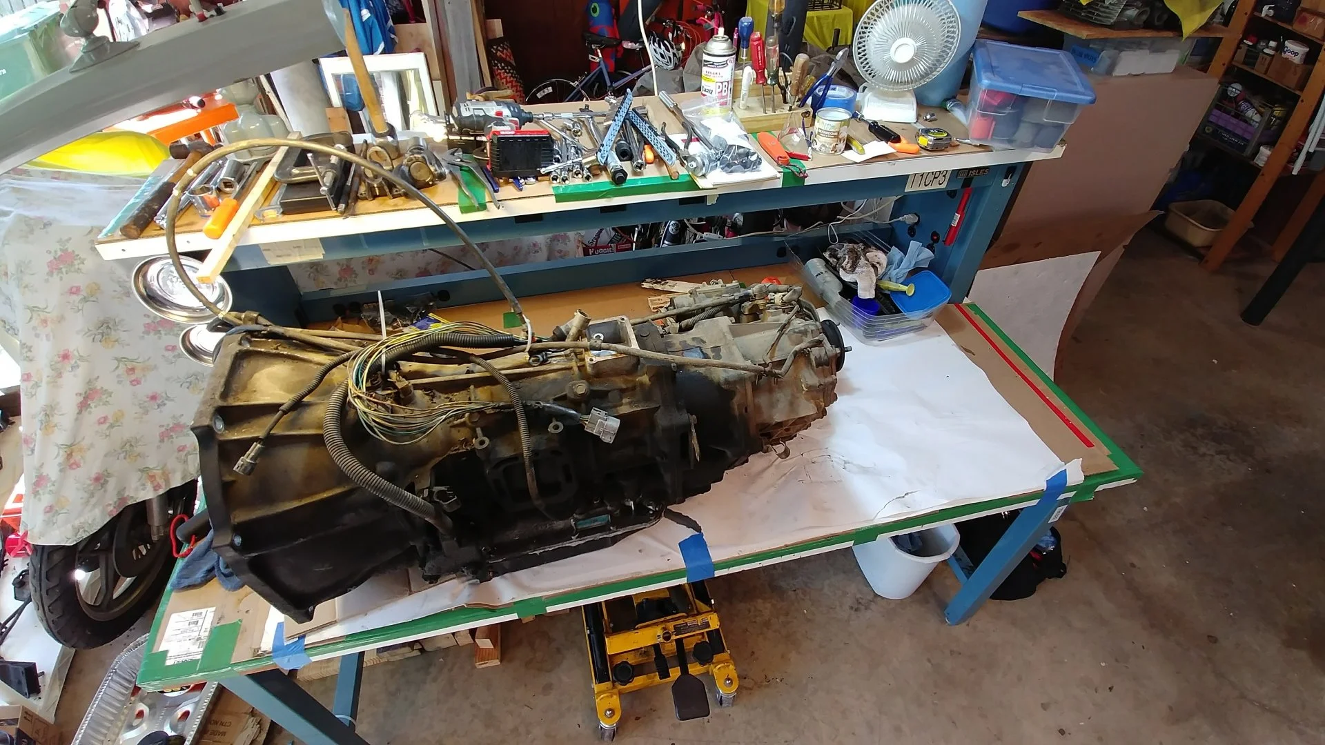

True statement, though I call it a highly educational failure.

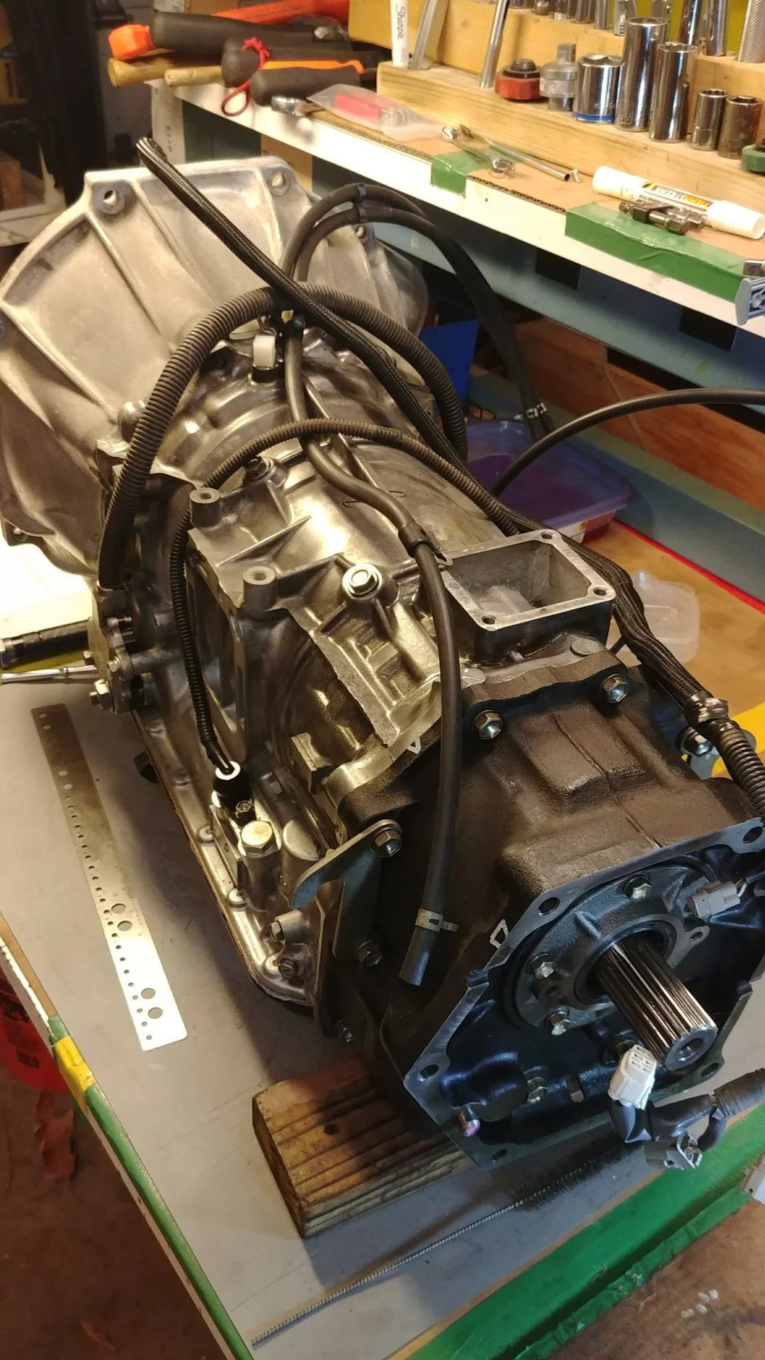

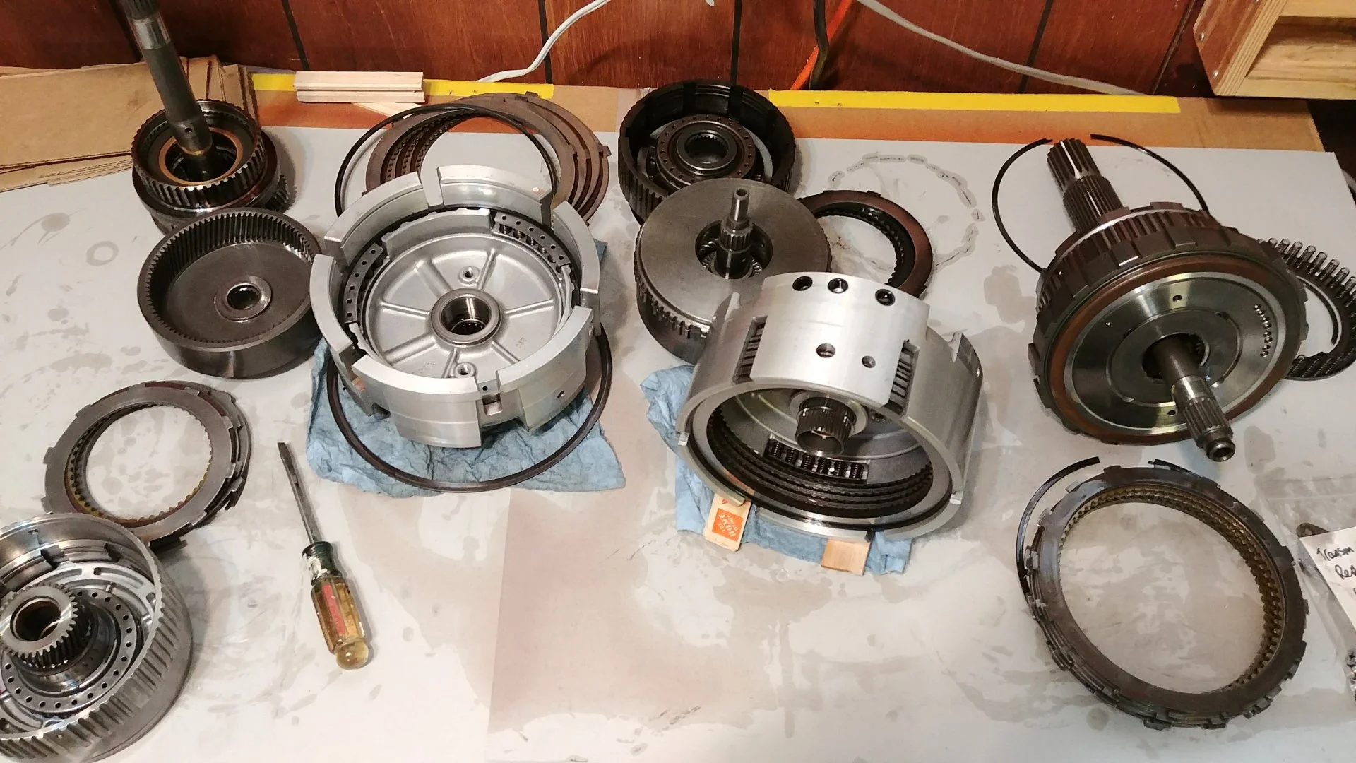

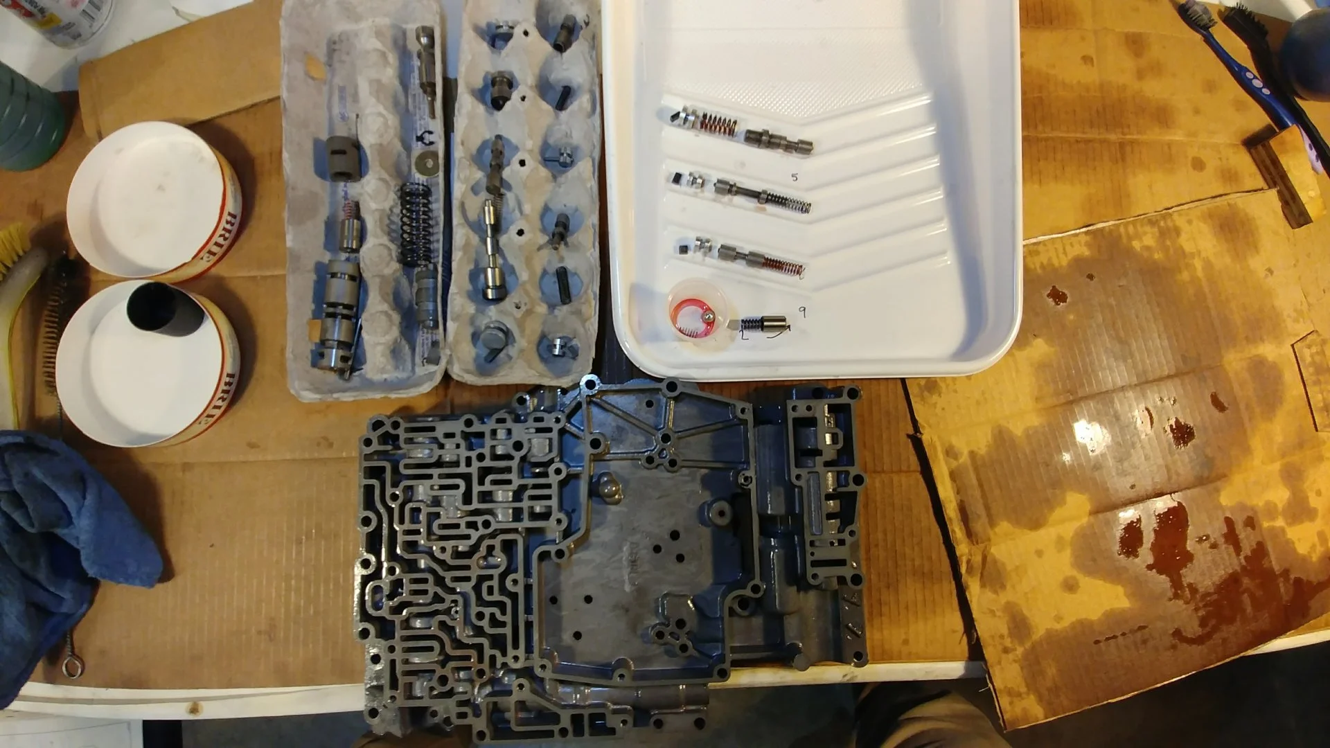

Short version - After a weird lurch and terrible burning smell, truck wouldn't go in 1st or reverse. Pulled the trans, did the full rebuild, confirmed the fried 1st/Reverse clutch, did a bunch of stuff under the truck "while I was in there" (driveshaft bearings, rear main seal, full starter rebuild, oil pan gasket, can't remember what else), put it all back together and viola! I had first and reverse. BUT, the truck wouldn't shift out of 1st on its own and wouldn't shift beyond 2nd at all.
I actually convinced a pro to troubleshoot my failed amateur rebuild. His best guy checked it, then he checked it himself, couldn't find my mistake... and he eventually found me a working used A440F. I assume it was a valve body issue, but I'll never know for sure.
Like I said, educational, but I don't think I'd do it again, not on an A440F. That said, the idea of an engine rebuild or swapping in a manual transmission seems pretty straightforward after that.

I had a similar experience with my first 700r4 rebuild. Ended up fixing it somehow by removing and cleaning the valve body 4 times. This was 15 years ago and to this day I don’t actually know what I did to fix it.

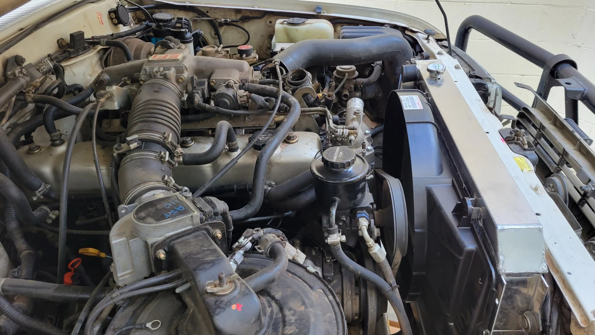

thanks for the info. I just picked up a Liland 3 row this morning. The ebay junk i received as a temp. solution showed up with the brackets orientation incorrect so i had to return the unit. I am exciting to try this radiator out and if things go well, i might just run this vs the Ron Davis....but time will tell.
got the Liland unit installed, got new thermostat, housing, hoses, fan shroud and bits and pieces. just need to hook everything up again, flush and test the unit. I hope this unit works good.
Yes. Fingers crossed that is going to work for you! Do you see any immediate differences between this one and the last? It certainly looks the part!
The Liland unit aint no Ron Davis....but after seeing it in person, it is much better than the Ebay ones from China. I will have the rig running by end of the week, just need to button stuff up and do a flush and see how my temp looks. I will report back. If this unit can pass the street and highway test, then i will take it on the trail and see how it does. I am hopeful i can rely on this unit and not $1400 ones.
