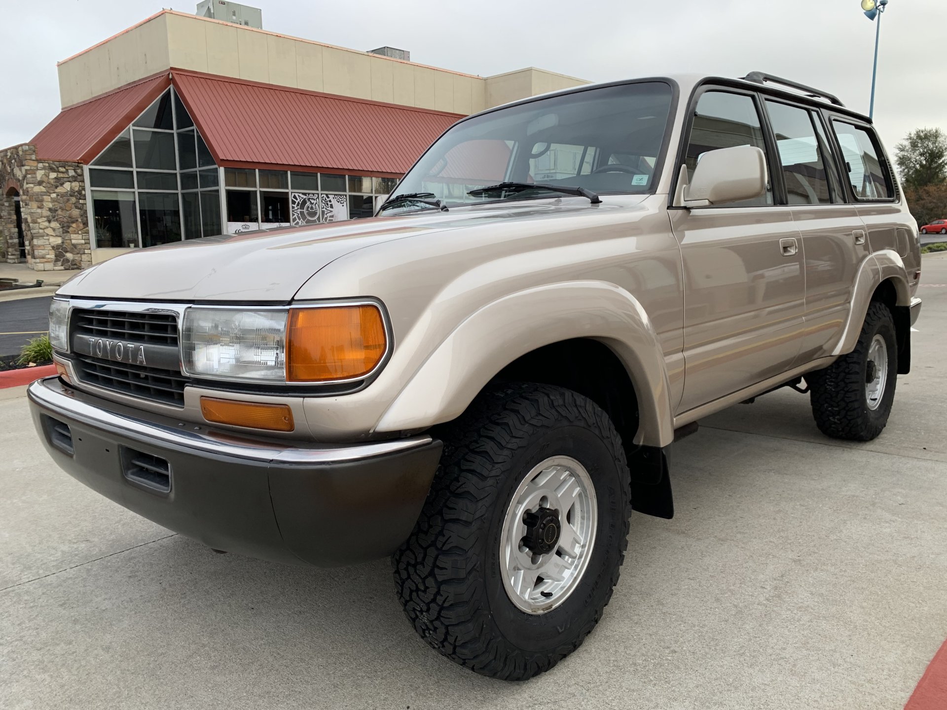

First post. I'm the proud new caretaker of this 1992 3FE. The BaT sale didn't go through (missed it by $750 there) but I saw it again on eBay couple months ago and jumped on it. I think it was meant to be and very pleased overall. Not my first Land Cruiser (94 FZJ) but probably the last. Always regretted selling the 94, so excited to add this one to my small vintage car collection. Tires were sixteen years old--I drove it less than two miles after picking it up and put new 31X10.50 15 BFG A/Ts on. Already done a few small things like greasing windows for quicker movement (great YouTube videos for that), and installed new WeatherTech mats. Basically going to enjoy as is and preserve the wonderful patina on this very original, rust free, California FJ80.

Wow fantastic rig. Thank you for sharing. I followed this truck on BAT. I guess that some sales just do not come together for some reason. These basic 3FE's will have their day. This looks to be one of the best in the country. Great choice on the new tires. The BFG in this size is perfect for the 3FE. Glad to see it will be kept totally stock and enjoyed as intended.
The Land Cruiser has become kind of like a stock 50 mercury as most have been customized and abused in the name of overlanding. The stock trucks are now the exceptionally rare site on the road.

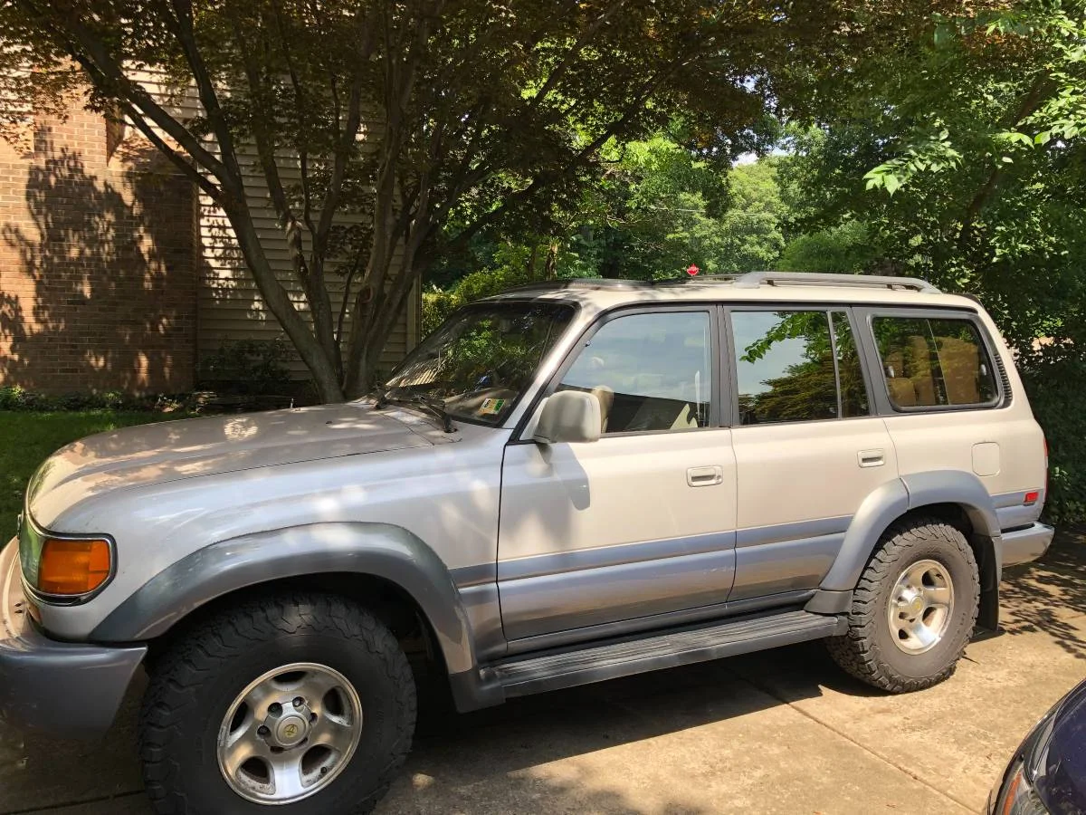

Picked up this 80 series a couple of weeks ago locally in VA. Very light rust, everything except the antenna works well. 171K miles..
Interior is pretty good, needs clean up, thinking of carpet removal and wash or full replacement with stock interiors.

Just received my stockinteriors carpet with mass backing. I like the quality though there will be cutting involved.
