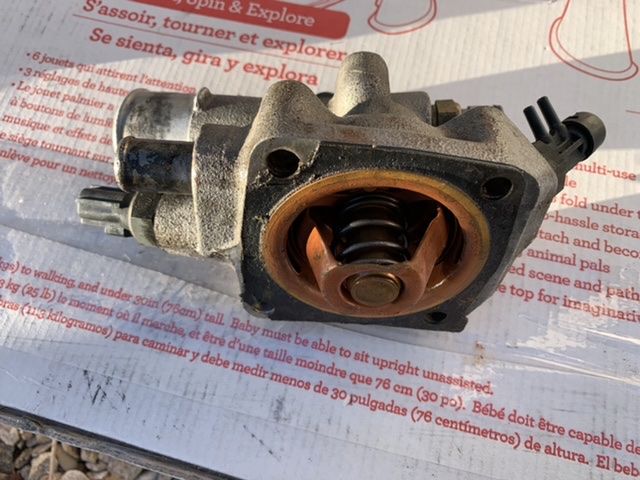

Thermostat won’t come out of the top sandwich housing. Seems like it’s stuck to the gasket. Looking at the new one there’s nothing that should be catching, so do I just break the gasket and pry up?

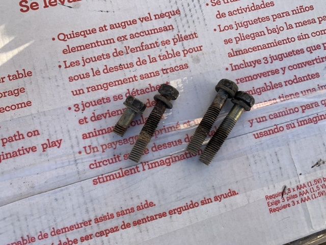

One of the bolts sheared off. Since I can’t get to this until next weekend my plan is to hit it with pb blaster every day and try and use pliers to spin it. If that doesn’t work, any suggestions?

Thermostat won’t come out of the top sandwich housing. Seems like it’s stuck to the gasket. Looking at the new one there’s nothing that should be catching, so do I just break the gasket and pry up?View attachment 2599598
Heat it up! Then, vise grip it back and forth if you have enough grab on it.
Same broken bolt on my 91. I had 3/8 inch to grab on to. Lots of heat did the trick. If you don't have much to grab try slotting the bolt shaft with a dremel and use a flat head impact screw driver. Otherwise it is a drill and tap.
