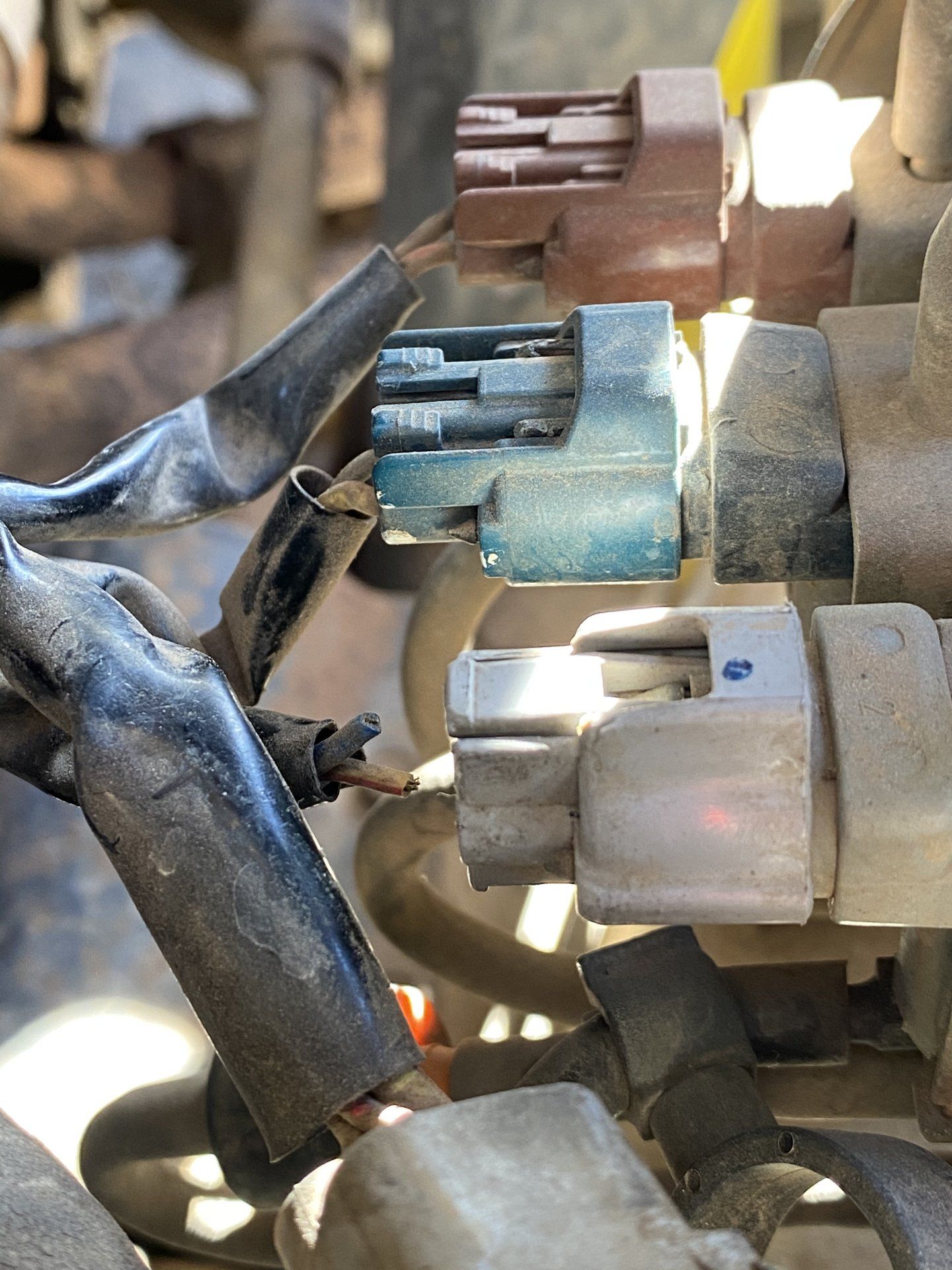

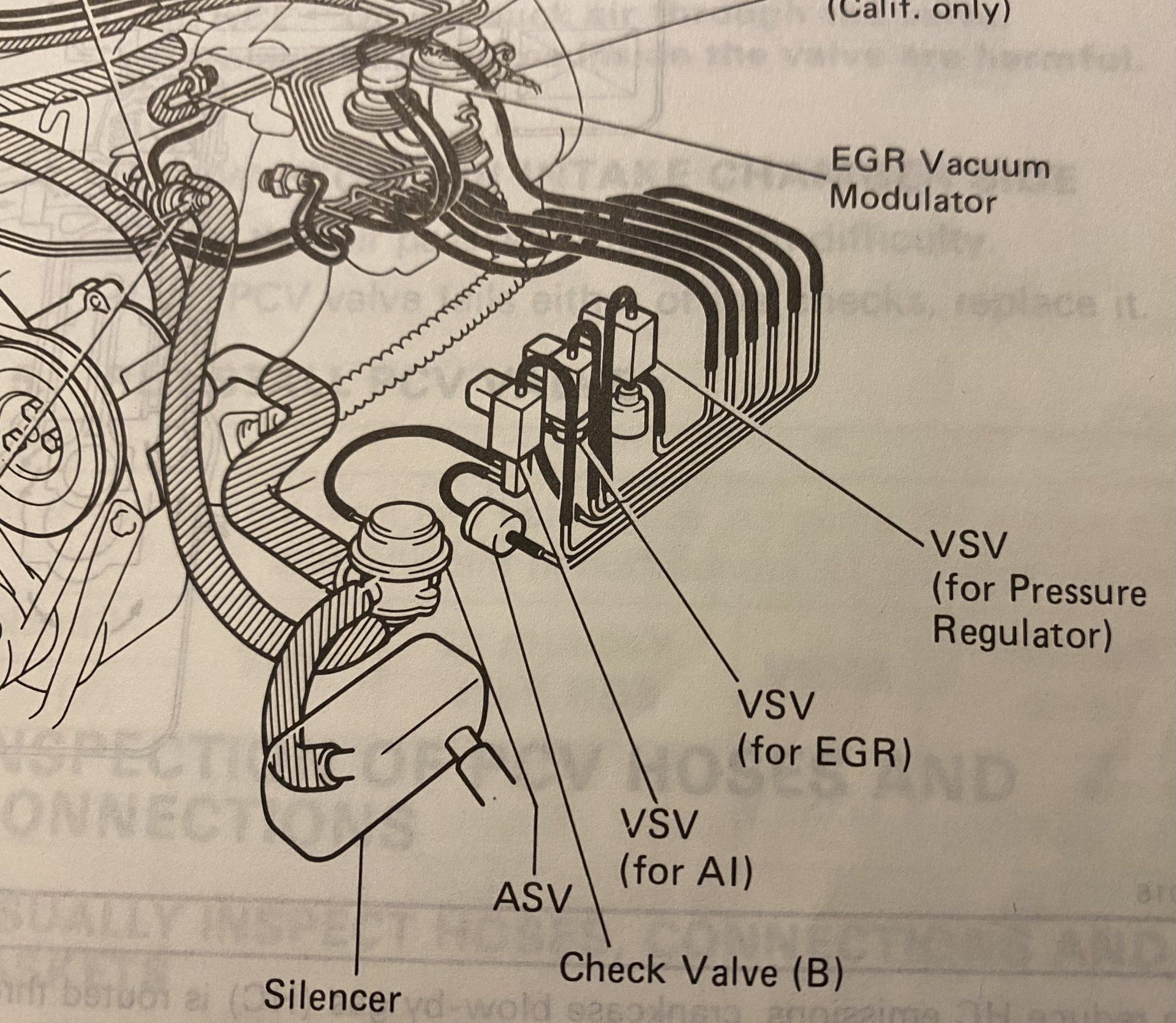

I noticed today that the wires to my “all” vacuum switching valve are severed. Anyone know what symptoms may arise from a disabled VSV?
I be
That is on my short list. Going to do a fair bit of research to see how to do 8t right.
Do you have a pic that is easy to post?
I believe when you DESMOG the 3FE. the VSV will render inoperable anyways...once the vacuum lines are pulled. you can use BB inside the vacuum lines to keep it stealth, i just leave the entire nest as is....

Checked my harness by the EGR and the loom was removed, and one if not more have been cut and reconnected. Not sure if something happened from the PO or what.
