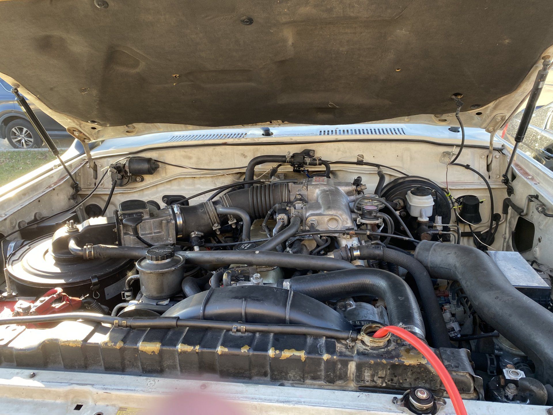

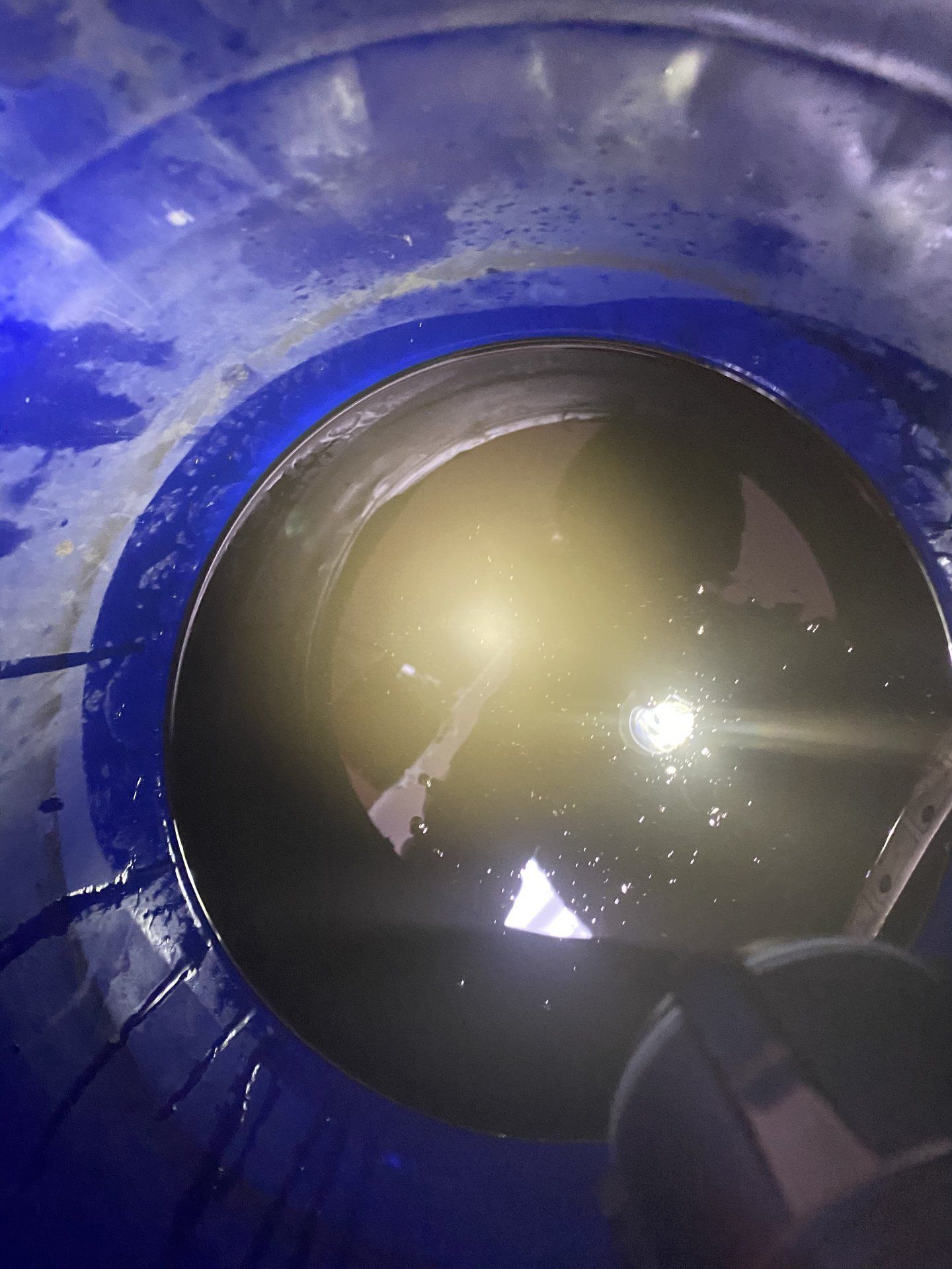

Well I picked up a 1991 FJ80 for what I thought was a good deal. Zero rust California/ Texas Truck. Previous owner claimed that the engine had been swapped and has paperwork for Head gasket replacement and engine swap. Got it home only to find oil in the coolant and cloudy engine oil. Swapping a new triple core radiator in tomorrow and flushing the system. Previous owner is adiment that it’s just residue and left over from the swap and repair.
You guys tell me how screwed I am? What should I do?
Can't tell yet if you are screwed. Flush coolant like you said and maybe do a couple oil changes and then check. So engine was swapped and then head gasket was done? Even if gasket needs to be done it is doable or finding another engine is doable without bankrupting you. About how much did you get it for if you don't mind sharing?
Your truck looks pretty nice though.

Thanks overall condition is pretty solid, old man emu lift and shocks, interior is in decent shape. Yes so the engine was supposedly swapped and had some overheating issues, so it was taken in for a new heat gasket and machining. I drove it for 3 hours home with no overheating or issues. Previous owner is saying it’s residual and with a couple flushes it will clean out. I paid 5500$
if flushing works then you got a nice truck for a good price.
In the Denver area it seems like that truck would go for that price with a known blown engine. I would still feel good about that price for the condition and accessories it already has.

If coolant has been in the oil for a while it can break down the rod/main bearings. I would probably pull the oil pan and check a rod and main bearing. If they look bad I would replace them.
I’ll pull the pan tomorrow and see.

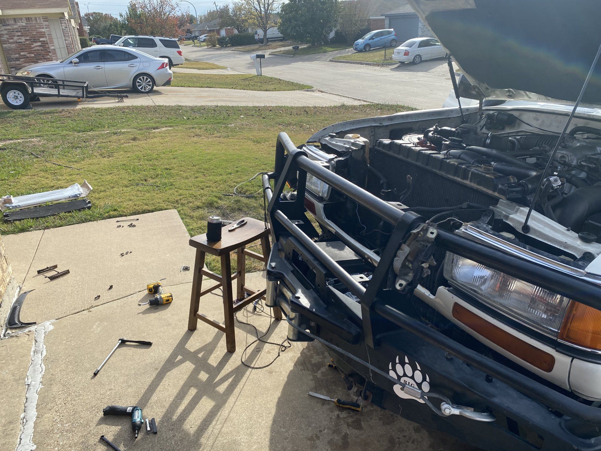

Got the front end off today. Taking the radiator out with the fan aground in place is a pain in the ass but I did it. Have new AC condenser and radiator that will go in. I know there’s a ton of information on these forums. With the rad pulled off what other preventative work should I do? Gonna replace the belts while I’m in there. Any advice for re installation of the radiator? New fan shroud maybe?
Maybe replace the fan clutch, thermostat, and water pump, along with any hard to reach hoses.
I use Asian red coolant made by Zerex, used to be able to get it from Amazon...if your doing a radiator and block flush, you should be able to use normal green coolant. For Socal, i use 60/40 mix and a bottle of water wetter..
Thanks Marco. Bought some 50/50 at Puente Hills Toyota.

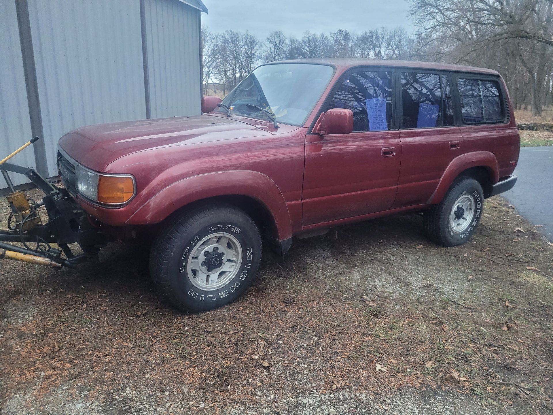

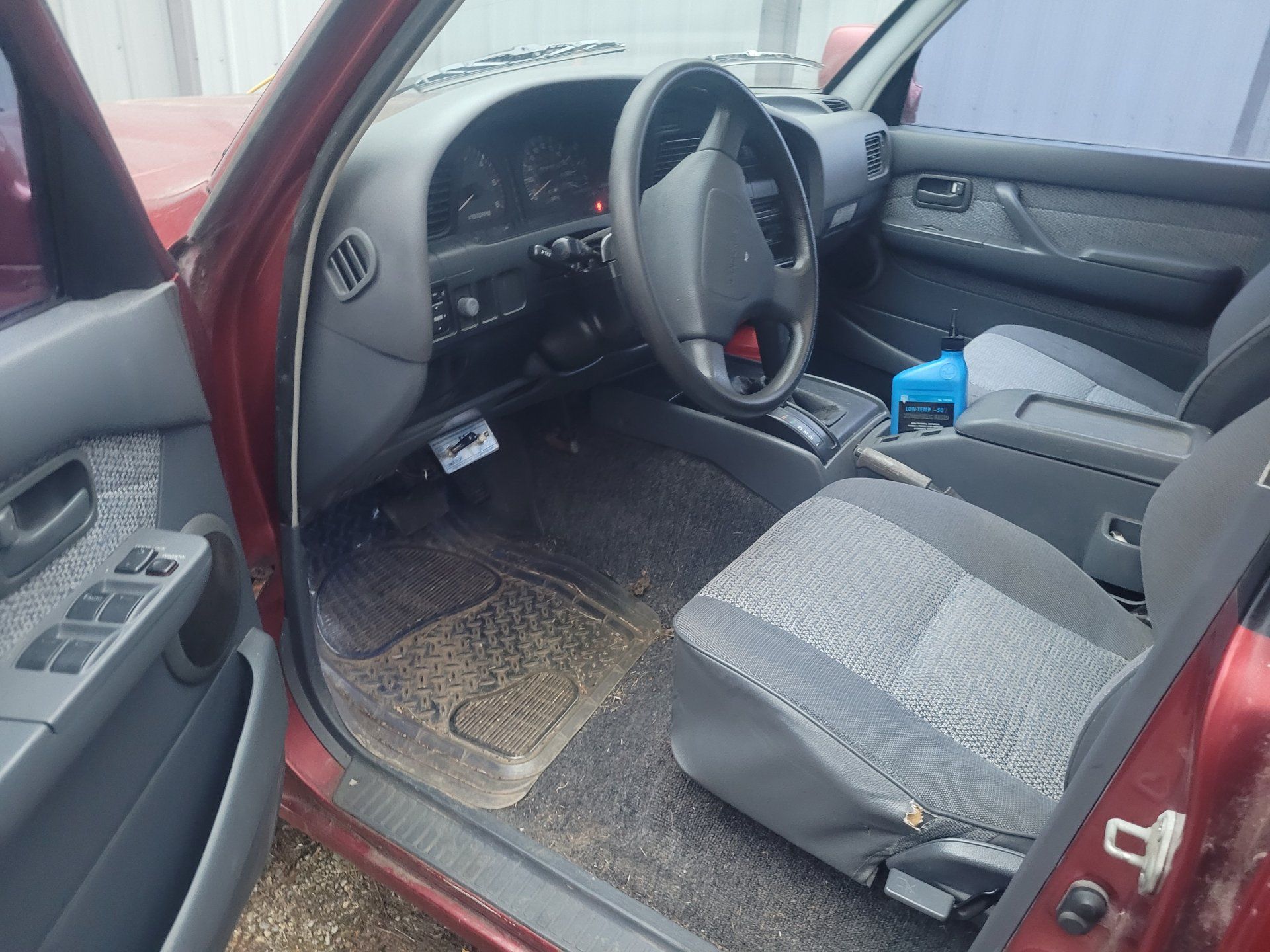

Just bought my 3rd 80 series. I have a habit of buying a derelict 80 series dropping bunch of money onto it then selling it for less then what it is worth. I hope this time I learn my lesson and keep it. The good is there is little rust. The bad....well let's just say I am going to learn a lot about the 3fe.
I think the sign says it all. This is basically a farm find that need everything but a moter and tramny...I hope. PO said he drove it about 1000 mi sense he bought it in 2003. It just sat in his barn. He put a plow on it in 2017 when his 1987 Toyota truck fell in half. The PO was moving to down size so did not need the LC anymore.
For $1600. I figured it was worth a shot.
Please chime in and tell me what a fool I have been.
Just FYI. My budget for parts is up to $10k. I am going to need it.
