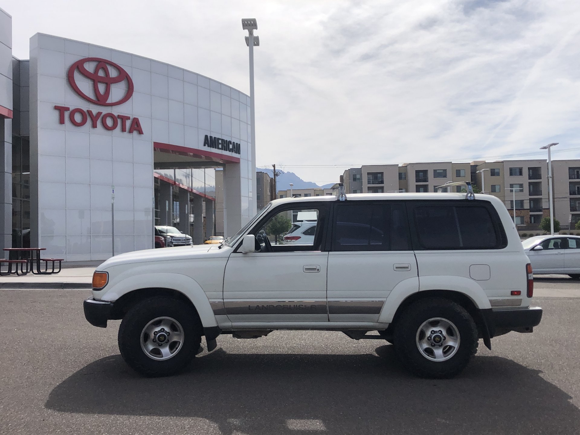

My wife @CatskillsRunner and I are joining the 80 series fray again….
08/1991 (MY1992) FJ80.
Picked it up from Northern New Mexico and of course had to make a pit stop to my old stomping grounds….
Lots of restorative work coming up on this survivor. Future plans (once 3F-E or the A440F craps the bed) will be a 2UZ swap.
Looks sweet Onur. Glad you are rejoining the 80 crowd. Details on the survivor - poverty pack? Look.s like it has the 16" alloys which is nice. Looking forward to what you do with it.
Lots of things will be happening with this truck. Incrementally.
I’ll be starting a thread on it later and outlining our plans (after 7 years of no 80 series and many, many years of experience now behind me).
I should clarify: this is my wife’s truck. I am merely project manager, parts procurement and labor.
She will be driving the direction of the build 💯
