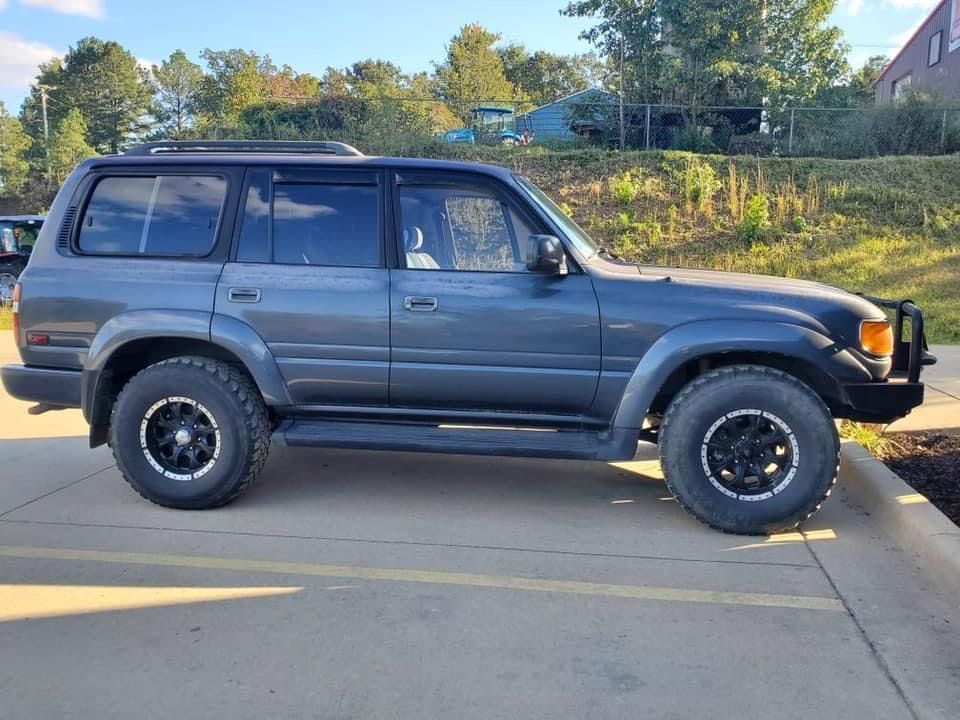

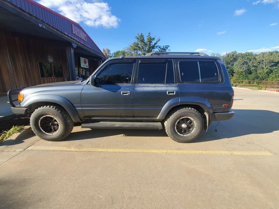

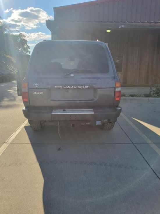

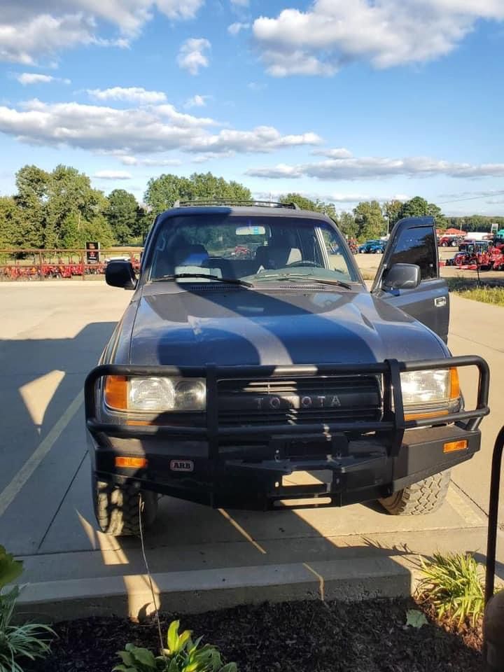

Just picked it up a couple of weeks ago.
Pulled off the running boards and fixed the passenger rear window and replaced the drivers window actuator. Oil Change and she runs like a top. Had to replace tires and wheels due to neglect from PO.

Nice setup.
What exactly did you have to fix with the back window?
Just wondering as I have an issue falling off the rails and wondering what others are remedy with.
