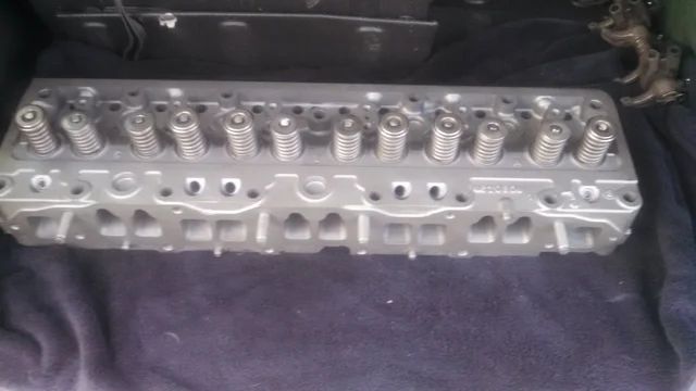

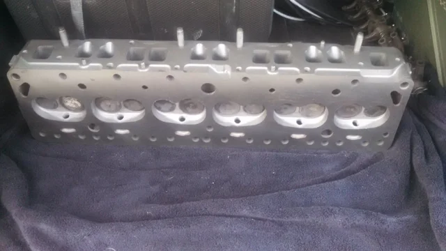

IMG_20161123_155044_545.webp IMG_20161123_155035_363.webp When the head gasket blew, I rented a uhaul car hauler and towed it back to my house. I then fired it up, drove it off the trailer and backed it into the driveway and shut it off. It cranked and ran fine, other than the oil and coolant mixing. I then proceeded to remove the head and other necessary parts to replace the head gasket. I had the head checked for straightness, cleaned, rebuilt, and milled .030. Once I received all of the necessary gaskets and parts, I finished the job. So...correct me if I'm wrong, but if I had compression before I removed the head, then I should have compression after the reinstallation of the head???? Rings and bottom end should be fine (or adequate for 265k miles) and the trouble may lie in the head rebuild??? It seems to turn like it has no spark plugs installed. The only thing that changed was the head. Attached is a couple pics of the rebuilt head.....anything out of the ordinary stick out???

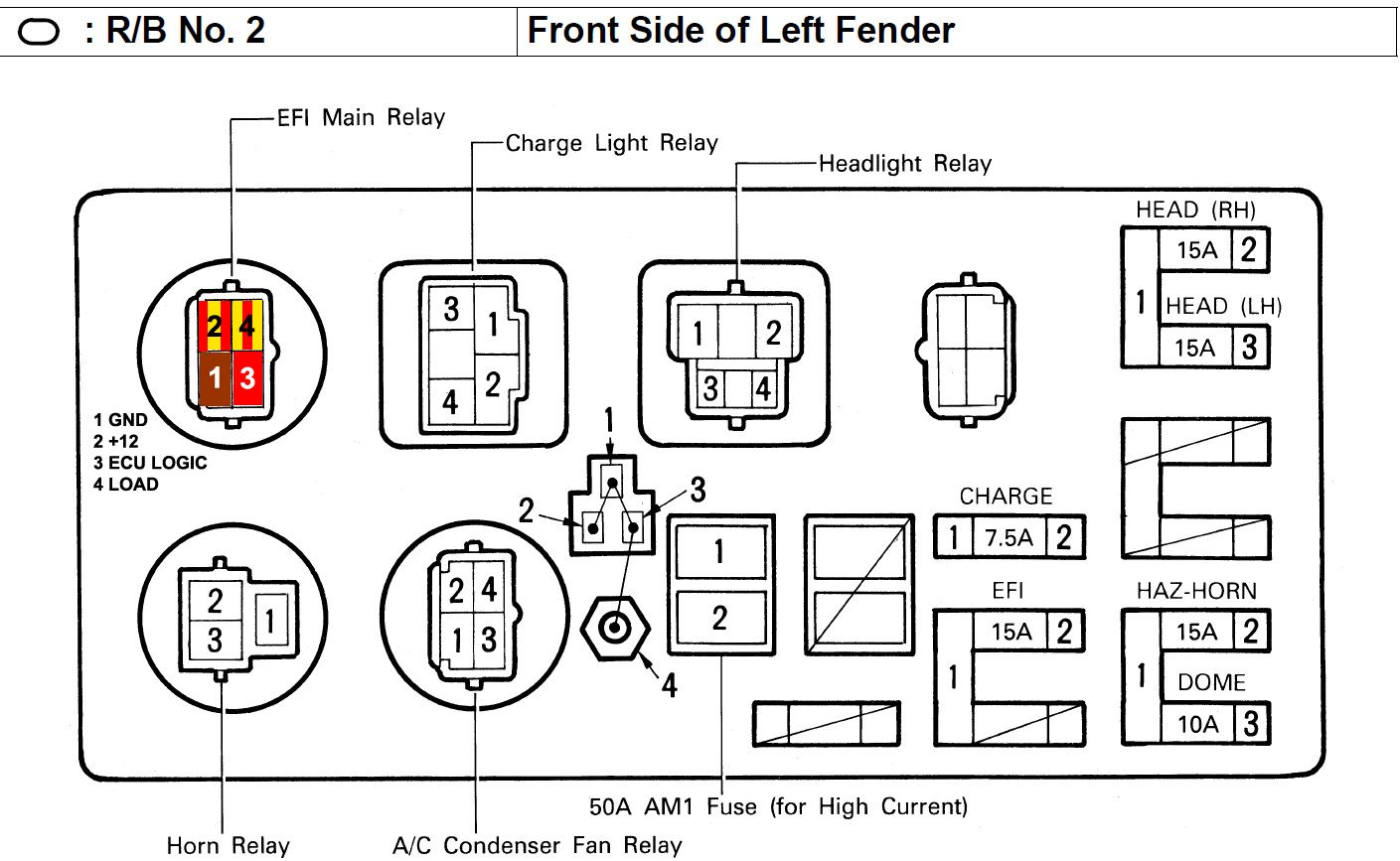

Try unplugging the AFM connection. If the 2 phillips screws on the AFM housing were removed and the internal circuit board was moved, then there is likely a fractured wire. This can prevent the ECU from entering the "ready" state and energizing the EFI relay.
I would make sure that each pin of the EFI relay socket is good. Here is a diagram of the pinout along with the OEM wire colors. Make sure you're getting a good ground on pin 1 (brn). The pin 2 (red/yel)+12 comes from the EFI fuse and should always be present. Pin 3 (red) is the logic signal from the ECU that energizes the relay coil and it should read around +12 or so with the key in the ON position.
You will not get +12 at the diagnostic port until the EFI relay is closed.
