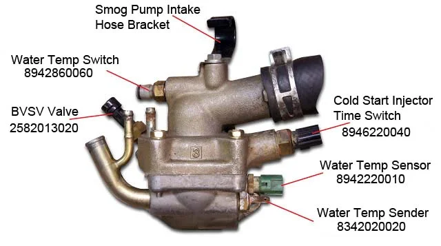

I would check your main coolant temperature sensor and the cold start injector switch. It’s on the thermostat coolant housing.
Those two sensors do a lot. What you’re saying about the CEL staying lit could be related to that.
Be warned. The thermostat housing can become a big mess quickly. All of those bolts and nipples are just waiting to break. Plus the wires will be super brittle.
Be prepared to do it all at once. Upper and lower thermostat housing, thermostat and o rings, bolts and all all the sensors you can afford to do all at once. Plus the connector ends. You can pull all the sensors and check them with a heat source and multi meter but by the time you pull them out, you might as well just do it all at once. Buy once and cry once.
The figure below is from an 80 series with a 3FE but the orientation and layout is the same. Double check the part numbers one by one for your year and month of truck. Several vendors sell complete packages do do this.
Appreciate the reply, comments and picture. Well noted on the "Be warned" It's always the "that looks easy" project that goes to hell.

I too just begun having cold start issues and a Code 22 on my ‘88 FJ62. I bought it 3/22 off BaT, and have not had an issue up until a couple of weeks ago. After reading this forum, I went out today to tinker. I was able to loosen the power steering pump to drop the belt in the way of the sensor. I was able to pull all 3 connections on the left side of the coolant housing. The water temp sensor and connector were corroded. I cleaned all 3 with minor scraping, brass wire toothbrush 😁 and contact cleaner. Used a little Square D connector grease on the contacts and put everything back together as I found it. For the first time in awhile, the FJ fired up normally with no CEL. Thanks all for your knowledge and input to this forum.
