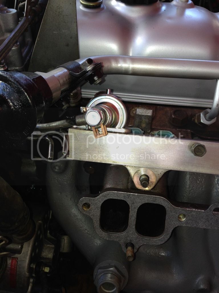

Consider replacing fuel pressure regulator:

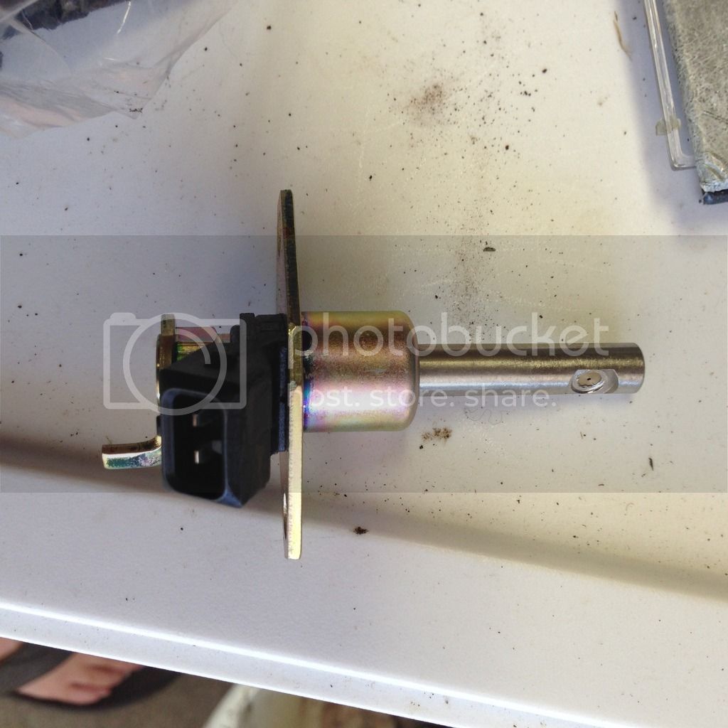

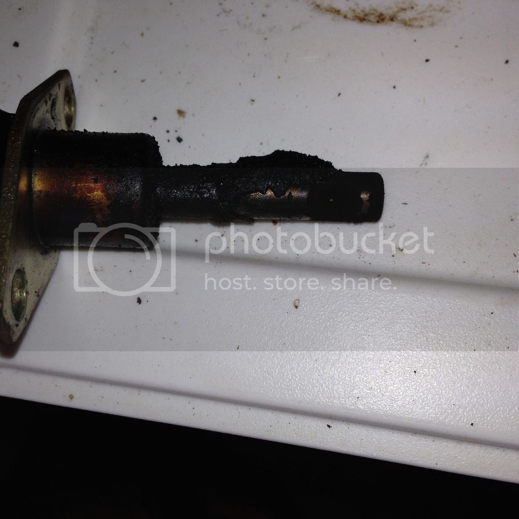

and cold start injector while you are there:
Did you buy OEM Cold Start Injector and Fuel Pressure Regulator? These look awesome, but when I search on SOR, I can only find used and they are still fairly pricey.
I am thinking I would only replace if I could find NOS ( since I believe these are NLA at this point).
