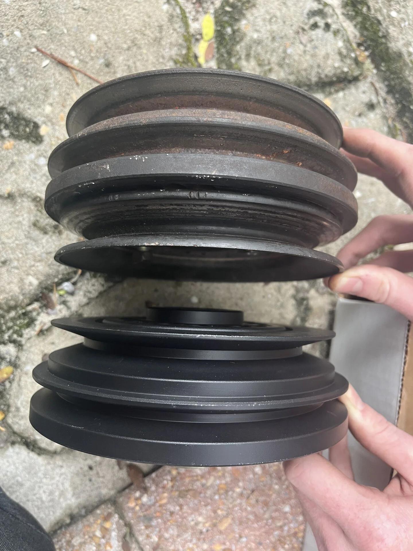

So update, did order the one from Rockauto. Took me a bit to get around to removing the old one, thought I had it all figured out. But tell me if I'm missing something here. The 3FE has 3 belts and this balancer appears to only support 2 belts (along with all the other balancers listed under the 92 on Rockauto). So just FYI, guess I'm still in the market for a balancer or if anyone happens to refurbish them, lemme know.

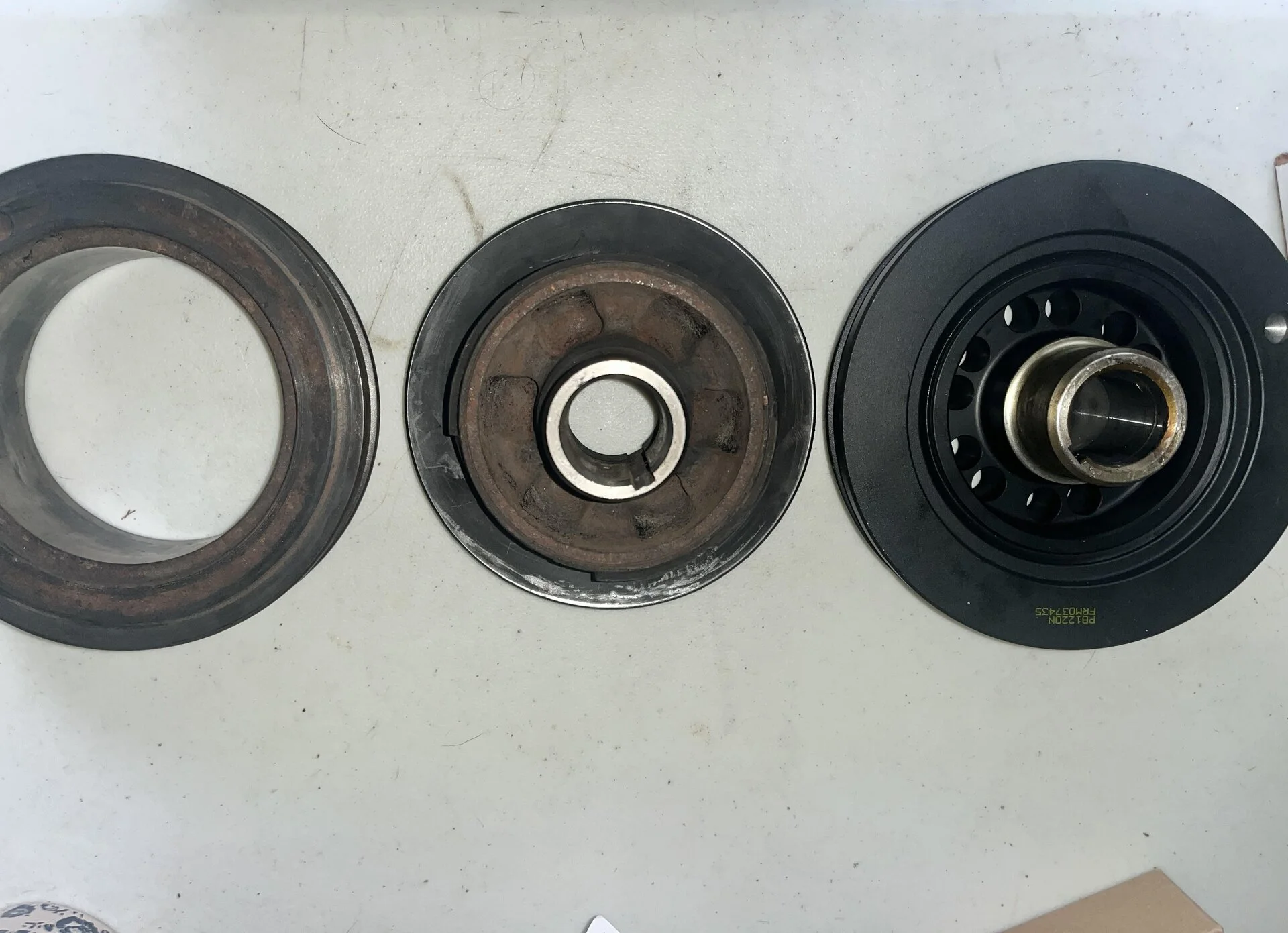

I was thinking the outer pulley is bolted to the main pulley by 6 bolts, will it not switch over?
didn't you need to remove 2 of the bolts to get the puller attached?
That's what I thought originally too. But the outer pulley is not bolted to the main pulley, the main pulley slides onto the outer pulley. The rubber is pretty messed up but the metal is fine, wondering if it's easier and cheaper to refurbish the original balancer.
