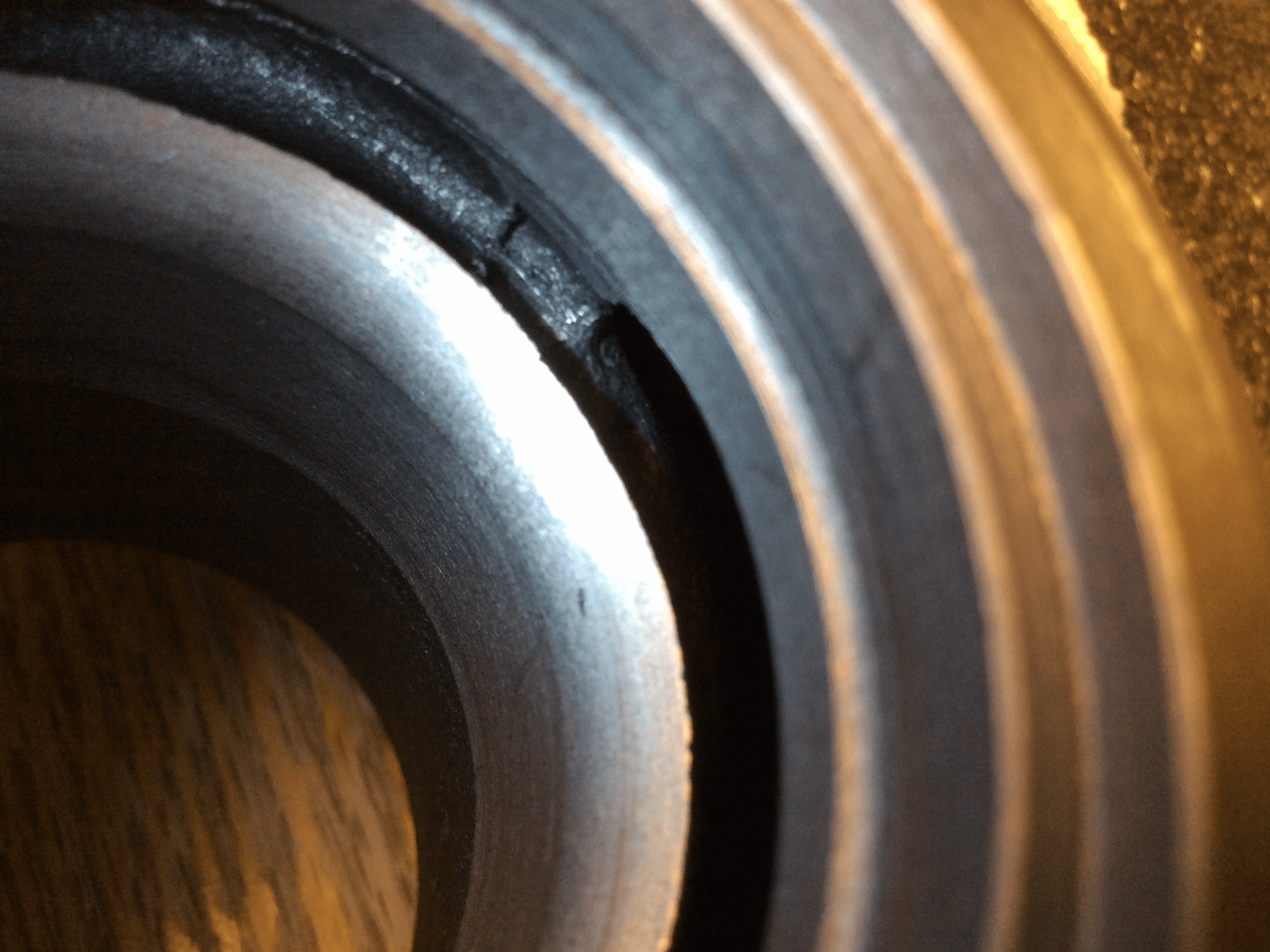

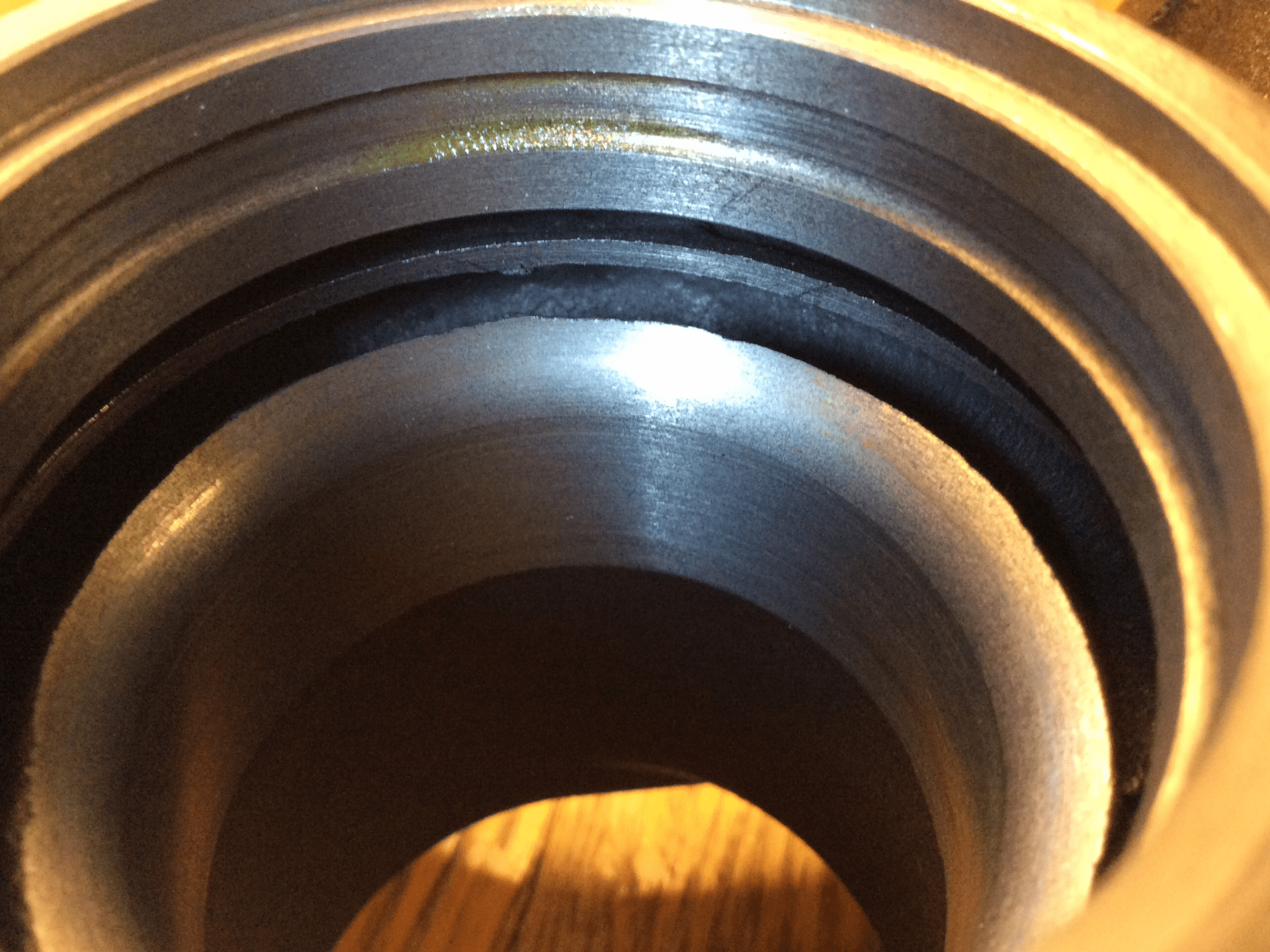

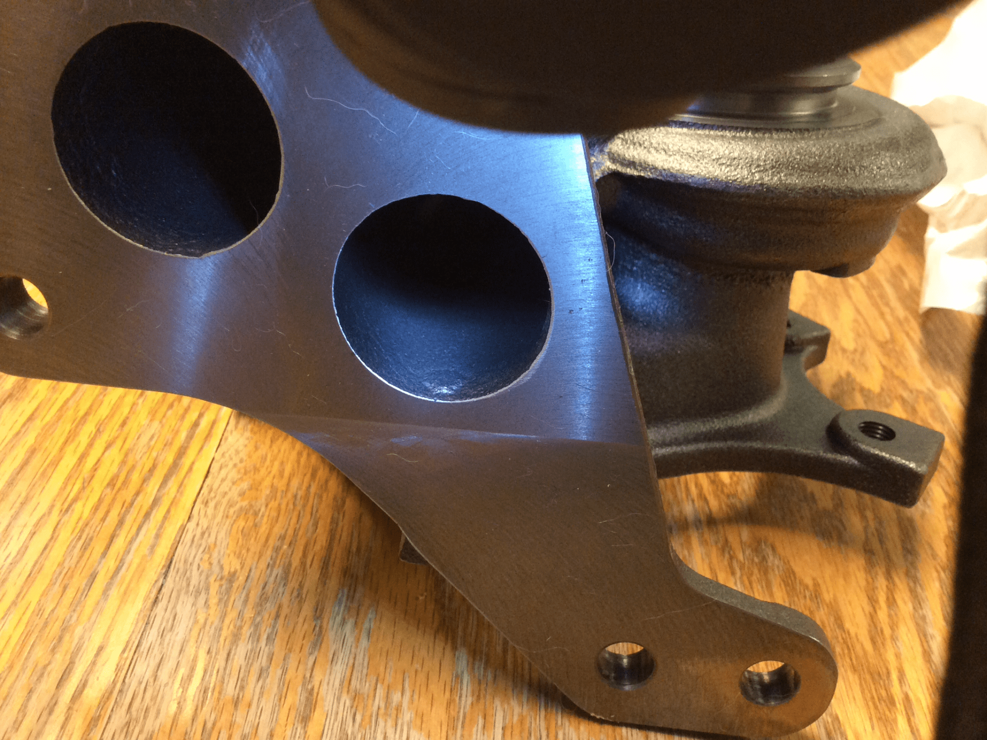

So I ported the wastegate and removed casting that really encroached into the main wastegated gas flow. I have no pics of that, but nothing revolutionary. I do leave a generous 2-2.5mm of overlap for the flapper to seal over as I never want to leak and sacrifice spool. Really easy to get carried away with a die grinder. One problem with tools that do a lot of work quickly is....you can make mistakes quickly. I was happy to note that higher rpm boost vs drive pressure improved considerably after porting the gate which was what I was aiming for as its when the gate is flowing the most gas.
I shouldn't have said I ported the housing but rather removed casting and gasket matched it. Gasket matching is not as easy as one might think and I had to sandwich the mls gasket in between another flange and bolt it together tight or the grinder would have warped it and lead to leaks.
I also oversized the housing reciever ports to eliminate having a mismatched port which can easily happen from the slight play you get from the bolts when you put it into the manifold. You can always cheat fitment a few mm this way and that way. The problem is you have no clue what is and what isn't lining up when you bolt it together. By oversizing the housing ports you will get slightly less effecient flow but will avoid the disasterous flow you get when they are off and a step is created that encroaches into the gas stream. Ok so now a show of hands of all the folks who just said that's probably not happening to my turbo. Guess again. I've never had a turbo that mated perfectly.
The housing had some leftover casting that would decrease gas speed and waste energy. I had to resort to a dremel.....puke....cough.....slow as molasses....arg...I'm dying here...to do the work, but it can fit into small spaces which is a must. It also could vary speed which is nice inside the scroll to control the work. I used a a flex shaft and just bought a 90degree attachment. Tough to fit a tool inside that thing. Thanks mcreight for the tips on the casting. I don't know why, but I've never cleaned up inside a scroll before......maybe cus it sucks! Hah! It's worth it, but it is a painstakingly frustrating job. It's like trying to do a root canal throught the maxillary sinus floor. I mean common. Can't you just extruded hone the nerve out?
