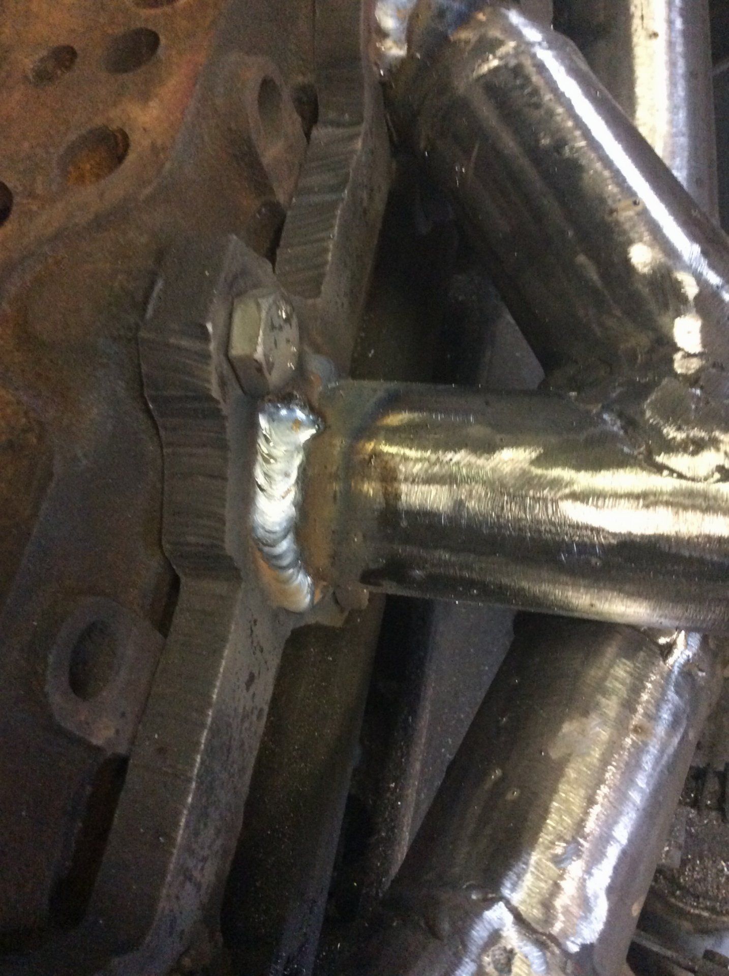

Here the runners are welded individually after mocking the fitment and tacking together. Strangely lateral Y connections are much harder to create than a simple y. I'll see if I can dig up some of my experiments in my bone collection. The true Y is easy, you just chop each 90 in half. Buy a cheapo 12" fixed belt sander with a rotary disk feature and put the heaviest grit paper you can find on it and it makes getting a true tight fit infinitely easier. Take your time fitting and cutting and don't be in a hurry to "get it done" and weld it together. Cutting corners in the welding department suck several orders more in the grinding department.
Always leave room for bolts. This has caught me off guard many times. The 1.25" pipe does not fit naturally to the cylinder head ports so I cut 1" slices down the pipe to flair it to match each port. I weld externally and spend considerable time in all my transitions. It's a great way to destroy flow if your not careful. I use carbide burrs and take my clothes off before I come in the house. Hats are nice. You will take a metal filing shower. Taping a shop vac to the other end of the runner can decrease your miserable life hating grinding experience. Think of it like porting a head for better flow and it makes the slow tedious work less agonizing.

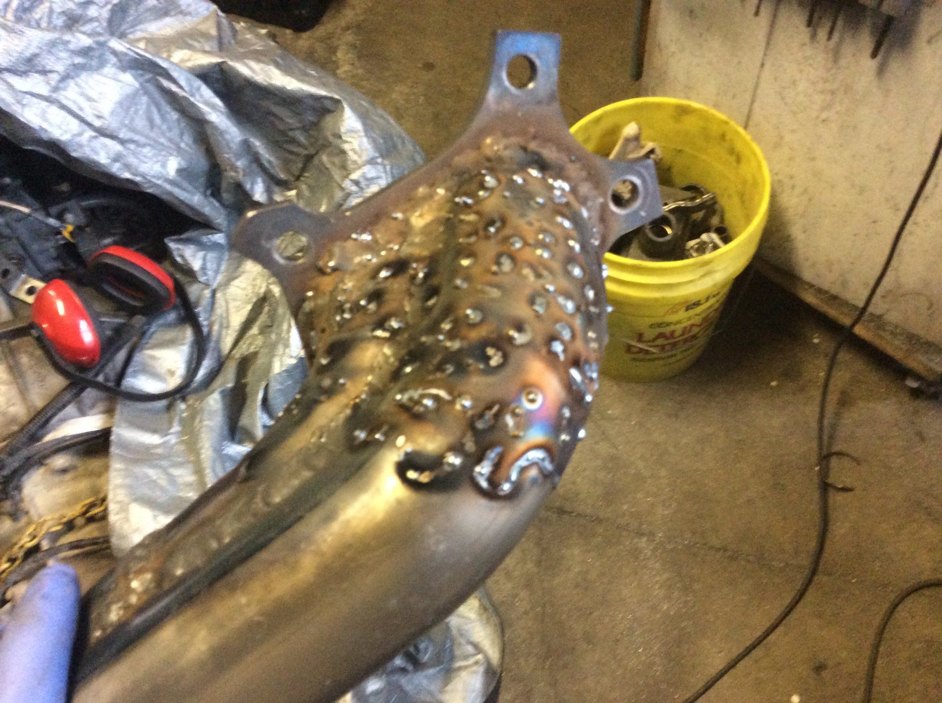

I "texture" all bends with booger welds to help header wrap from slipping. Ive never seen pics of that on the intraweb and my ego likes to tell me I invented it, so out of respect I think we should call it "boogering. I offer that up to the shade tree hord to pervert as they see fit. I double, triple and quadroople header wrap to minimize heat. Header wrap is an investment that pays dividends forever. Excessive Underhood temps is a critical component of the love removal machine that can make you hate your truck.
