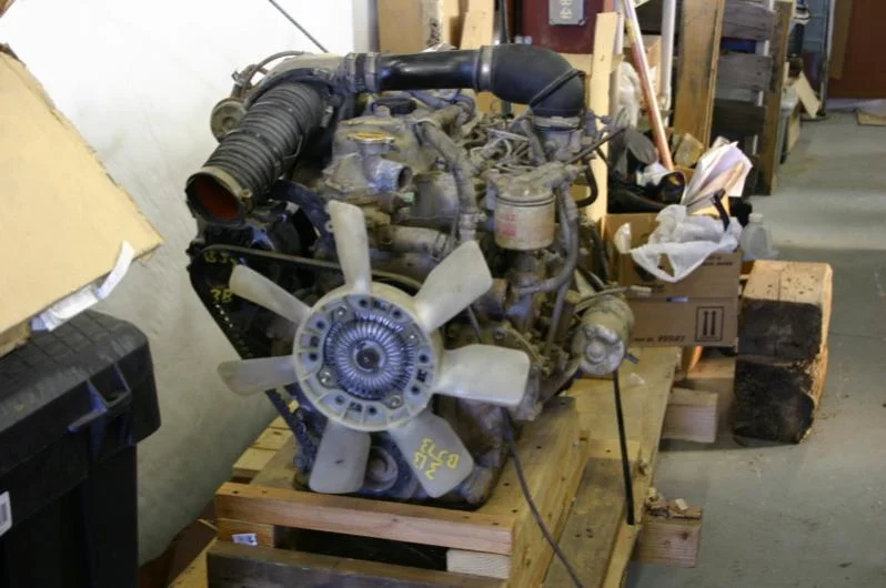

OK, so here's some quick background on "the project..."
My Dad has a 1979 FJ-40 that is very nice, clean, straight, and has a nicely smogged 2F/H42 drivetrain. It's only problem is that it gets the same bad mileage that the F series do, and it burns petroleum. So, Dad bought a 3B/H55f from SOR a little while ago to swap into his 40.
I'm hoping to actually swap the engine/trans/transfer case into the truck perhaps in November (there'll be a real build thread, probably in the 40 section, when that happens).
But in the meantime, I figure why don't I at least make sure the engine runs while it's in the wooden cradle it sits in. It would sure make me feel better about swapping it in knowing that it already runs (and more precisely that I can figure out how to wire it), and it would make me feel better about stripping it down to paint it later.
So basically, it's a 3B (with a Safari turbo already installed) from an Australian BJ-73. Visual inspection shows it to be in decent shape, and I don't really worry about the engines SOR sells. Here it is for a general overview if it helps anyone identify anything in particular on it... engine 1.webpengine 2.webp

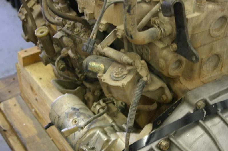

The EDIC on it has four wires. I'm not exactly sure what they do, or what they don't do, so I'm hoping someone has a diagram from the BJ-73 to clear this up. It doesn't seem to match my BJ-40 wiring schematics. edic wiring.webp
More tomorrow. My camera battery died, but I've been busy making cables to run from a battery to the starter, the glow plugs (and a relay to control the GPs), as well as a small control panel to control all of this. All I want to do is start the engine, idle it, and maybe rev it quickly once or twice just to hear it's general health and stuff. I'm not even planning on hooking up a radiator or anything, as it will not be running more than a minute or two if I'm successful.

So, judging by this (and the -40 manual, which includes the BJ wiring, but not that matches this engine) the four wires to the EDIC are probably GND, ON, START, and OIL???
Does the EDIC use the same oil pressure sender, or is there a separate oil pressure switch to worry about? I'd be tempted to leave that system inoperative (since I don't have a problem watching my needle to protect the engine), but it could be useful as a kill switch or just to make it work like it's "supposed" to.
Dan
PS-sent you an e-mail Joe
the edic is simple if you have all the parts. First you need to source a fuel relay for the edic. It requires 3 separate + inputs , Oil presure input and a ground. I believe the wire diag is the same on the 2h also . I refered to mt fsm and the 60 and 75 use the same edic. Cannot post pics as I have it in a pdf not a jpeg file . Sorry
What does the Fuel Control Relay do that the EDIC motor doesn't? I assume it just sorts out a few inputs and then commands the EDIC motor.
I might go see if my HJ-45 has a fuel control relay that will work (as I do have an EDIC) just for grins and giggles.
Dan

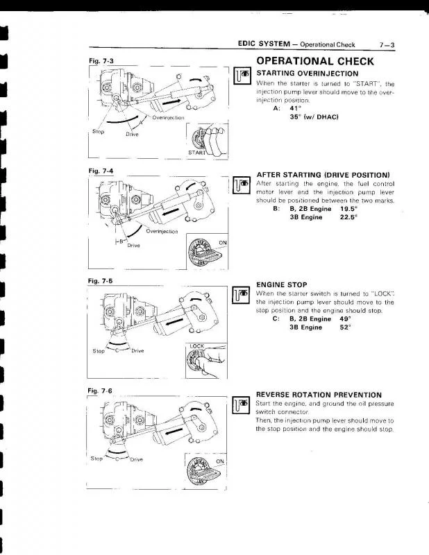

OK, so from the stuff Joe sent me (thanks again!) it appears that the fuel control relay basically does some pretty simple things...
1)Commands the EDIC motor to turn ON when it needs to move
2)Forwards the signal to the EDIC as to the selected position
3)Turns the EDIC motor OFF when it reaches the selected position
4)Cuts the fuel off if the oil pressure drops
I'm going to head up to the shop now to go see if the HJ-45 uses the same system, because I might just have a fuel control relay that I can use to test all this out....
But in the long run it looks like I need to get my hands on a fuel control relay for this, plus the plugs for the EDIC motor and the fuel control relay (well, I could do without the EDIC motor plug, but it would be nice). I think it's time to call up $OR or some Canuckian cruiser shops... ;)
Dan

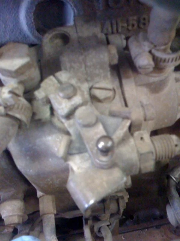

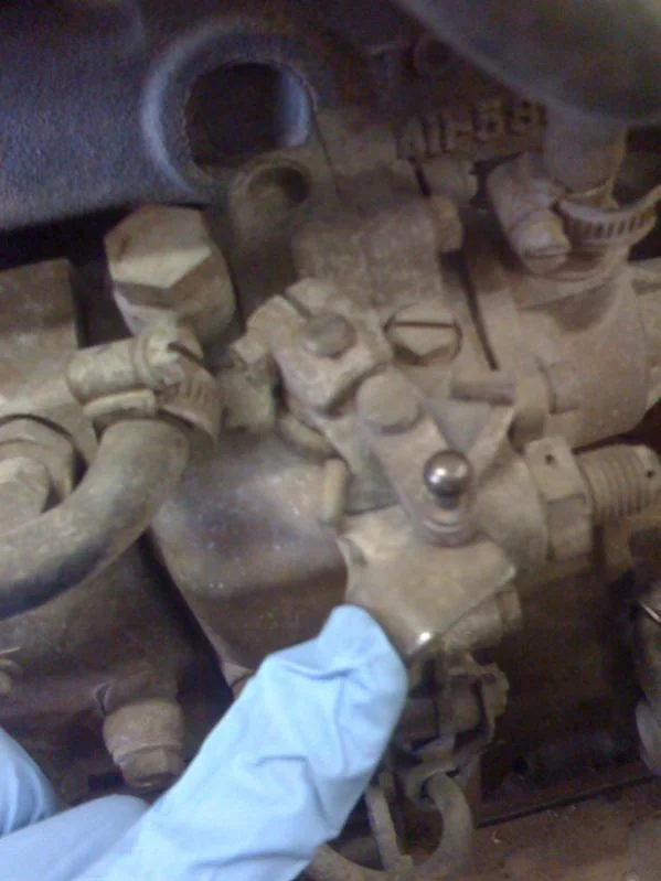

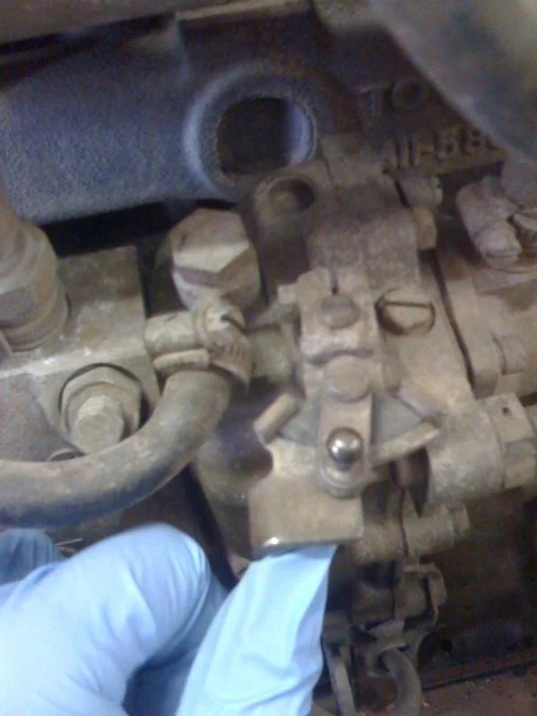

OK, while the fuel control relay I need is in the process of being procured (28590-56090), I'm going to try to run it without the EDIC, just me moving the lever with my hand.
But before I go make a lot of noise (and potentially screw stuff up) I want to make sure I've got the positions correct....
Overinject (for starting)
attachment.php
Run
attachment.php
Stop
attachment.php
It appears that the overinject position is pushing on a plunger of some sort when it is pulled back, and it is spring loaded to the "run" position. You have to actually push against a spring to either stop the engine or overinject for starting.
Is that making sense? If it is, then hopefully it'll be clattering later tonight. ;)
If everything goes wrong, then just covering the intake fully should cause it to shut off right? I'm sure I could pull the fuel line off, so it couldn't get new fuel, but I'm sure it would run on the fuel in the filter for a very long time (my hilux half cut ran for 10+ minutes on the fuel in the filter).
Dan
