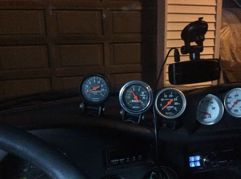

Thought I'd post up a sort of crappy video of the recent changes I've done with the set up. Changed the small turbos compressor from the 13c it had to an extended tip 13t and swapped out the large turbos compressor from a 50 trim to a 60 trim. Egts are down and boost is up. Builds a bit slower in the lower rpms, but pulls much better above 1800rpm. Redid the exhaust so bends are smooth and removed the glass pack as it's quite quiet anyway with just straight pipe. Added a snorkel. With max fuel it burns clean with 10lbs boost at 1500rpm and 30lbs at 2800rpm, egts have gotten up to 1150f on long hills after 15min of WOT.

Hard to see in the video, but the gauges on the left part of the dash are egt (left), large turbo 20lb gauge (middle) and total boost 35lb gauge (right). Egts max at 1050f during the drive, large turbo max boost 15lbs and small bumps it up to 30lbs total.
