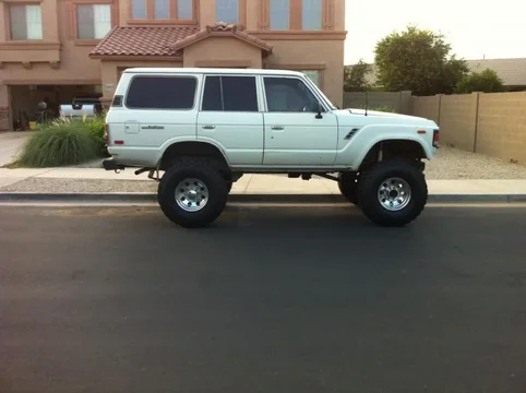

Here's the way mine sits right now. What do you guys think can I go larger without having to alter anything?
Im a tad jealous of how it is now. 39.5s may barely fit? If you've got big tire buds, see if you can try some on. You also may need some longer shocks.
Good luck
and yes I plan on removing those stickers when I get back home.
wow, another tall boy. turn your wheels lock to lock, how close to the leaves/frame are you? If you can stuff those I'm sure 40s will fit with minor trimming of the fender. If it were me I'd lower it and roll the 37s.
Good luck
if the shocks cycle with the suspension now, you're fine.
tire size will never dictate shock length, 28" pizza cutters or 52" Michelins length will stay the same.

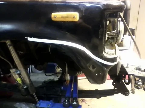

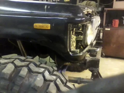

I just trimmed my front fenders to fit 43's with my SOA.
I moved my front axle forward a few inches too, so I didn't need to trim the back of the fenders.
Here was the line I followed.
Finished result:
Finished result:
Nice lines stevo!
